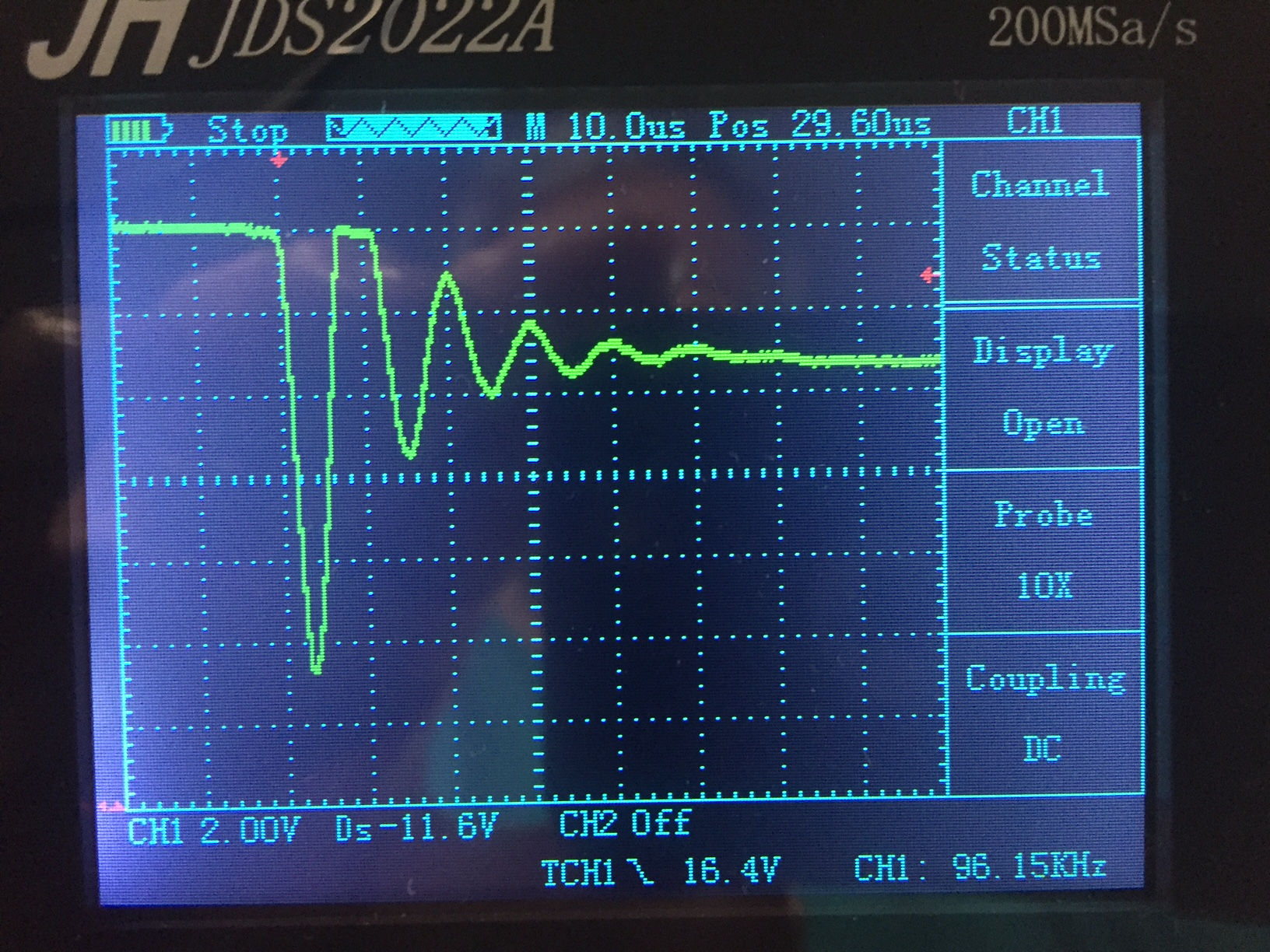

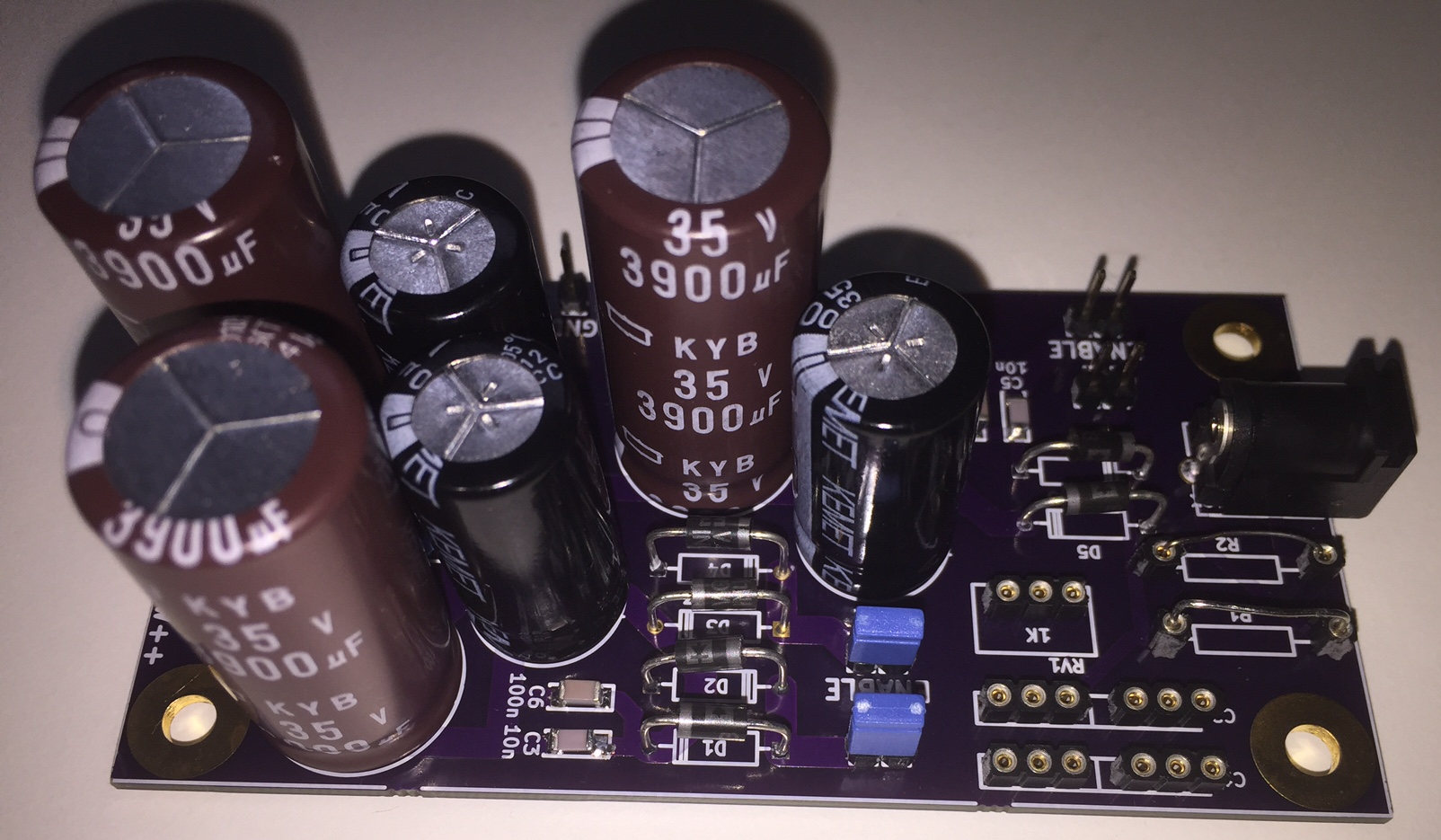

I built up my test board which implements the AC-to-DC power supply found in both the Vendetta Research "transient perfect crossover" and also the NWAVguy's O2 Headphone Amplifier. John Curl refers to the circuit as a Voltage Doubler; a single non-center-tapped transformer secondary produces both +Vdc and -Vdc through a pair of half wave rectifiers. Schematic below; see middle third and lower third.
Then I powered it up and began testing it with my brand new JinHan JDS2022A battery powered oscilloscope. This scope has the tremendous advantage that it's completely floating; it has no connection to earth ground. So it can display the waveform of the voltage difference between arbitrary node A and arbitrary node B, while disregarding "ground". Very nice for probing around the rectifier diodes of a transformer-diode-capacitor-regulator power supply.
My findings were:
My findings were:
1. Although you can display the current waveform of the diode, by viewing the voltage across a small valued series resistor (see R1 and R2 in the attached schematic) ... you actually don't want to do this. When the diode shuts off and exhibits non-soft-recovery, its current is near zero (duh). So the behavior of interest is a small fuzzy pimple at the base of a very large current pulse, and it's noisy & low resolution on the scope display.
2. Instead, what you want to do is display the waveform of the voltage across the transformer secondary. Which is easy: just attach the probes! Then you trigger on the spike-down just as the secondary voltage begins to fall from its peak, and Wallah! That's the diode induced secondary ringing. See image 2 below.
3. The 1N4003 is indeed a terrible diode. When driven by the 15VAC wall wart from the O2 headphone amplifier, the first half cycle of its oscillatory ringing is 11 volts tall! Yuck. I personally would lavish care and attention and an extra fifty cents worth of components on the problem, and kill this mosquito with two different bazookas: (a) implement a CRC snubber across the secondary; (b) rip out the 1N4003s and replace them with SBYV27-200 soft recovery diodes. But hey that's just me.

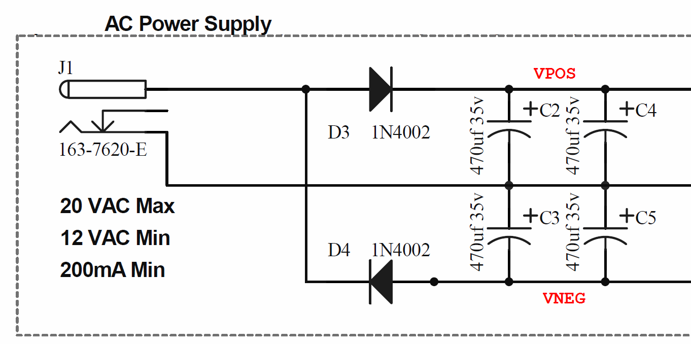

Hi Mark J,
Your power supply circuit isn't designed properly to begin with! No wonder you need special diodes! Tell me, is there anything else you can think of doing to decrease conduction angle, then stand back and complain further about the performance of an otherwise good rectifier diode in a lousy circuit?
What voltages and currents are actually being delivered here? I'll assume (maybe ill advised with this) that this mess is followed by some regulators trying to isolate all that unnecessary ringing from the end circuit. Have you measured the actual peak currents flowing through that poor rectifier diode?
There is one fact that seems to be forgotten when people design this fad driven type of power supply. Regulators have falling performance with frequency, but have no problem at all with low frequencies. By opting for a very short conduction angle, you have pushed much of the noise into very high frequency regions where normal series regulators do not perform well. Why? You are fighting the laws of physics when doing this.
If your end use circuit is supposed to be high quality (not even SOTA), I can't understand why the power supply has been designed with such constraints as this one has. The short conduction angle redefines the requirement of the rectifier to the fast switching type, so even if you persist in designing these supplies this way, you haven't spec'd the rectifier properly. The "corrective measures" you employed would have been part of the normal design had it been done properly.
I'm sorry if I came across strongly, but you are hinting that in the normal use, the 1N4003 is a poor performer. In fact, this is an unusual circuit design that demands a fast rectifier capable of higher current peaks, and mitigation for the inevitable high current spikes created by this design.
A normal circuit that uses 1N400x diodes performs quite well, and using "better" (faster and soft recovery) really doesn't benefit the normal circuit at all.
You are right about measuring the current across a small resistor. The resistor helps to lower the peak current pulses, giving you a low reading even if you manage to get a meaningful reading that way. You can measure across the secondaries, but it would be helpful to use a current probe to see the actual peak currents involved. Of course, those current probes are quite expensive. Still, this is the only way to see the real current waveform. What it would show is the ridiculous amount of current demanded over a very short time interval. That kind of pulse will (of course) excite all reactances in that circuit. Hence all the ringing.

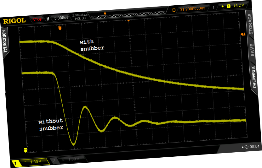

One idea, attributed to Jim Hagerman (author of an influential paper on snubbers), was to perform the measurement differentially: Use two scope probes and a special scope plug-in diff amp module like the Tektronix 7A22. But Jan Didden didn't like the idea of making room on his bench for an enormous "boatanker" and others objected to its very high price. Other people suggested disconnecting the scope from earth ground using a cheater plug, and then connecting the scope probe's ground clip wherever you damn well please. I suggested that a battery powered scope could probably make the measurements, since it is inherently floating: it has no connection to earth ground. So I taped out the test board and ordered a low cost (USD 115) battery powered scope.
It is true that the test board has no explicit series impedance between the rectifier and the bulk filter capacitor. There's no inductor and no resistor to smear out the current pulse, so the diode conduction angle is low. This is also true in the O2 headphone amp PSU below, and the Vendetta Research "transient perfect crossover". Indeed it is true of 99% of all solid state audio equipment that uses a linear power supply with a transformer and solid state rectifiers. Check Bob Cordell's power amp book Figure 16.1 (68,000uF connected directly to the rectifiers) or Douglas Self's Figure 26.19 (10,000uF connected directly to the rectifiers). For line level supplies check Self's SSAD book Figure 25.1: 4700uF connected directly to the rectifiers. Like it or not, low conduction angle is the overwhelming favorite design approach.
Fortunately the cure is 100% effective and very inexpensive: fit a snubber. If desired, also fit a soft recovery diode. Before and after photos are shown in the Linear Audio article here, I copied one of them (Figure 8) below.
added later: I guess I should mention that I connected 150 ohm, 20 watt load resistors to the test board's DC outputs. The cheapo transformer sagged under load, so the output voltage was about 19.5VDC and the power delivered was about 2.5 watts. This (slightly) increases the diode conduction angle.

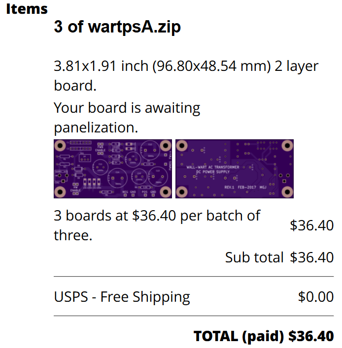

Here are the Gerber files for the PCB in zip archive format; please feel free to build one or more boards and make all the measurements you desire. The file name extensions are set to OSH Park's standard; if you need a different set of file extensions (e.g. for Elecrow or seeed or some other PCB fab), just let me know. I will run a simple MSDOS .BAT file that executes the REName command once for each PCB layer.
OSH Park ships boards in multiples of 3 copies. This will give you the opportunity to stuff three boards with three different choices of capacitor values and experiment with conduction angle.

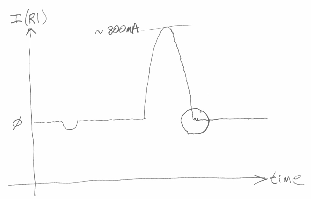

When you do start displaying current waveforms you'll see something like my pencil drawing below. Big current pulse when recharging HW+ which is loaded by 150R. Small downward current pulse when recharging HW- which is loaded by 6.8Kohms. The not-soft-recovery ringing is within the circled region and is very low amplitude compared to the peak of the current wave. Getting your display instrument to zoom-in upon the little wiggles inside the circle, is not going to be easy. BTW in my testing, I found that R1 = (1/3)*(secondary DC resistance) gave the best display. Smaller than that, the amplitude was severely degraded. Larger than that, the current sense resistor began to affect the Q of the resonant circuit. But maybe your setup with your choices of capacitance, will require different resistance values. Try it and see!
_
