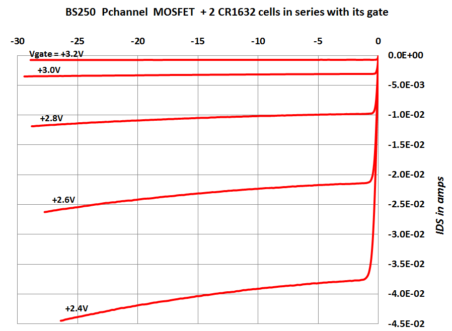

What the world needs is a P-channel depletion-mode power-mosfet
I made a mockup using an enhanement mode Pchannel MOSFET. To stay within the modest current limitations of my curve tracer I used a small signal MOSFET, but since gate current is negligible, the same approach will work on a high power MOSFET with no additional modifications.
This assemblage created a depletion mode PMOS whose pinchoff voltage is about +3.4V; we see it is just barely conducting at +3.2V. Remember that enhancement mode PMOS devices have a gate turnon threshold voltage which is a negative number; BS250's datasheet says (-3.5v < Vth < -1.0v).
With a photovoltaic isolator and potentiometer you could literally dial up whatever pinchoff voltage you wanted.

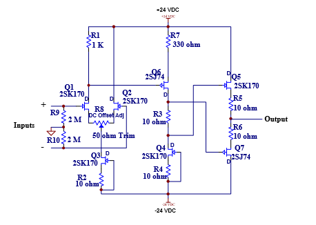

A full array of complementary enhancement and depletion mode mosfets would be ideal. Apparently, like audio optimized IC op amps, there just is not enough market for depletion mode mosfets to make it worthwhile. I was asked what I wanted (about 40 years ago) by a Siliconix engineer and I said just that, BUT to no avail.
Actually, depletion mode is more difficult to bias (normally) except for making current sources, and this was brought out by the introduction of Vfets in the 1970's. I made an amp out of them, but biasing was difficult for the output stage. Vfets had another problem, low output resistance or Mu, so even complementary output stages were VERY sensitive to power supply voltage regulation.
With a photovoltaic isolator and potentiometer you could literally dial up whatever threshold voltage you wanted: enhancement mode, depletion mode, or zero threshold. (We used those to great advantage in HMOS-I on 3 inch wafers). You could even shell out for 25 turn trimmers and get matched VT's for minimum offset.
I used this type of bias with comp jfet outputs, but with power mosfet's the tempco's of the output devices might force adding diodes to temp track.

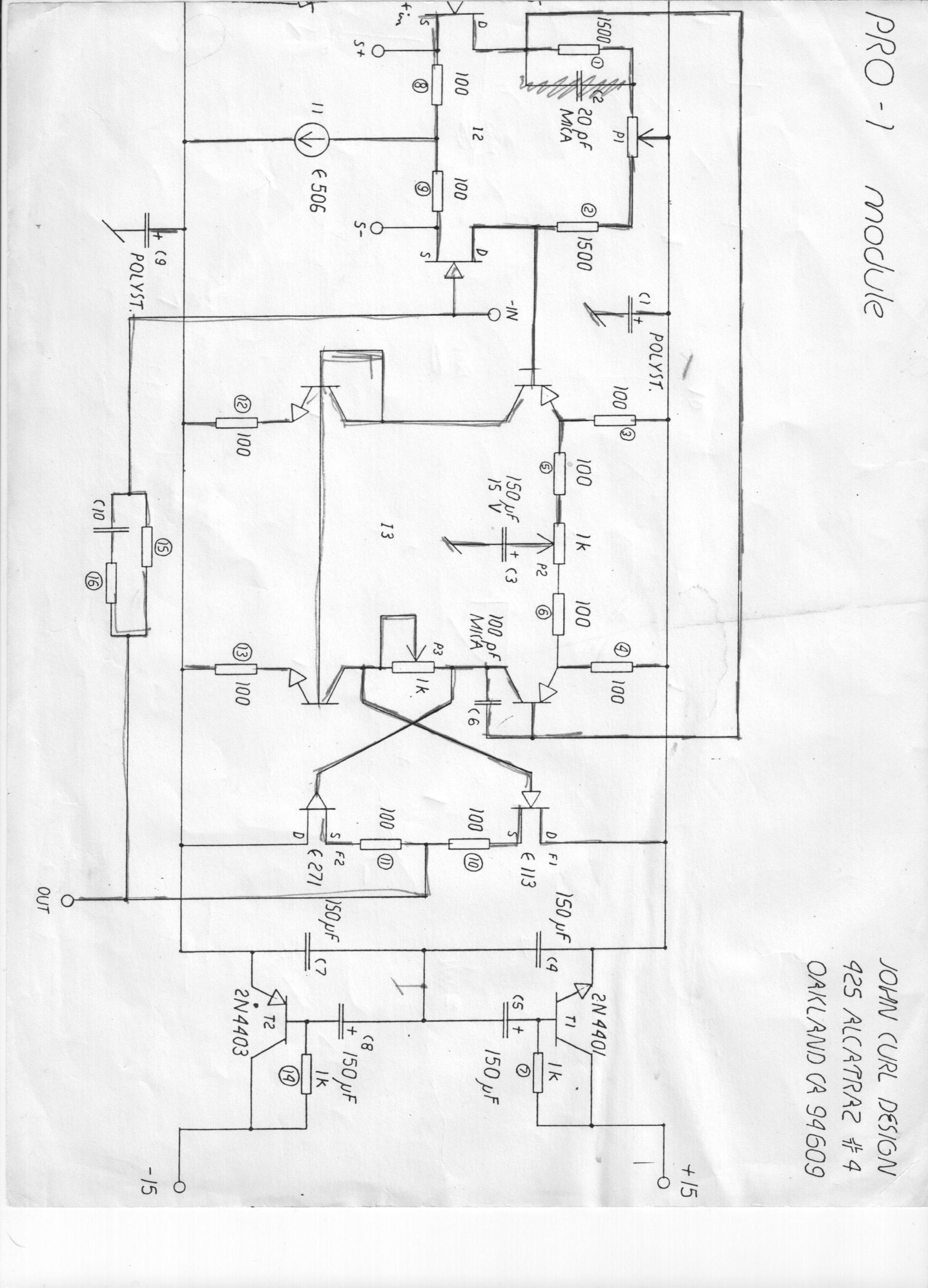

Here is an example that I used for studio boards, and master tape recorders:
