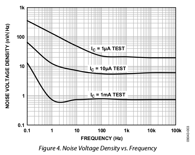

I was looking at the relatively new LT6018 this evening, and wonder what is the secret behind the very low LF noise.
Also seems that no one is using it for audio, yet......
http://cds.linear.com/docs/en/datasheet/6018f.pdf
I just looked at the MAT12 / SSM2212 which seems to be the same chip.
Where does that funny notch at the 1/f corner come from?
Is that physics or just curve fitting gone hiwire?
Those would be chart tape rolling or when an old layout was reshot the tape had lifted and someone who knew no better just pushed it back down.
This happened to me on an IC, a piece of rubylith fell of and 10 lots were trashed before we noticed.

😕 I mean, coming from high frequencies, the noise density curve
first dives down to 600 pV/rtHz at 2 Hz before it rises steeper than 1/f below 1 Hz.
(the 1 mA trace)
The folks that roll the chart tape are not EE's. 😀 This was before CAD you remember, the hot wax sticking the paste up together. The other side is that now real scope photos are banned because nothing but computers are used (halftoning considered too much bother).
