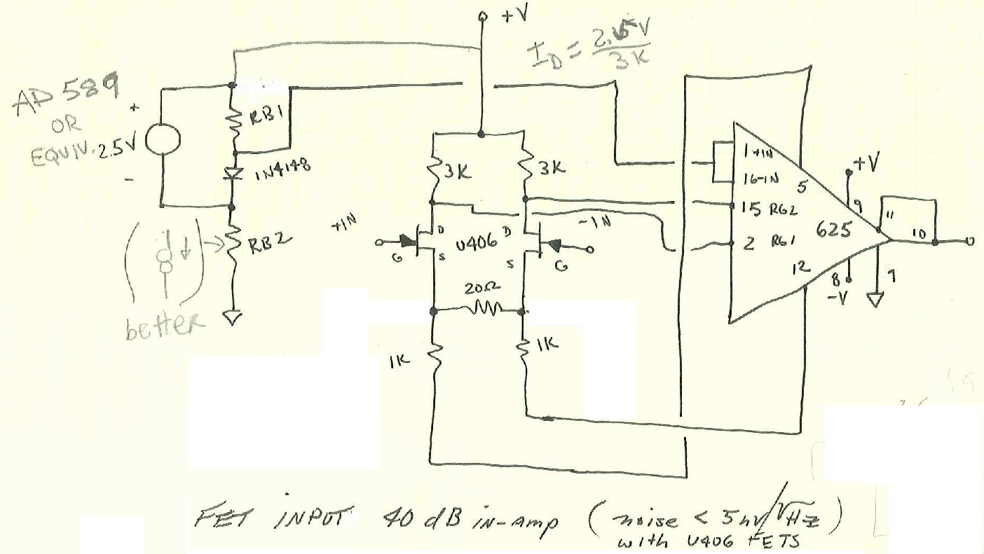

Here George, it was >25yr. ago and I scratched this out for the folks at The Naval Labs in Maryland. I "think" I built it but can't recall exactly. The bias stuff on the left is non-critical, you just want a cascode voltage that also gets the right drain currents for the FET's.
A really good circuit, Scott. Personally, I think the the AD625 was one of your finest design efforts. Still, what is the final slew rate? Yet, with a 389 in the front end, this would be quiet enough for serious work.
Slew rate stays the same as the data sheet. This was for listening to enemy subs and maybe whales. Yes one or two pairs could get close to 1.5nV or so maybe 1nV at G = 1000.
