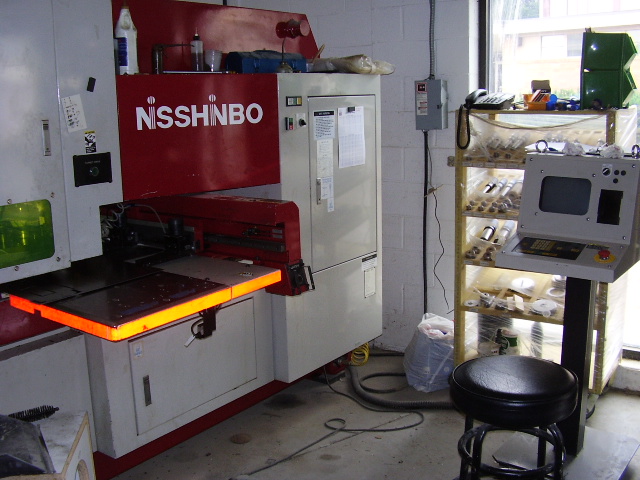

OK here is some of what I have in my metal shop...
Just one more useful tool. I do have a rule that is one must spend more on the material run through the tool than on the tool or it is not really worth it.
But to make a case like what was shown requires just a milling machine. Available used for under $2,000.00. (The cool thing about such tools is you can often resell them for what you paid or even more.) Well within some budgets. Others will have a local variant of a "Tech Shop" and can use tools by the hour.
You can get a 3 axis CNC mill for under $2k used? That could be a great money spinner in some markets.
Getting a shop to make a handful of high finish parts is not that easy. Its actually really hard or expensive or both. Few shops are interested in tying up the machinery for one or two sets of parts with a large radius curve on one surface. I suspect that front panel was an extrusion. Cutting from a solid panel is time consuming and needs help to make it smooth. The Constellation stuff which is all CNC from solid blocks is very time consuming to make. The case is probably 1/2 of the total cost of a Constellation product.

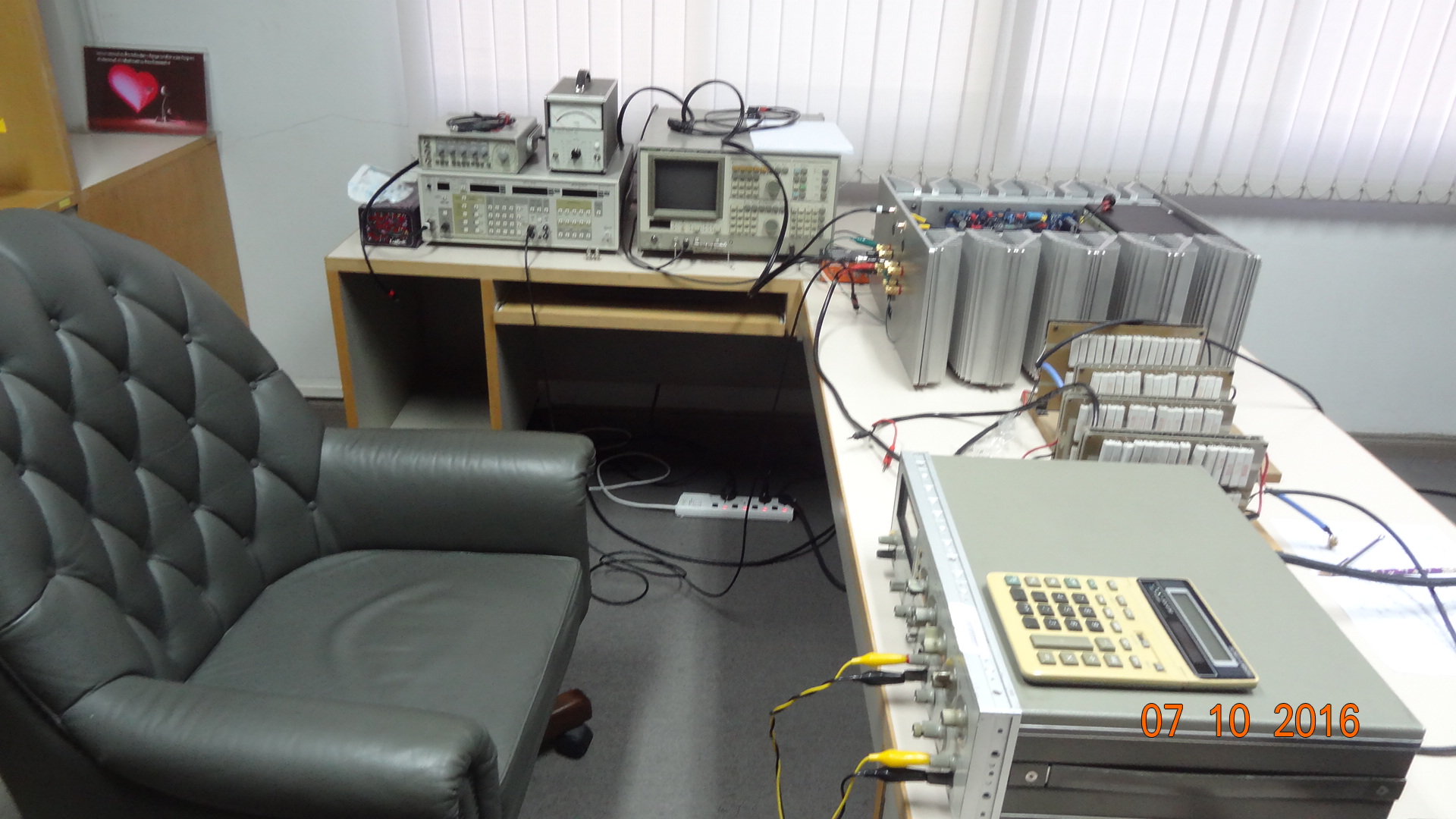

The amp looks great.
Kudos to Damir for the ‘motor’
One of your next tasks would be building a proper dummy load for high power amp testing.
The dummy load shown in the picture isn’t up to the task, not for test with continuous signal at the power levels you mention.
For brief, pulse testing, maybe.
Have you monitored the R change (collectively and at each branch) due to heating from current flow?

I did a check collectively at the 2 Ohm level... no significant R change... maybe 0.1 Ohm.
I can also test with dummy speaker RLC network. Mostly interested in thd characteristics under load R changes. No need for precision measurements. THD up to clipping and monitoring output stage current into load.
Did some tests at 5 and 10KHz also. ETC.
tried three different distortion analyzers. also monitored the 230v ac line input to amp during testing. checked temp rise inside and out with IR thermal temp probe.
