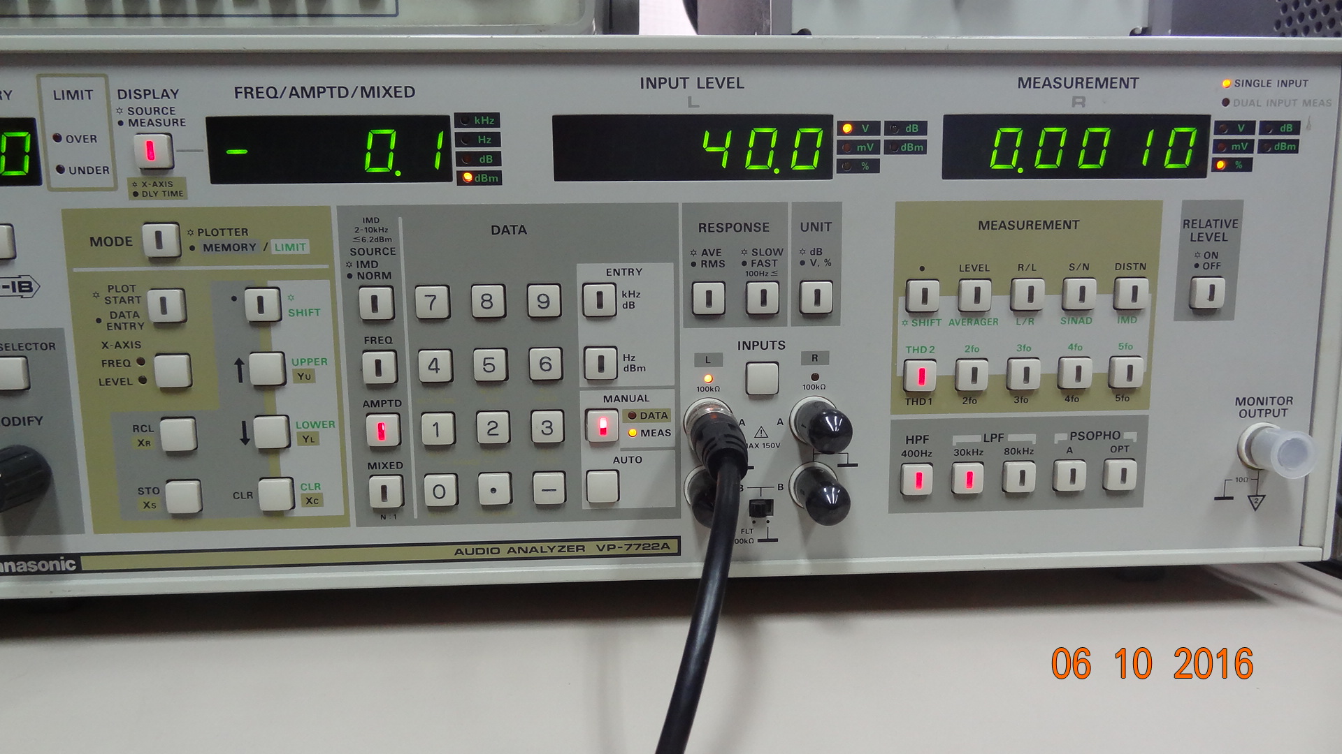

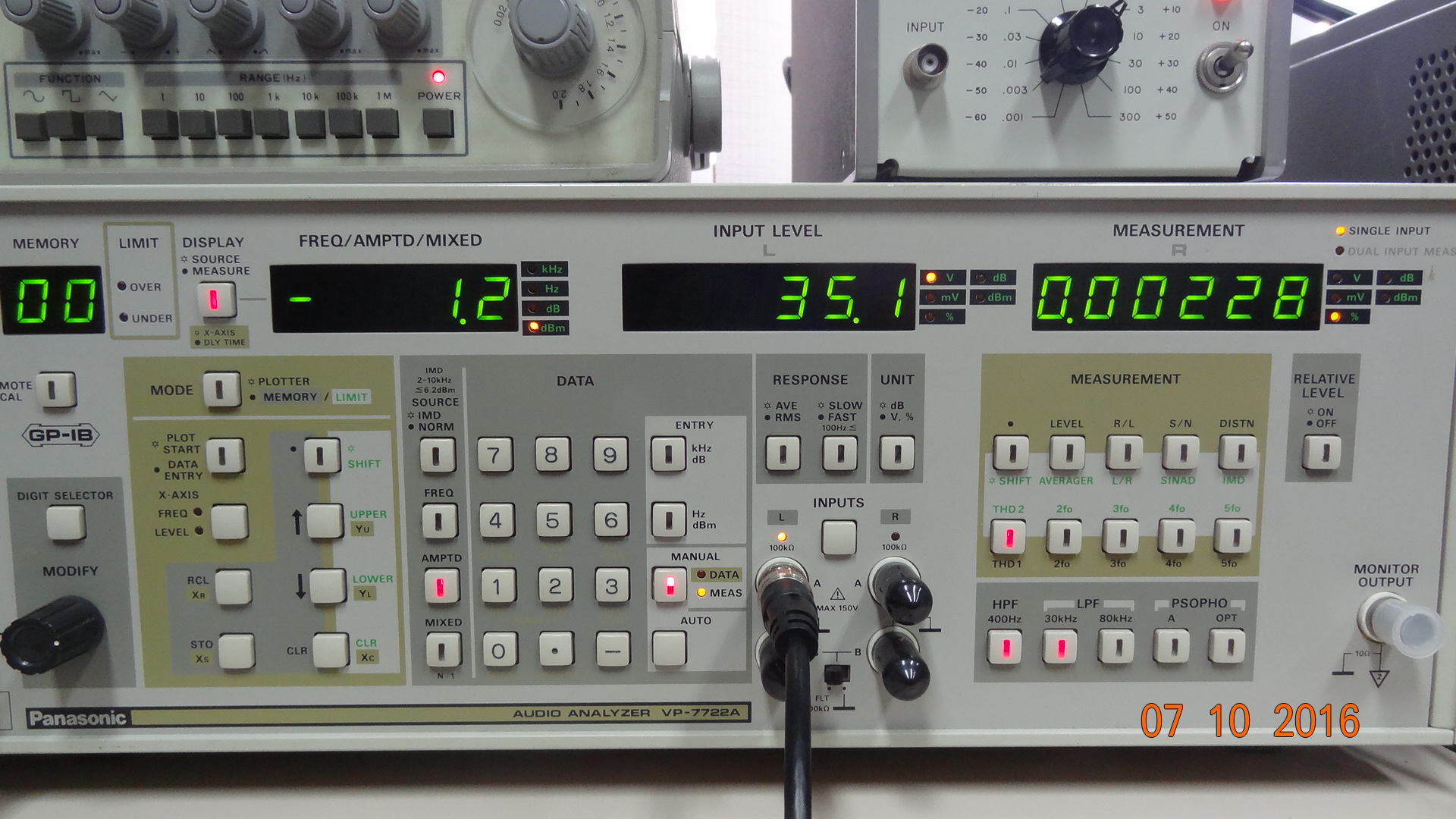

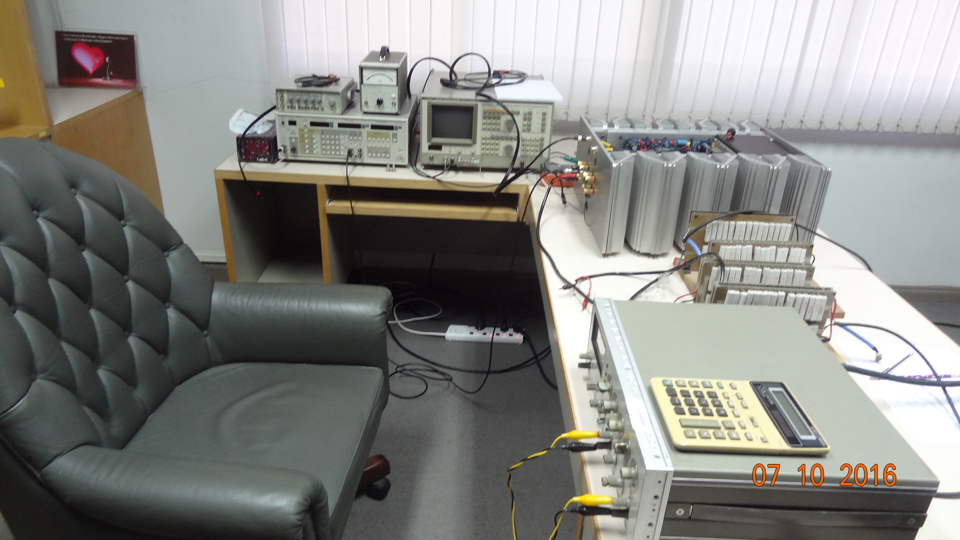

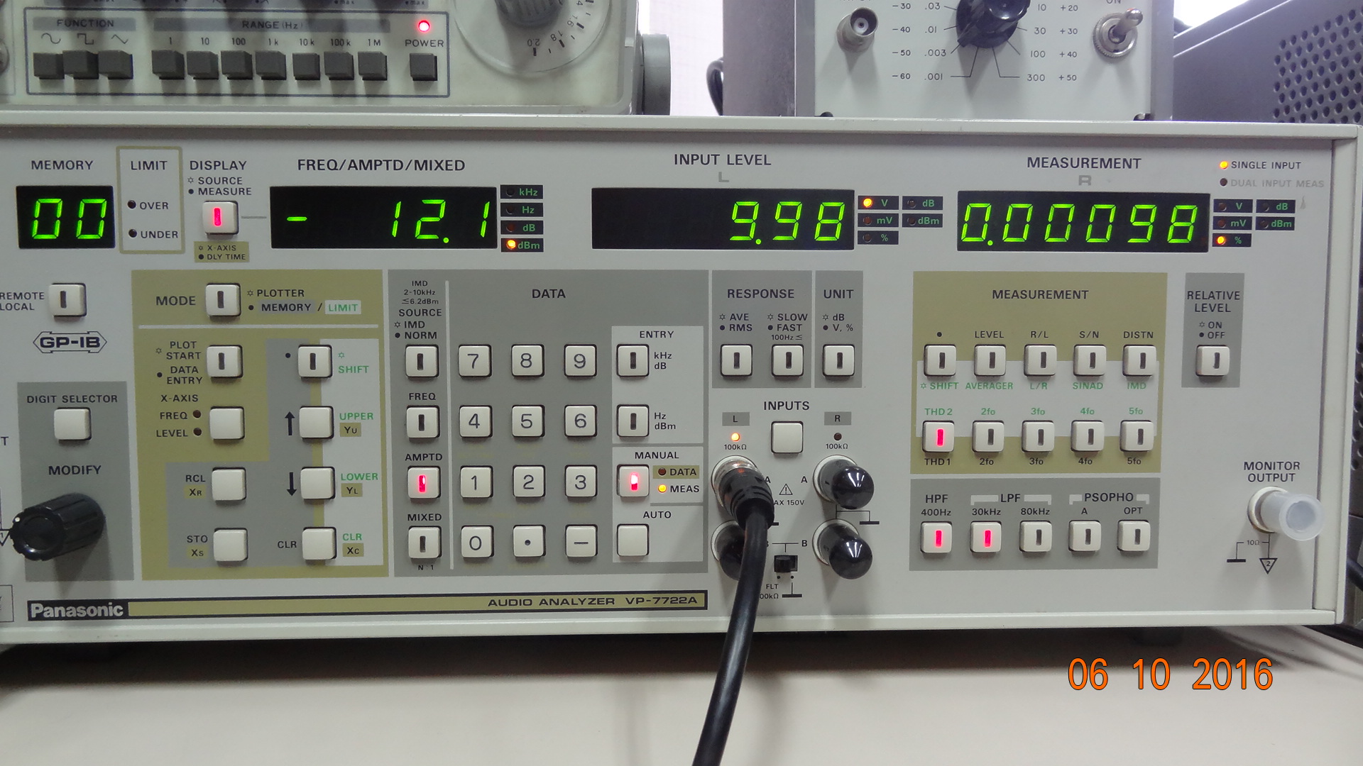

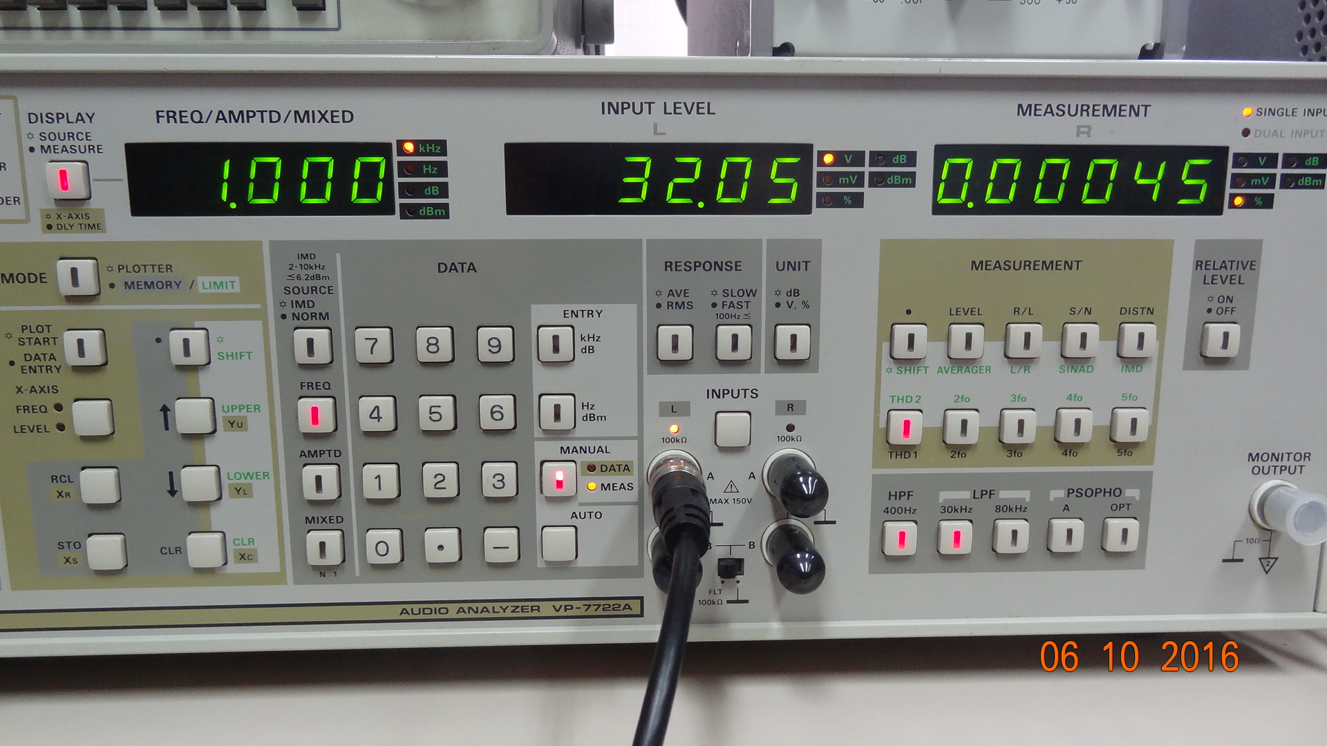

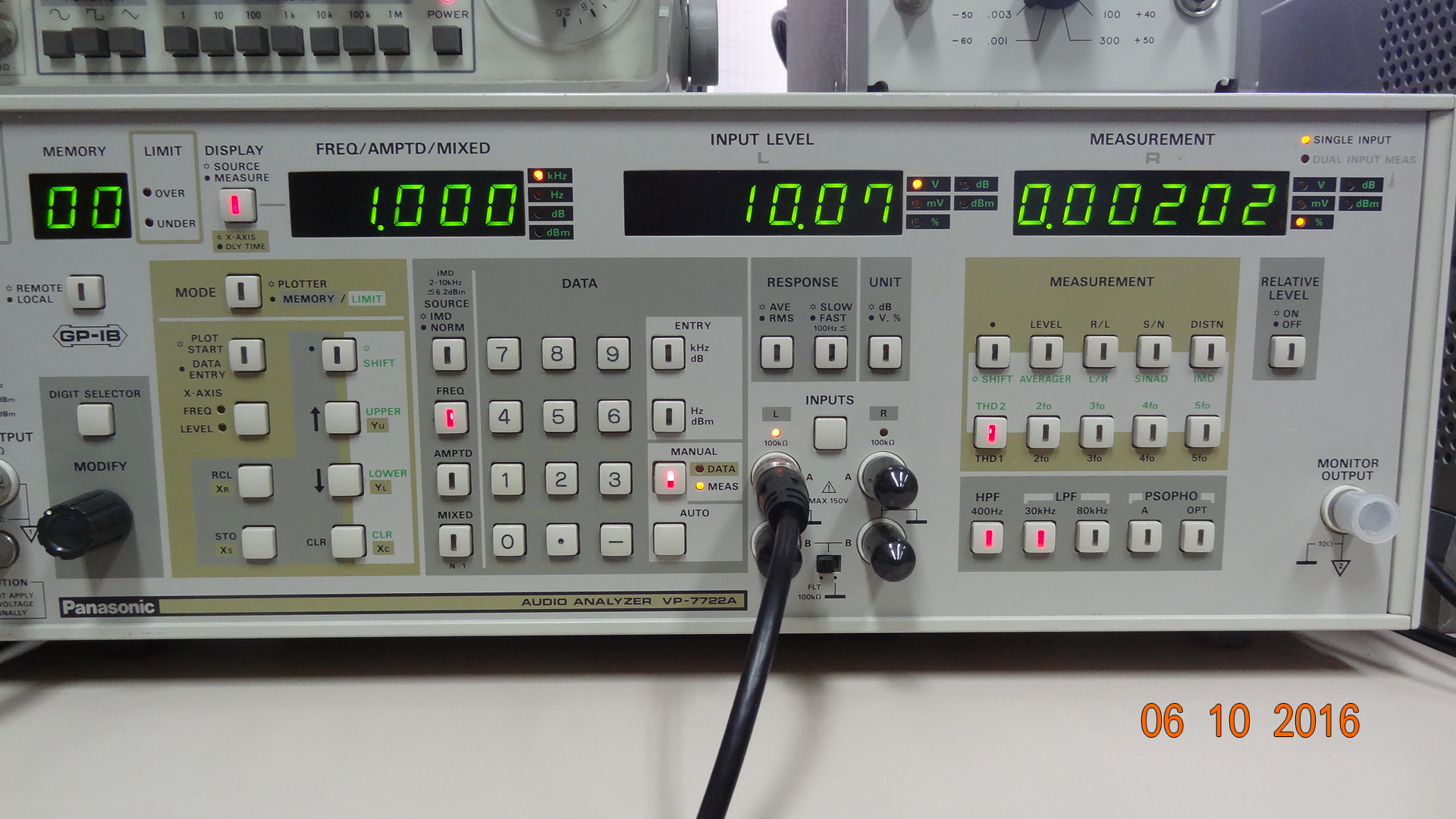

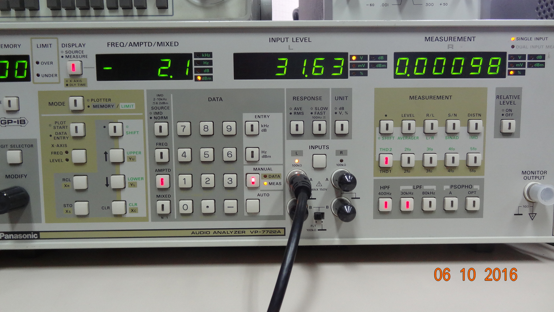

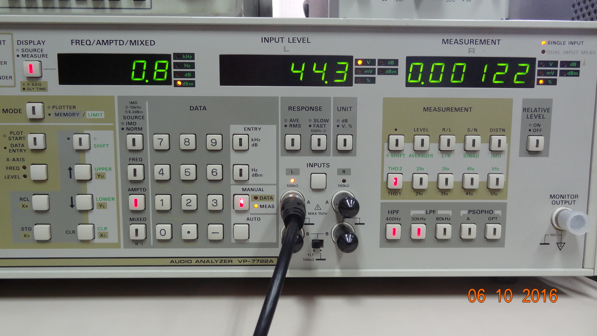

I just got back from The Office and tested a sample CFA originated by Damir.
JC.... yes, I think it is more than SR but aligned with the fact that the distortion doesn't rise within audio BW as most typical of high gnfb VFA will do. Talking power amps here. The constant distortion with freq and power and load is very impressive to measure, let alone hear. No dynamic changes. Rock solid and pin-point imaging.
Here are a few of many tests done today to illustrate the small variances --- 2, 4 and 8 Ohms.
2 and 4 Ohms
2 Ohms ! >600W
8 Ohms
same with freq... very low and little change.
The above is in all cases 2H only. 3H is <-110dB

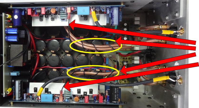

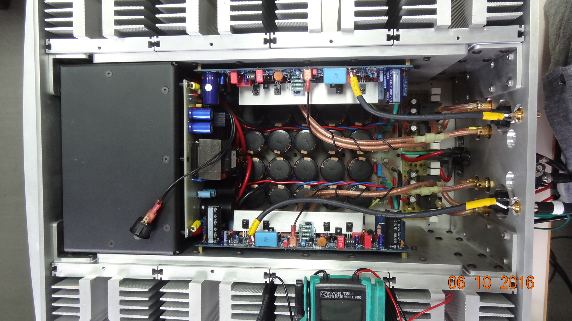

RE: Richards new amp
Very nice!
More internal photos, please.
I'd really like to see/hear about the construction details that help get those impressive measurements.
mlloyd1
Very nice!
mlloyd1
My new amp
THx-RNMarsh
That's fantastic Richard - built like the proverbial out house - that's going to be around for many years!

This is signal ground. Strange, why is going around output wires??
Damir
That was my question.This is signal ground. Strange, why is going around output wires??
Damir
