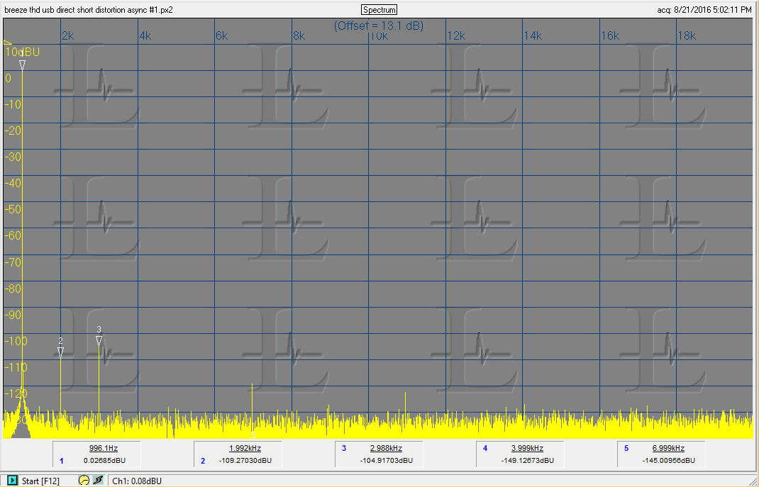

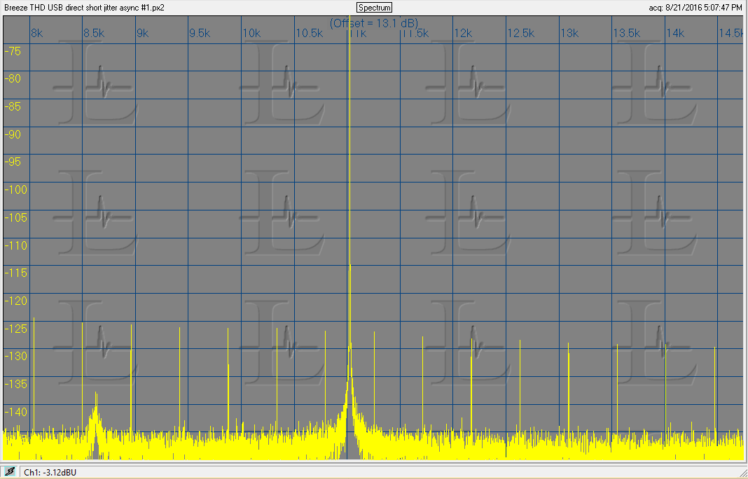

You do not need to spend much to get SOTA USB DAC performance. These measurements are from a $60 USB DAC Xmos U8 DAC AK4490 Top Asynchronous USB Decoder Support Headphone Output | eBay With two mods- a 12V DC supply and swapped the socketed opamp for an LME49720. Not much of a challenge.
More could be had if someone wanted to make new firmware to support additional features supported by the AK4490.
(Both at 44.1 KHz sample rate and the distortion is possibly limited by the Emu 1616M.)
