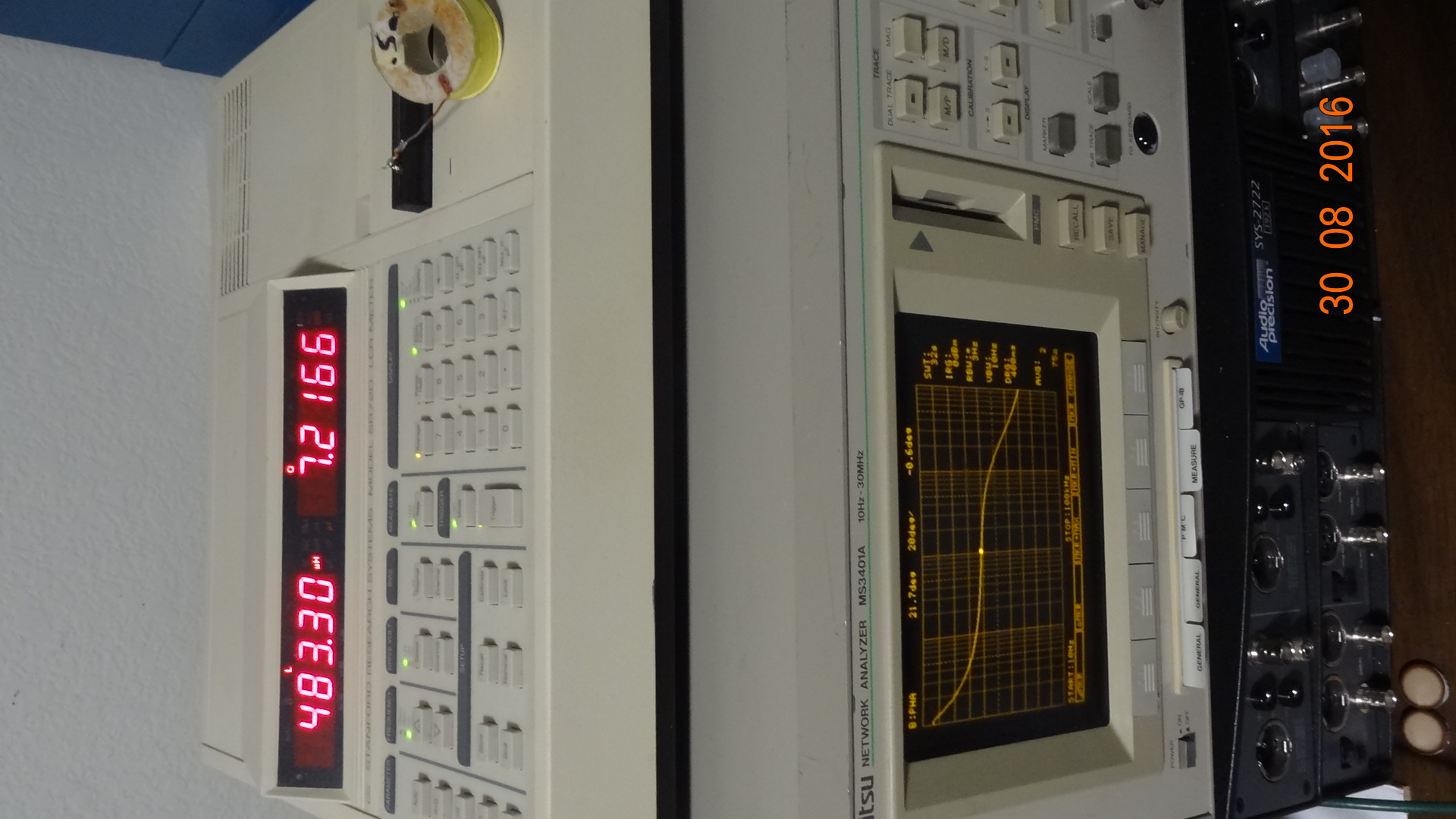

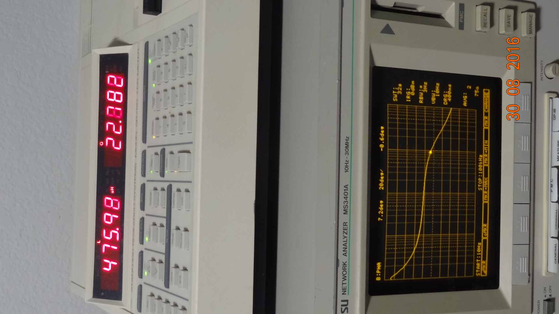

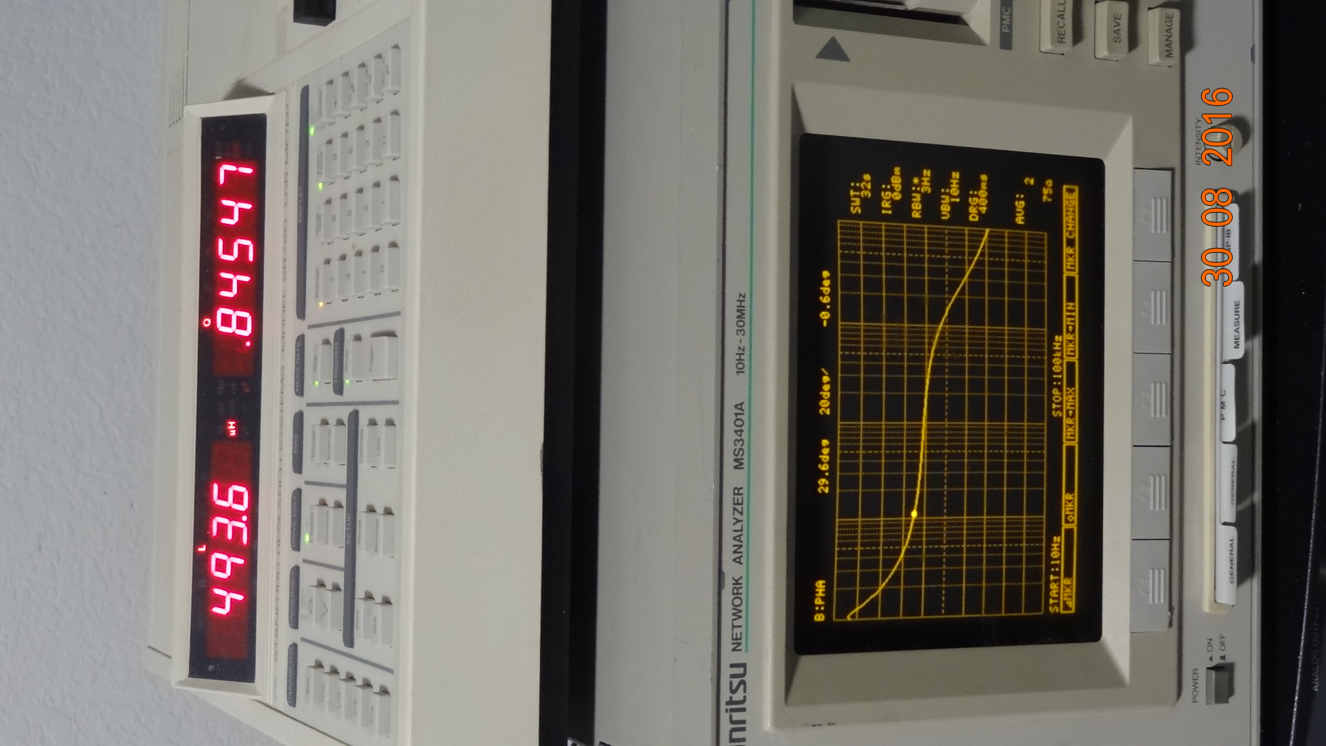

In attempts to use SIM and build a passive x-over, the same issue applies as with semiconductor SIMulated circuits. If the parts are not characterized well, you get bad results no matter what the SIM indicates.
An air core inductor, for example, is hard to get 90 degree ideal phase from it over a wide freq range or at least 2 octaves either side of the x-over freq.
Here is some data on a 0.5mH air core inductor pulled from a loudspeaker system. Very typical of all air core values sold for x-over use which I have measured. ---> at 100Hz, 1KHz, and 10KHz. L+Q on top istrument and graph of its phase vs freq below.
8.8 Ohm load.
THx-RNMarsh
8.8 Ohm load.
THx-RNMarsh
