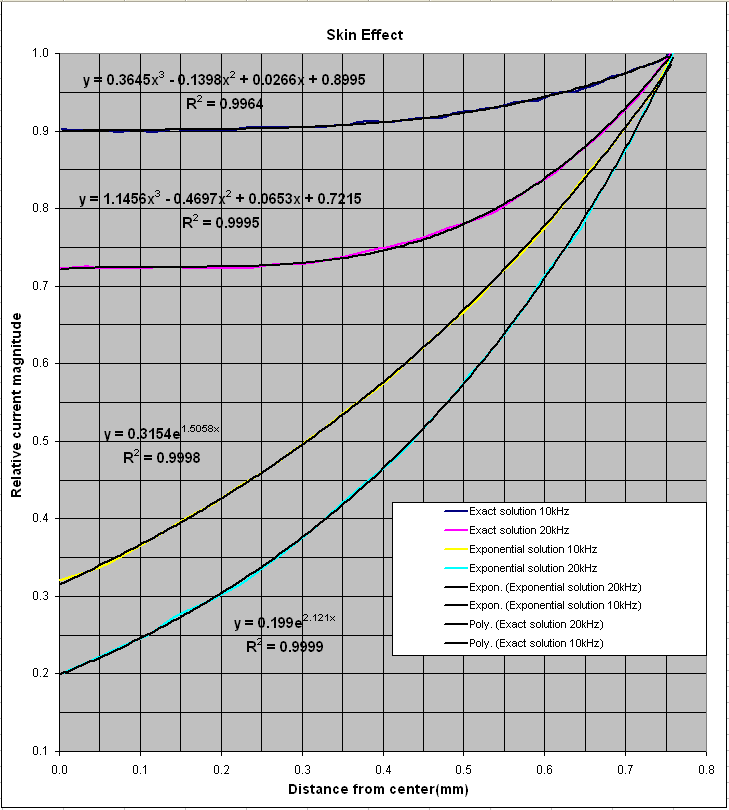

Every wire is a transmission line. It's just that it can often be neglected, just as with any other simplified model. If the more complete model gives a different answer than the simplified model...
I had a jpeg that described the difference between bessels and exponential, I'll find it..
Edit: here ya go..it's for a 1.5mm diameter wire.
Thanks John
The exact solution predict much less skinning effect than the exponential solution.
I digitized your attached diagram.
I imported the data into Excel.
I drew the diagram there, together with the trend lines (a good fit).
The lines equations maybe of use to analytical minds.
P.S. If you can find some more such diagrams with different wire diameters and/or frequencies, please post them
