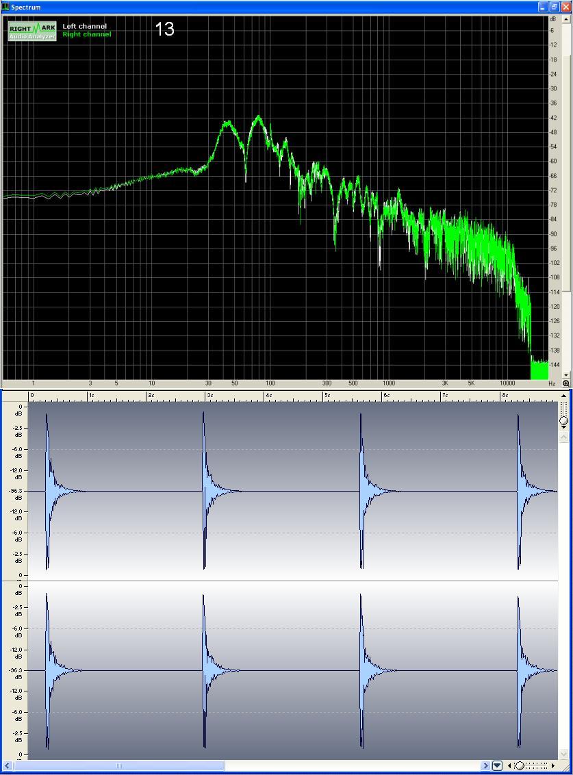

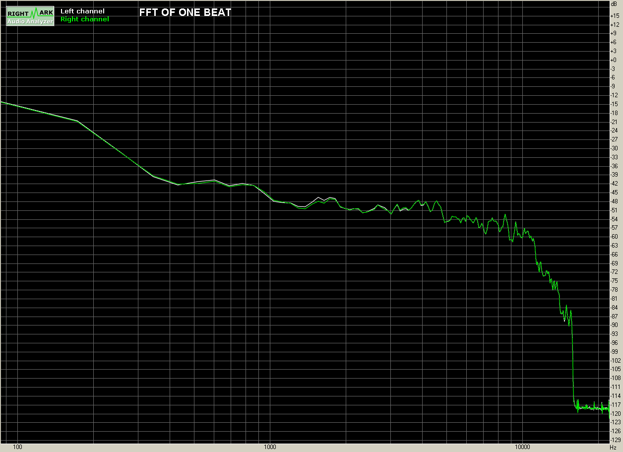

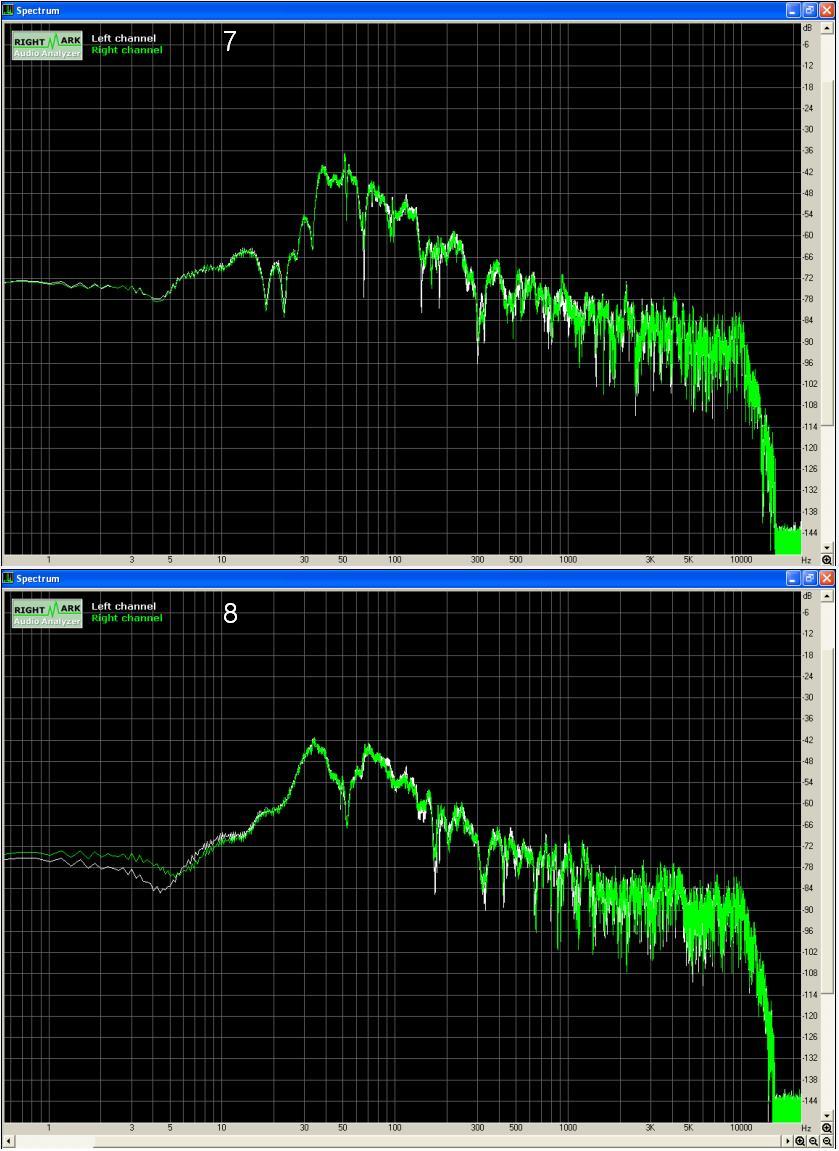

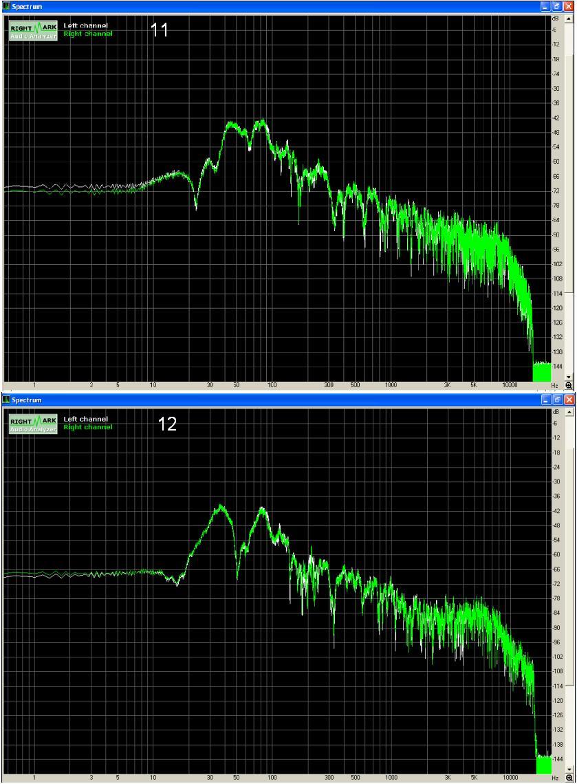

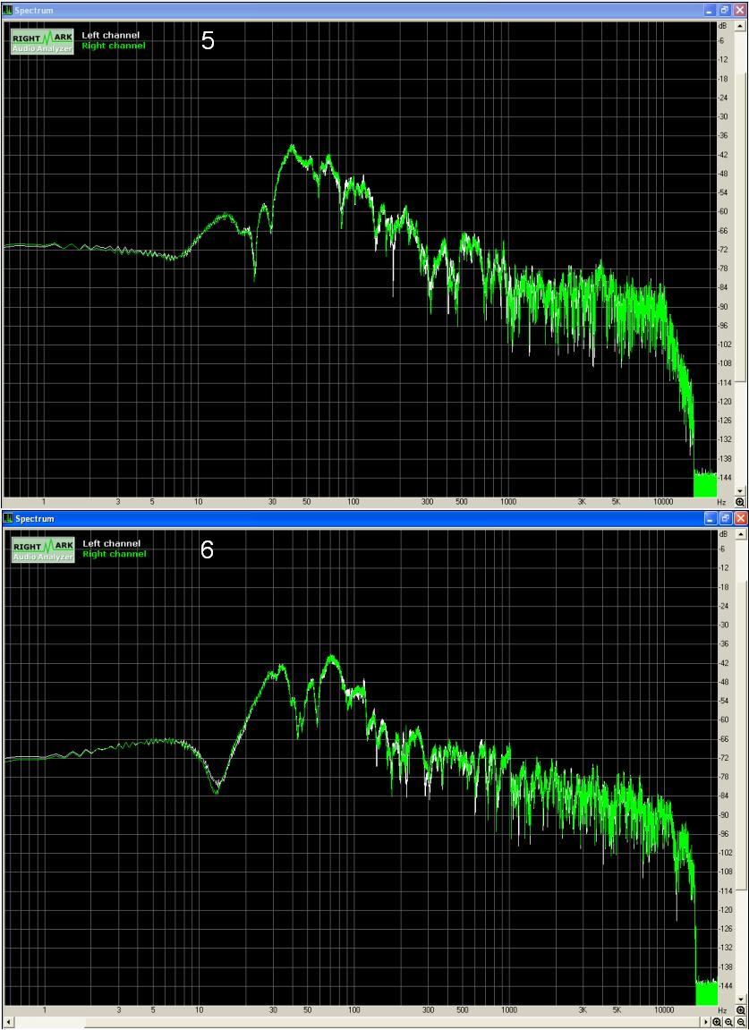

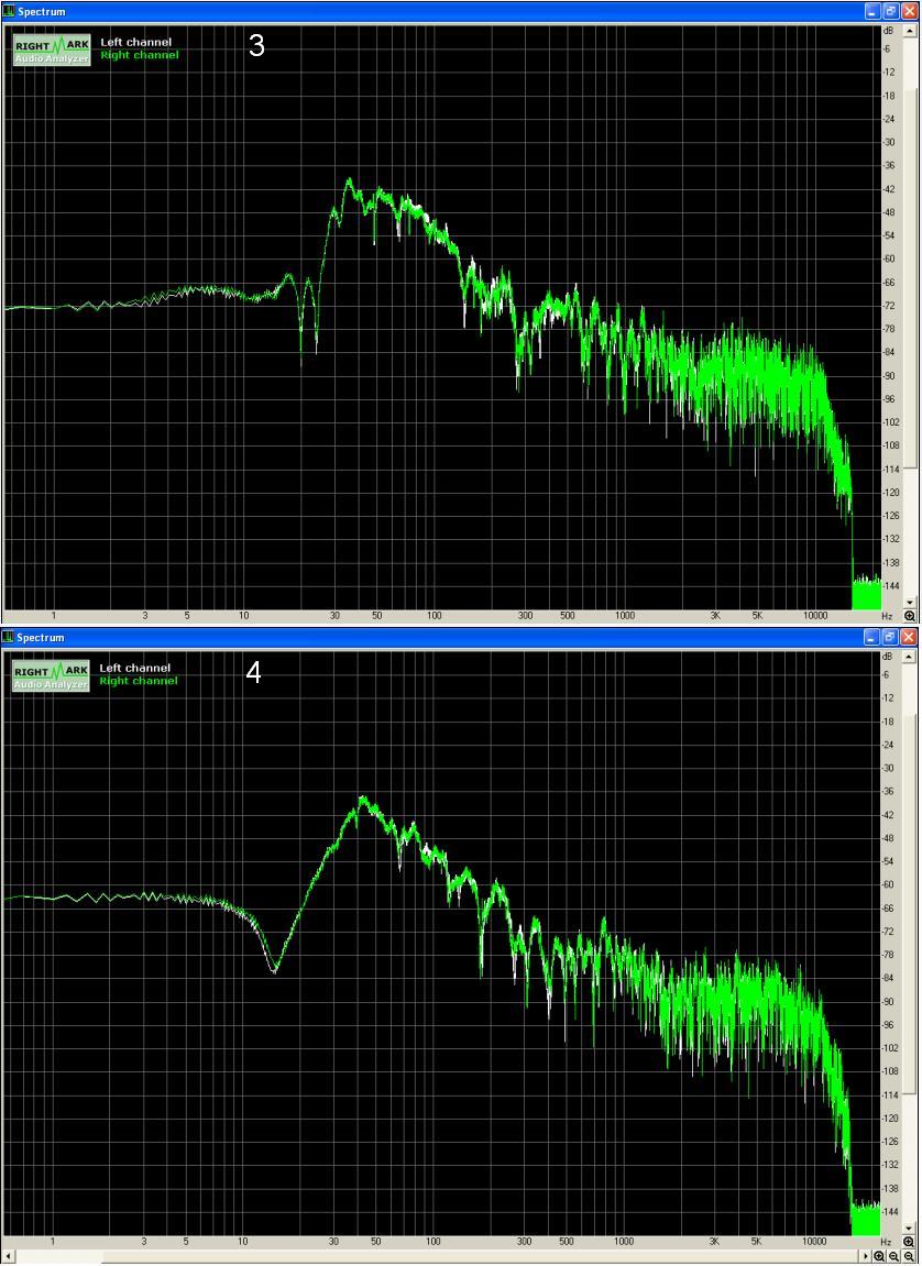

As a question, do you know how a drummer get a hard attack out of the bass drum..?.
This is from a kick drum comparison.
13 different kick drums playing four single beats each
George

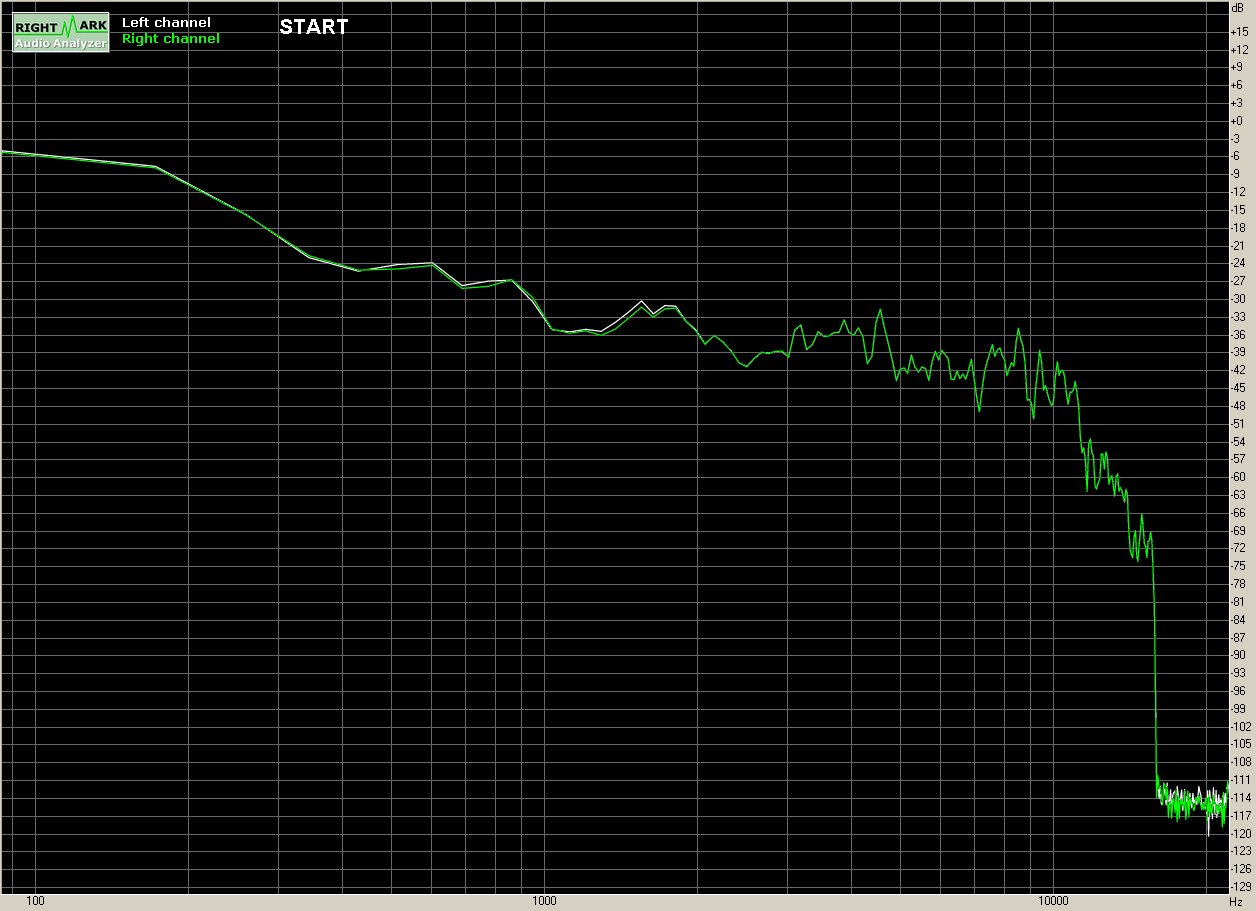

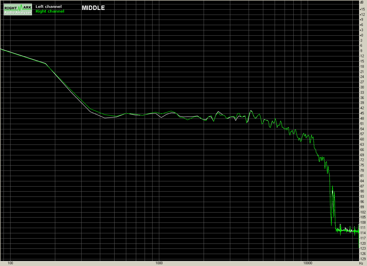

That s a FFT and per defintion you cant use this to prove your (lack of) point unless you can psuchologically visualize the sum of the amplitudes, wich i doubt.
What is the level of the signal during the first millisecond once you have added all thoses hamonics amplitude values..?..
In the rising hedge of a square you can see that full amplitude is reached from the start and then sustained, it s not difficult to imagine that the max value is sustained thanks to harmonics, the fundamental max contribution to the level occur at pi/2 and 2pi/3, that is, when the fundamental (wich is a sine) reach its maximum values wich are equal to the max value of the sustained part of the signal.

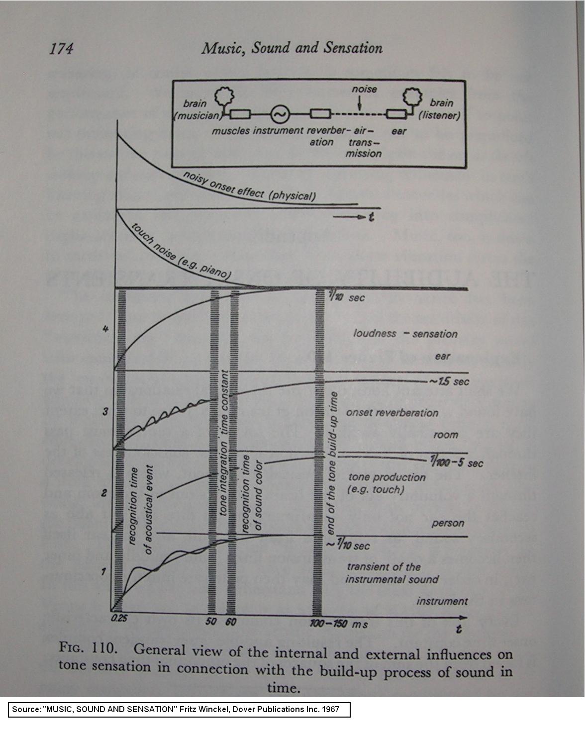

wahab please note that our brain needs considerable time >50 milliseconds to perceive tone, color and loudness.

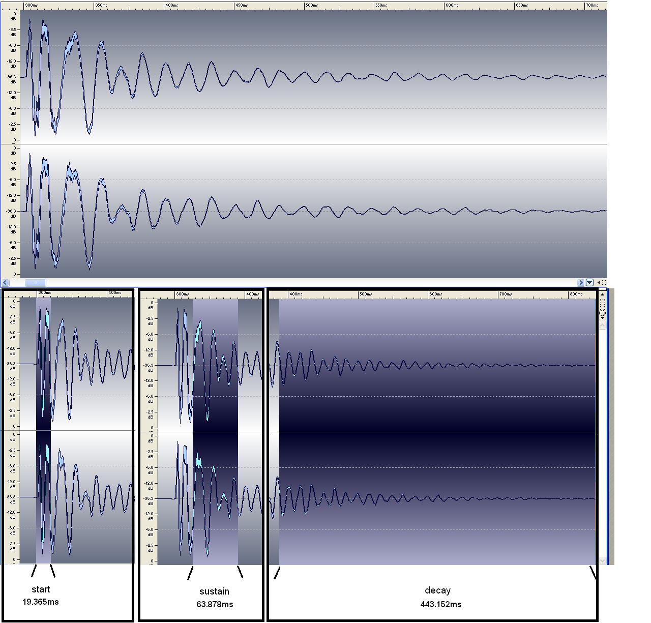

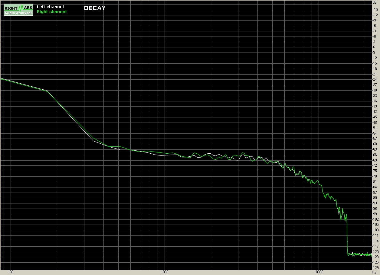

That said, I took the recording of #1 kick drum, isolated the first beat and split this first beat into start, middle and decay sections.
See the FFTs of these beat slices.
Resolution and LF extension are not good (512 points due to small duration of the first slice).
The point is the balance btn the frequency components.

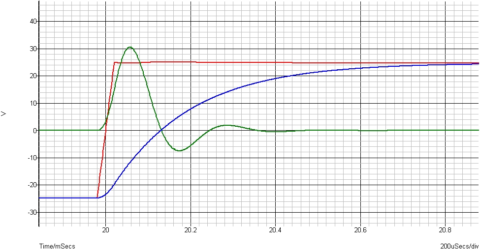

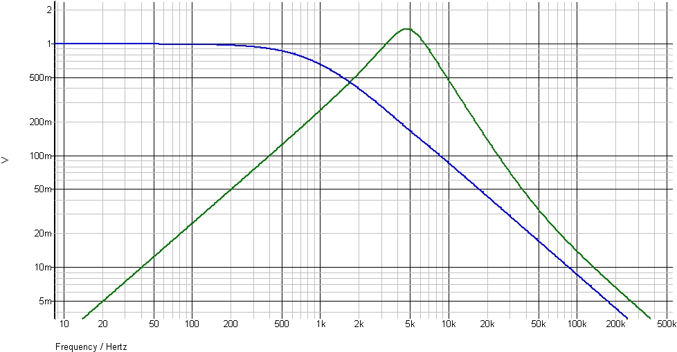

Thing is that some freqencies that are sent to the woofer will be lacking in the tweeter to reduce the amplitude of some harmonics, i guess that you know that functions that can have opposite signs are summed, so even with a limited bandwith peaks in the tweeter can exceed the square peak level, the result is a rounded peak in the tweeter in respect of the previous pic i posted.

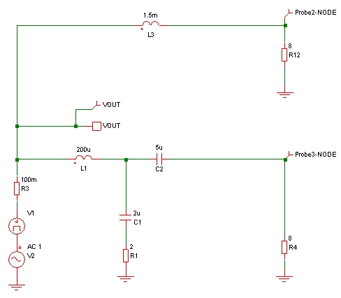

A simple filter with the time and the frequency responses, signal is 50Hz/50V pp :
That s well summarized.
The pic below is a 50Hz/50V pp square wave in red and the corresponding signals with a 2 way 6db/octave filter (one inductance and a cap..) and 8R loads, we can see the action of the filter in the time domain.
Given that amplitude of the harmonics decrease with frequency the picture would be no different if i had restricted the square wave to harmonics up to 10KHz.
Ok, but how about some numbers? You are basically saying that musical signals could all line up in proper phases so that a bunch of odd harmonics along with their f1 tone could make a square wave that would then stress a tweeter amp as much as a woofer amp (assuming equal SPL sensitivities)?

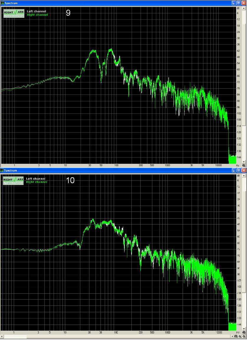

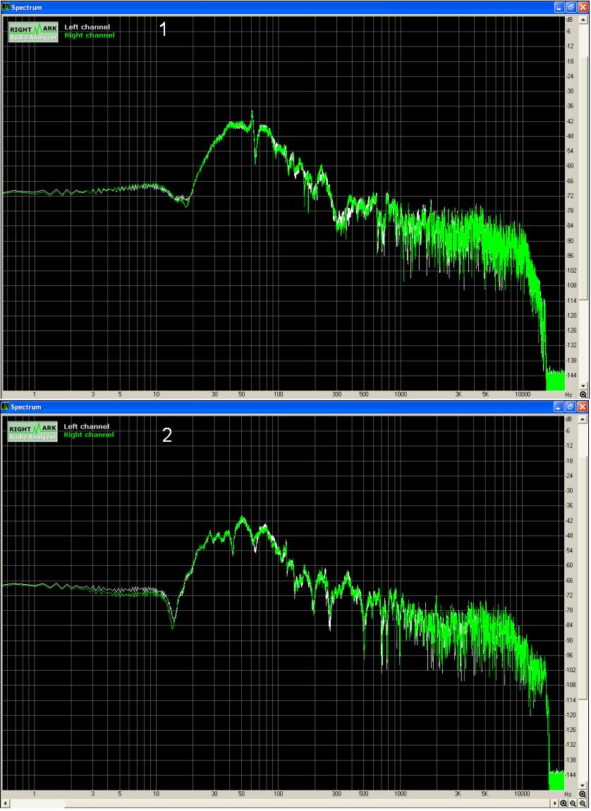

George

You can see on the sim i posted that the high pass filter cut severly the highs, yet the amplitude at the tweeter reach the peak voltage :
http://www.diyaudio.com/forums/loun...ch-preamplifier-part-ii-8514.html#post4786134
I could use an even more agressive attenuation it wouldnt change significantly the picture.
