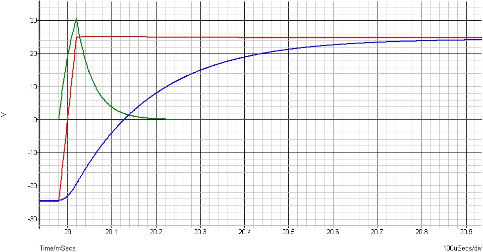

Have to agree with wahab about instantaneous power requirements to accurately reproduce a square wave, and also regarding time-domain square wave verses FFT discussion.
That s well summarized.
The pic below is a 50Hz/50V pp square wave in red and the corresponding signals with a 2 way 6db/octave filter (one inductance and a cap..) and 8R loads, we can see the action of the filter in the time domain.
Given that amplitude of the harmonics decrease with frequency the picture would be no different if i had restricted the square wave to harmonics up to 10KHz.
