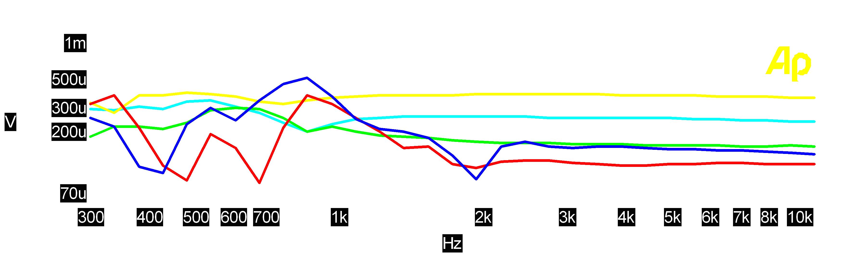

Jan,
Put a small DC voltage on them and then the desired AC signal. Listen carefully you may actually hear something. Some ceramic capacitors are first cousins to the piezo transducers used for signaling.
Attached are the vibration measurements for some capacitors. The output is almost microphone level. Of more interest to me lately is the frequency response and the resonances.
I did try using a ceramic capacitor as a vibration contact pick up microphone on my CNC engraver. It can work for several hours by itself and being annoyingly noisy I don't stick around. So knowing when it has finished was the goal. Of course common sense kicked in and I found an even cheaper way!

Jan,
From earlier posts John was talking about the Y7R type ceramic capacitors used at uF values in the Sony Tuner. So those were the curves I showed. Sorry if that was not clear. Lots of folks use NPO's in compensation circuits. So I don't see what the issue is, unless you really are using Y7R's in the audio path and get good results.
