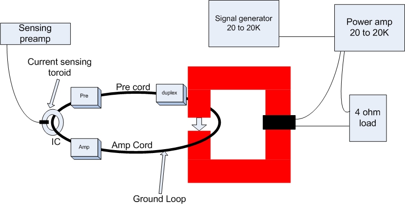

If you want to test for many of the AC line noise problems connect the secondary of a 6 volt transformer through a 25 ohm power resistor to the safety ground of your bench AC supply. The other end goes to the equipment chassis or RCA connector shell. A well designed piece of equipment will not have any issues. Not so good will hum and the bad guys will step outside for a smoke! ES
While this test is ok, it is not nearly enough, as it only looks at IR drop at 60 hz.If I remember correctly, Bill Whitlock used a diode in series to force half sine into pin 1, giving a richer harmonic spread.
Here is an even better test, one I posted back in 2008. It MUST be performed through the audio bandwidth. It will find IR drop sensitivities, it will find primary coupling sensitivities, and it will find secondary coupling sensitivities.
Be careful...it also finds errors in the source equipment output stage, something that is not even thought of.
Cheers, John

Here is another diagram. It details a bit more what is going on.
It describes the mechanism which allows line cords, outlets, and IC's to alter the sound of a system.
Cheers, John

Not within a typical home environment.
Unless of course you use 30 kA supplies, 5 tesla magnets, and measure nano and microvolt signals in the .1 hz range..at home.. As it is, we generally have to replace all the CRT's within 20 feet or so of the power conductors with flat panels, as the display content is usually color coded. The colors change as the power supply current ramps up.
Of more importance is the coupling mechanism. Once everybody understands fully the couplings and measurements, it is trivial to get to how to fix it..
My test setup measures the ground loop current forced by the driven magnetic field. It can also be used to measure the haversine amp draw ground loop current as well...although that is a further complexity most are not ready to undertake.(sources include line cord, transformer primary and line cord give odd harmonics and audio, secondary gives even harmonics and audio, supply caps couple...etc..)
For the non-geeks, my diagrams will be useful simply because they demonstrate where the physical problem lies. For example, most do not suspect that twisting the IC's around the line cord of the pre to the outlet, then up the amp line cord to the amp would actually reduce hum pickup..not something that can be done for large professional systems of course..
For the geeks, like Jim Brown and Bill Whitlock and yourself, it provides a more complete worldview of the systems they work on, with previously unsuspected coupling mechanisms. I expect these geeks to understand the engineering aspects of my design, put this kind of hardware together, measure, write, and publish papers. From there, it filters to everybody else in either knowledge, or hardware...everybody wins.
Cheers, John
