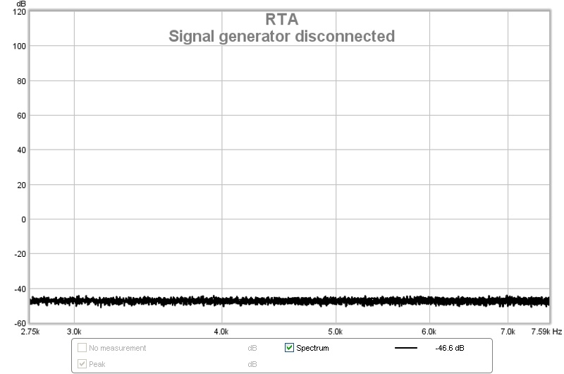

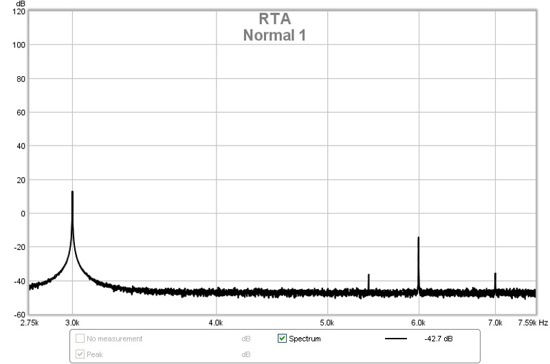

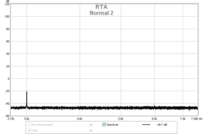

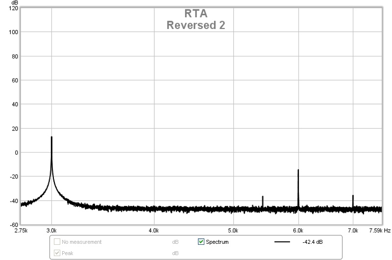

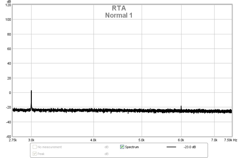

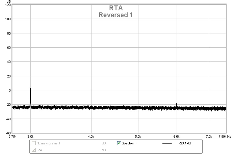

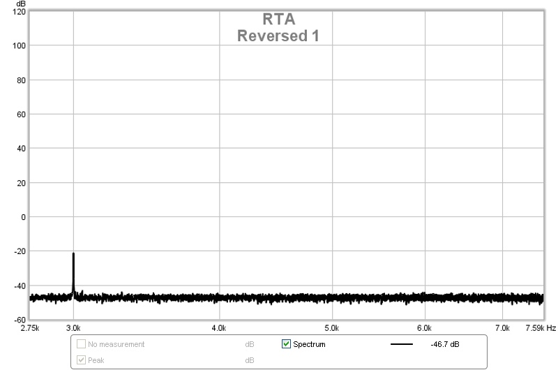

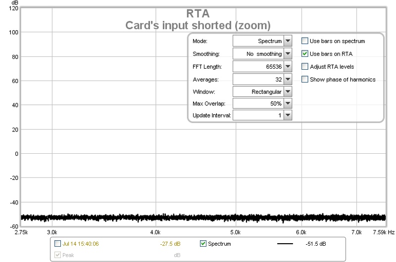

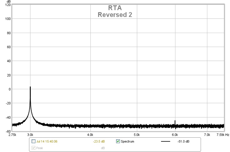

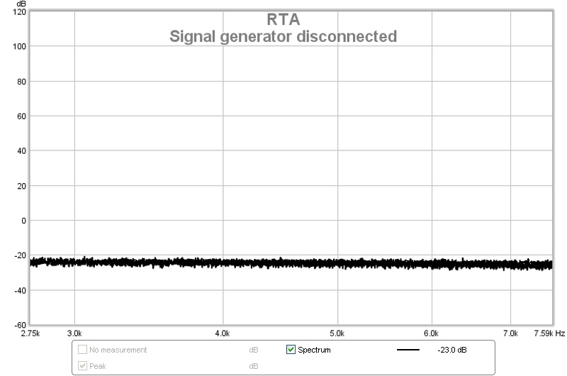

It seems to be about 90% connectors it is the rest where it gets interesting.
Well, why you haven’t said that from the start? :)

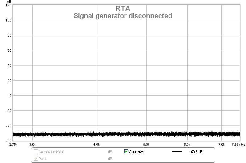

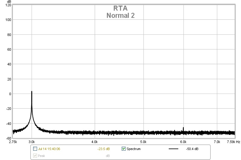

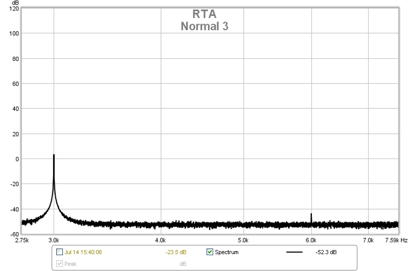

I can’t get any clue with this damn BNC to BNC cable.
I had that feeling that this will go nowhere while I was doing the (hundred plus) resistance measurements.
BNC connections give very repeatable results.
All those FFTs within each measurement set look the same to me.
I will do some more tests today (wav. recordings for further analysis).
Now, 1Vrms generator out, Instrumentation amplifier gain X1

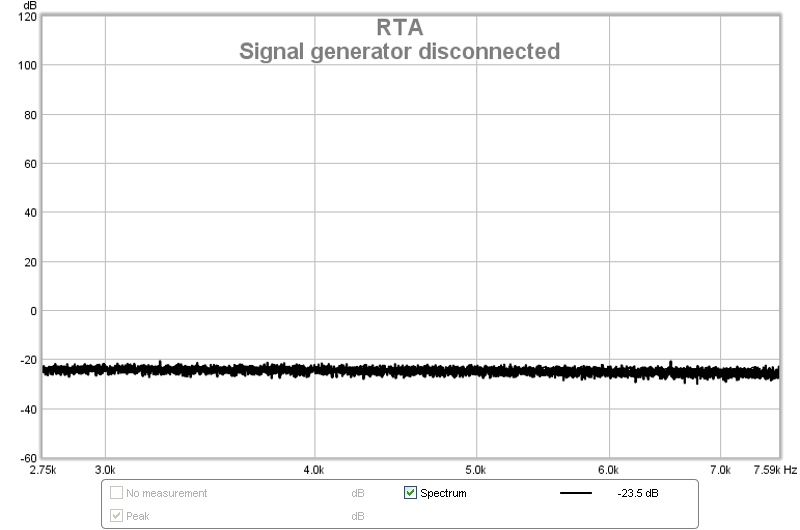

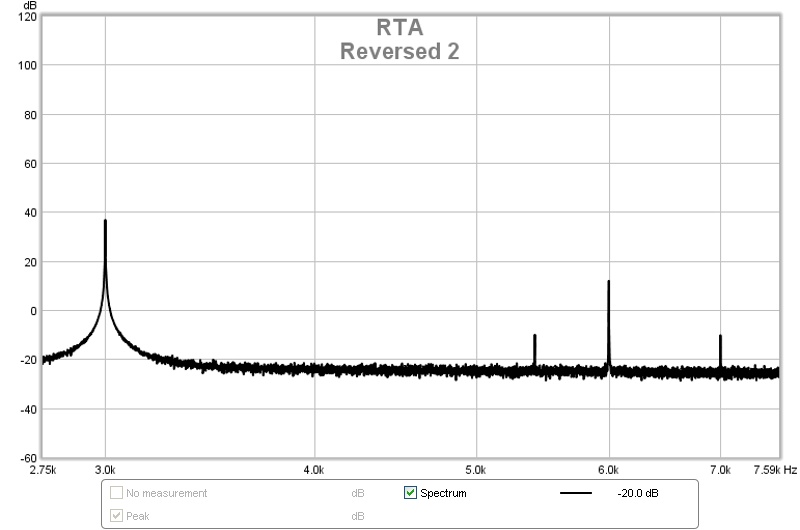

1Vrms generator out, Instrumentation amplifier gain X53

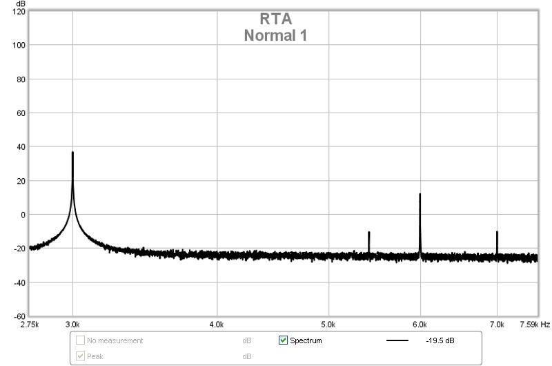

1Vrms generator out, Instrumentation amplifier gain X1050

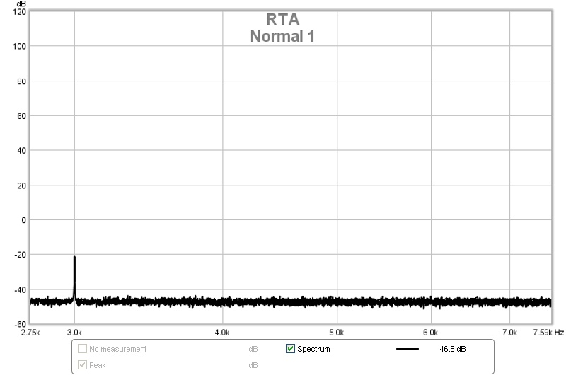

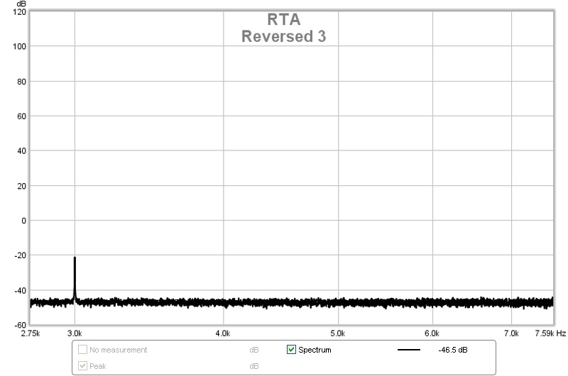

18.72mVrms generator out, Instrumentation amplifier gain X1
