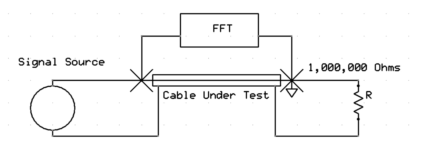

I use Dale CMF brownies. Based on power level and my measurements any contribution from these should be at least -300 dB re 1 V
Measuring 1nV riding on 10mV means CMRR is an issue. Perhaps you don't understand what CMRR is? It is not just a spec for an instrument; it is a figure of merit for the whole apparatus.
DF,
You are still confused about this. Why don't you find a colleague you trust and review the set up with them. For the convenience of anyone else who is confused I have included a revised sketch showing how a "ground" may be placed. Spice also gets confused without it.
For thousand foot runs ala Ed, load spread vs frequency may be a more significant factor. That is why I wanted him to run settling time tests for the long run and load resistors ranging fro 4 to about 200.
No confusion at this end. Your revised diagram now has the coax outer (with significant stray capacitance to everything else) carrying a voltage signal much higher than the one you are trying to measure. You can't always turn a bad experiment into a good experiment just by moving the ground connection.
Really? Care to run some numbers? If you think it makes a difference then move the resistor to the other end. You were arguing PSSR now your target has moved. You really should have a chat with someone.

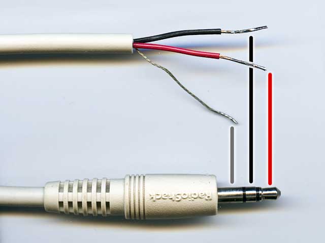

Hi Ed.
I have done extensive AB listening over the last day or so, using a common 3.5STM-3.5STM connecting cable.
Three different sources (2 x Mobile phones playing Flac files and $1.00 eBay mini Mp3 player) feeding four different amplifiers (Sony shelf system, 3 x car stereos) with 3.5mm inputs.
I find that such cable is quite strongly directional, with the subjective result being differing depth imaging and perceived distortions according to the interconnecting cable direction. PM me for more.
Example pics, I believe the cable came with a Logitech system...I have not opened the cable to see what's inside.
"When the facts change, I change my opinion;", someone said, "what do you do?" You moved the ground; that moved my "target". The main problem is still there: measuring a small signal in the presence of a much larger signal with a similar spectrum.
I am chatting to lots of people. Most of them agree with me that your experiment is a bad one. I find that encouraging, as some of them know far more about good experiments than I do. If a simple theorist like me can see the flaws in your setup then it can't be very good.
Why don't you just drop this? You have adequately illustrated the point I made; for that I must thank you.
Loop. That only pollutes things further.
There are far more ways of designing a poor experiment than designing a good one, and one indication of the former is reluctance to provide details or R&R. Idiosyncratic definition of terms is also a red flag.
