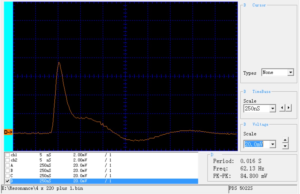

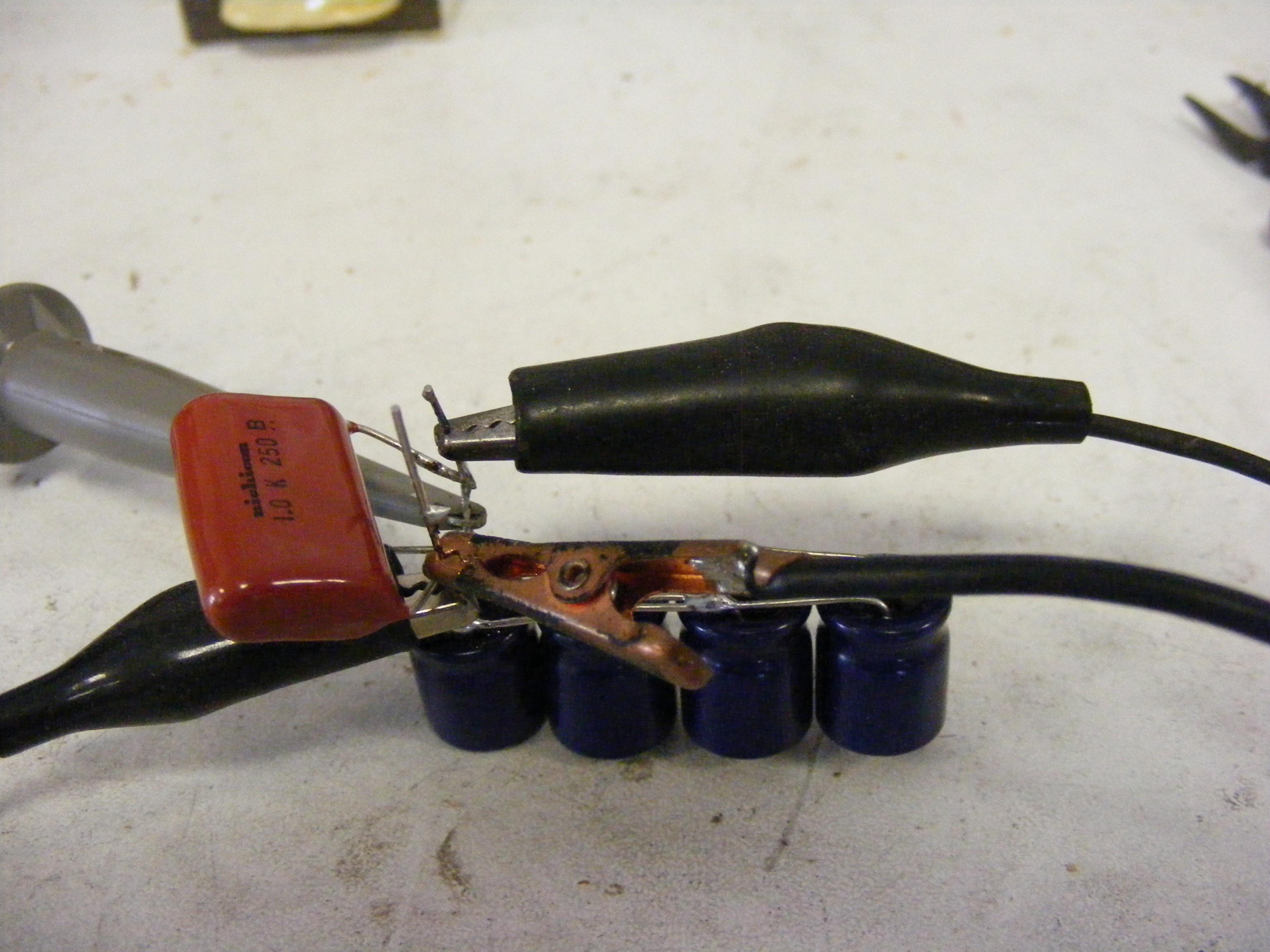

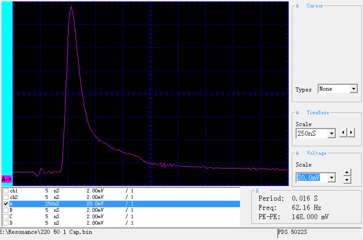

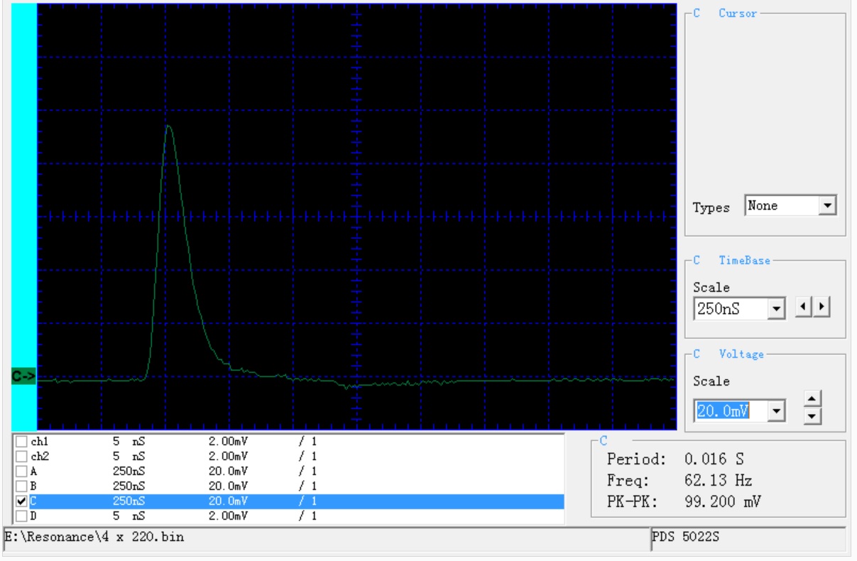

The second image is of the probes across a single 22/50 electrolytic capacitor fed from a 60 Hz square wave through a 10nF capacitor.
The third image is of the same capacitor but now bypassed by a 1/250 film capacitor.
The fourth is four of the 220/50 capacitors in parallel.
The final is the bank of four with the 1/250 bypass added.
All of the resonances are extremely affected by lead length and layout that should be to no one's surprise.
I think the point is that you must measure the actual circuit to figure out the proper bypass scheme. It is way too dependent on actual layout and components. If you want to try and model this you need more than the data sheets!

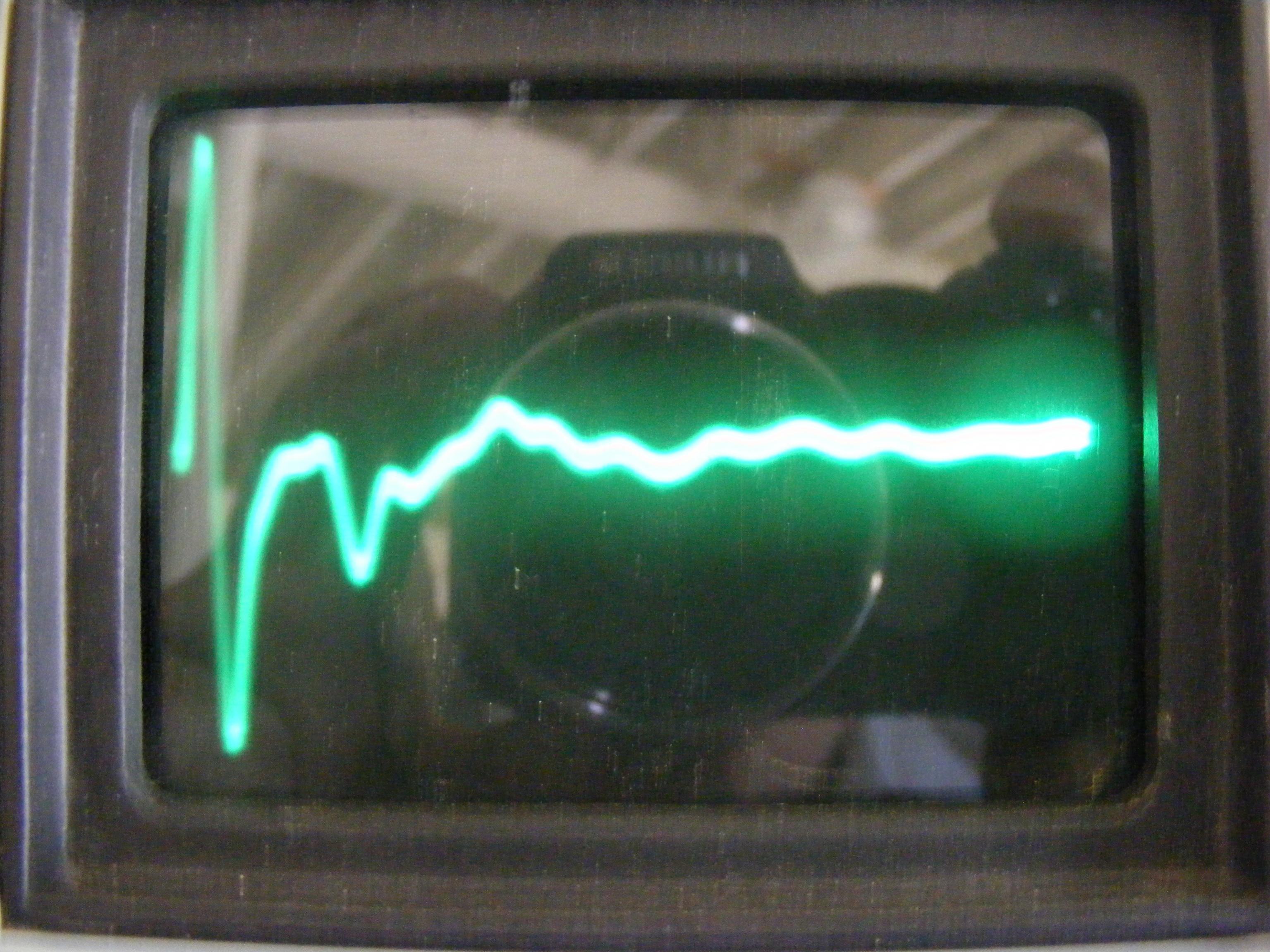

This image should confuse things even more!
It is a TDR of a 10 ohm resistor placed at the end of 50' of loudspeaker cable.
The image is by no means confusing.
But again, I see no timebase at all, and no mention whatsoever of what it is.
50 feet of ""loudspeaker cable" doesn't help at all Ed. What is it's inductance per foot, capacitance per foot??
With no info, I can only surmise the EDC at roughly 4 and the line Z at roughly 120 ohms...reflection coefficients at each end based on a guess at line z, 10 ohms, and meter output z..
Prop velocity is roughly half C (1/sqr(EDC))
2nSec per foot, 100 n sec per length, 200 nSec between stimulus and the negative reflected return.. waveform is a bog standard expectation of driving a line not matched to the source nor load...
So you see the problem Ed? You give absolutely NO relevant information, leaving all to guess as to what you were doing (or trying to do)..or walk away from the discussion in disgust..
If you really want to show something, use a step function. I'll interpret the results of that for you..
John
JN
Gotcha. Chill. You did guess most of it right. The cable is sold as a stadium type loudspeaker cable.
But as mentioned before I am looking at how real cables behave on my size projects. I am awaiting delivery of the cable that I had made of 12 gauge twisted pairs with .011 of polypropylene insulation.
I do use a 50 ohm to 8 ohm balun for the tests.

JN,
That TDR is a bit old as you may have guessed. It does not have a time scale. You set the relative velocity and then move a tracer and it gives you a distance. Quite useful for what it was designed to do which is indicate and locate faults.
I only posted the image because I think it nicely illustrates that loudspeaker cable often does not match the intended load. It was for fun not serious study.
No actual values are shown because it is unlikely anyone has a loudspeaker with a flat impedance, or even a cable with specified parameters other than NEC classification, gauge etc.
I will not show data on my current cable design as it is still in flux. I did have a bit of bother explaining what characteristics were required to get quotes on a sample run. They were more concerned with colors than with twist! Same issues trying to get stranding right.
Now if you want to discuss this privately, as I think you are the only one here who has pulled a bit of cable and understands the hidden issues, that is fine.
