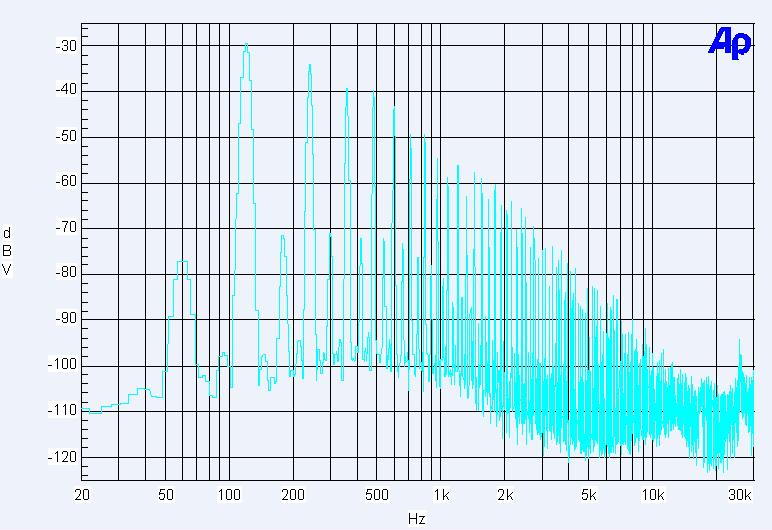

Just for fun and John here is the FFT of a simple power supply showing filter capacitor resonances.
Why are you calling full wave ripple "capacitor resonance"?

Because of the bumps at 18 & 36K.
Both are harmonics of 60 Hz, it's easy enough to actually plot the impedance of the capacitor vs frequency without all the potentially confounding data.
Once the first FFT shows there is a problem. I am stealing a page from Mark J and driving the capacitor bank with a square wave through a 10nF capacitor and then trying RC networks to damp the resulting ringing.
Clearly shows that just paralleling big uns and little uns can make things worse.
It's a known phenomenon. In surge testing some poor designs get higher peaks at the output of the filters. Figuring the damping it not easy or obvious.

... I am stealing a page from Mark J and driving the capacitor bank with a square wave through a 10nF capacitor and then trying RC networks to damp the resulting ringing.
Please don't forget to include the part where you use linear systems theory to derive equations that tell you "if I increase X then Y should decrease" and "if I decrease J then K should get much worse" ? It was an essential piece of the work I did.
I used to have a spreadsheet that calculated the impedance of 4 caps in parallel, you can clearly see how it can go wrong, it might be still available somewhere, or calculate it for yourself.
