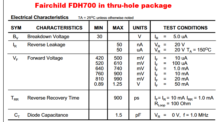

Found a silicon (non Schottky) diode with sub-nanosecond Trr: the FDH700. Better still, it's not even surface mounted. Rochester has 47,000 of them in stock and on the shelf. If a silicon diode is gold doped, is that "cheating"? You be the judge.

Interesting, thanks.
I note the 10mA, -10mA, -.1mA values used, typically it was .5/-1/-.25 .
btw, TRR is relatively consistent over 5 orders of magnitude in current density. A power device measured at half amp forward, one amp reverse, quarter amp threshold will measure the same at 1/1000th the currents.
To me, the most important number in that spec is the 100 ohm value they mention. That is the compliance resistance being used to force the constant current in the reverse direction. A lower resistance causes the recovery tail to be longer, so the .1mA number would extend out in time. This due to the drive current falling off of constant current mode as the diode voltage increases. Running a higher series resistance holds the reverse current longer.

For regular pn junction diodes, the low trr comes to the hefty price of forward drop (that is, increased power dissipation). Gold doping impact is huge, look at this diode, 1.25V forward drop @50mA is the price for a ton of recombination centres to quickly eliminate the minority carriers from the depletion region, at turn off.

And watch out for reverse leakage. The venerable 1N4148 and its ilk have a bunch and are thereby rendered unsuitable for some applications.
