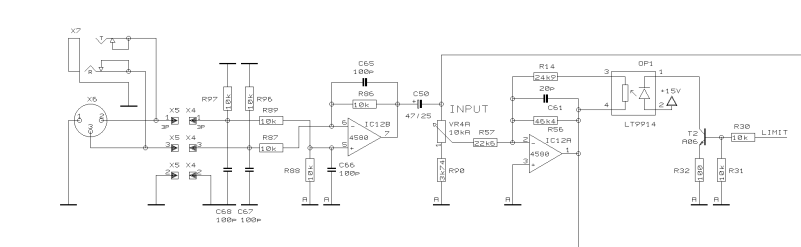

Can you give a circuit ?.
Dan.
If there is enough interest... but it would end up in another forum as a DIY project. Or email me and I'll give you a schematic. I had said I would do a piece for Linear Audio magazine but as time goes by, I just dont have the energy to do it (or interest). It was to include such things as I showed regarding how we (in USA) created ground loops and made equipment vulnerable to lightning.

...... Or email me and I'll give you a schematic....
THx-RNMarsh
Sent you a PM.
They don't allow email anymore via the forum these days.
Many thanks in advance,
Patrick
