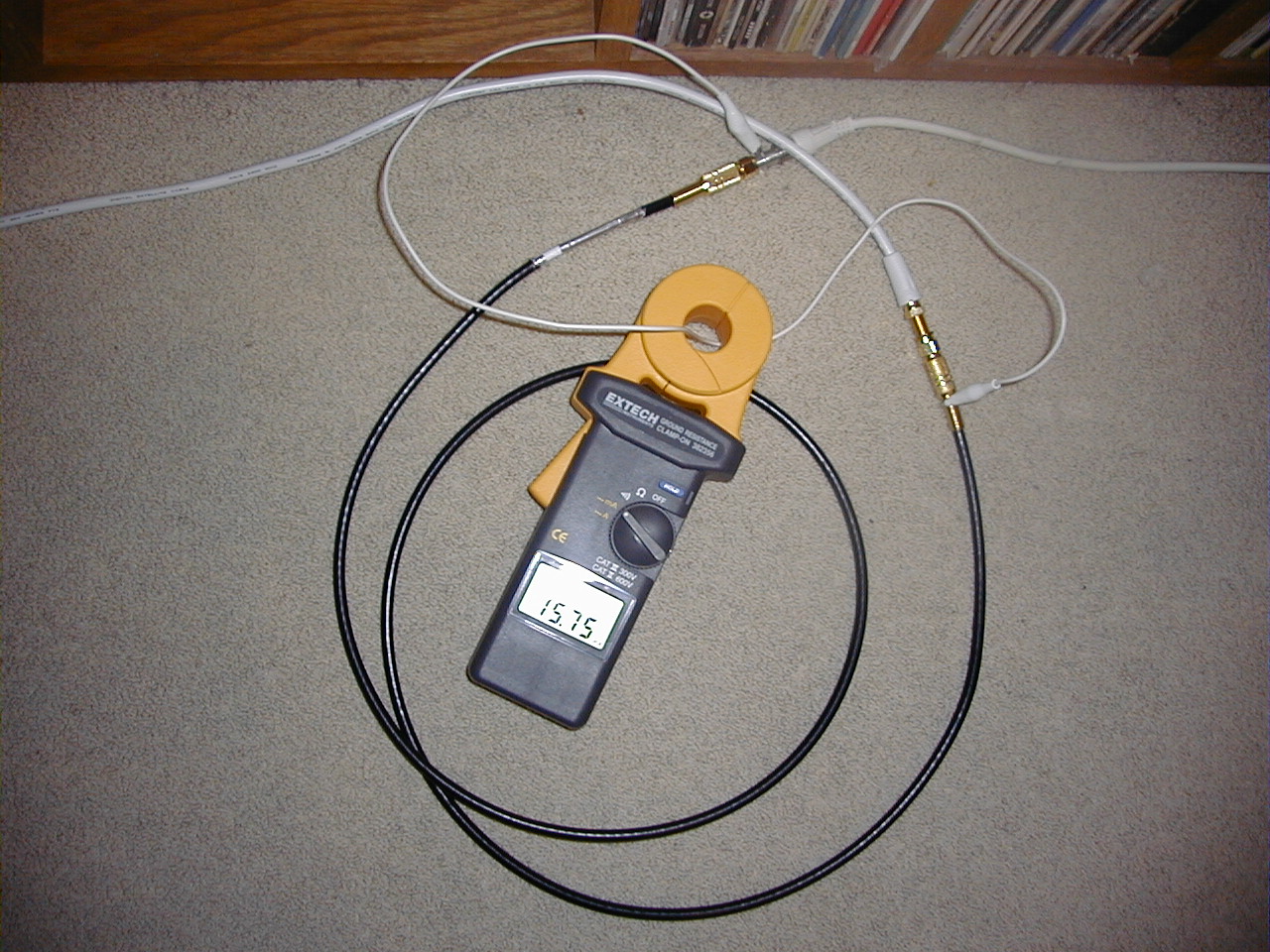

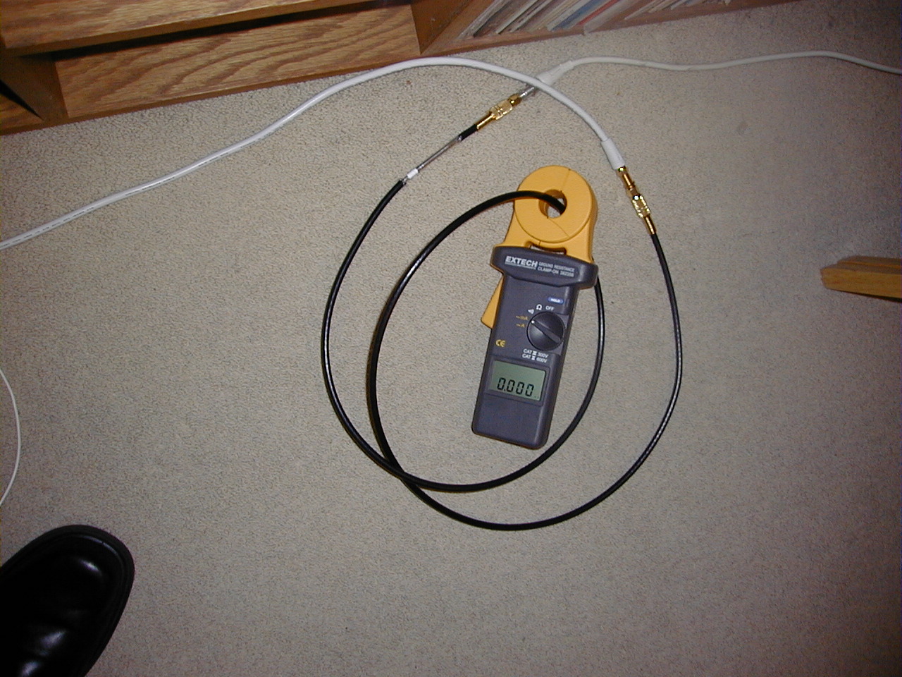

There are several problems for audio in the home. EMI/RFI is but one. Grounding is another. Until recently, our NEC (National Elec Code) said it was OK to just put a safety ground wire in the earth at the point of cable entry.... cable being Telephone, or CATV etc. This gives us a multiple ground point system instead of a single point ground. Recently, the NEC caught up and requires all cable entry and ground at one point where ac power is grounded.
So, the majority of us have a multiple ground which causes ground loop currents to flow.
Here is shown, the 60Hz power current flowing thru a CATV cable.... the CATV is grounded about 100 feet from the ac power panel ground. There is enough earth resistance to develop a voltage between the two different points. One is the mA current flowing in the CATV cable and the other with the ground side of the CATV cable coupled with a small C.... small enough to be a high Z to 60Hz.
The mA current flow is rather higher than you might have thought. The problem shows itself when a Video and Audio system are connected together.... hum, noise or increased distortion results. This grounding situation is the norm in USA unless you have a home built in the last couple years.
THx-RNMarsh
Luckily UK is generally better, except when I was on a poor overhead power line that was tripping an 80mA RCD regularly.
But if your cable box is double insulated (as many TVs and disk players are as well) with no PE, then where does this current come from? Whilst a proper equipotential bonding setup is the 'right way' it seems this issue should have an easy fix?

In the US, on the east coast, we use a single bushing transformer on the pole. The ground for the multikilovolt primary feeds in the residential areas is shared by the secondary of the 120 volt, it goes into the house as a neutral. In addition, roughly every second or third pole has a copper grounding wire going into the earth.
The net result of that, is that the earth actually carries roughly 5% of the current being delivered to the residences. There is a 60 hz voltage gradient across the actual land.
There is a requirement to run a grounding rod at the meter pan on the outside of the house. the resistance value of that earth ground is required to be less than 25 ohms. If it is greater, we are required to add a second one, I believe it must be at least 8 feet from the first. There is no requirement that two rods have a parallel resistance less than 25 ohms, just that a second one be used if the first is greater than 25.
The earthing rods are NOT current fault paths for the electrical wiring of a house. They are entiirely for lightning, to be used to divert current to the earth.
On the west coast, they use two bushing transformers, and do not rely on the earth to carry sizeable currents. However, since the system still has to be brought to earth potential for strikes per NEC, they also have to contend with earth currents.
