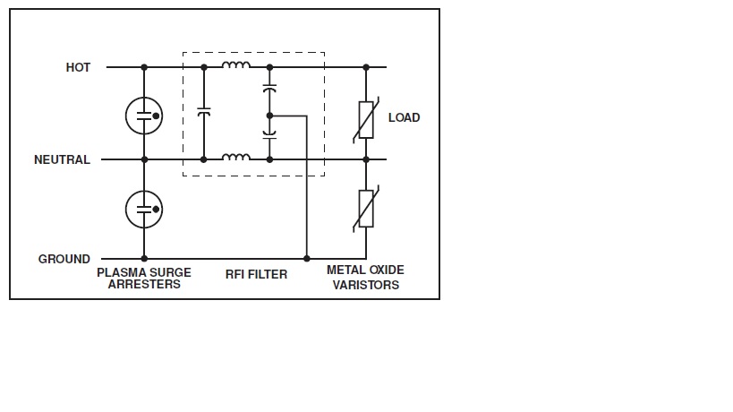

Sensible line filtering (x-cap, CM choke etc) is not wasted. As I noted a few posts back, PLC devices inject significant amounts of gunk on the line - and Demian seems to concur. Take a look at Ostrippers picture of line noise as well.
See attached. MOV is in parallel not series. So how does it 'match'?It matches just fine. For audio we usually need some additional filtering - if placed before the GDT-MOV it slows the response needed.
Other question --- the UL and other standards are not for audiophiles... The limits of EMI/RFI are established to prevent police, fire, medical and aviation interference . The RFI filter for UL/Gov is far from adequate needs for audio.

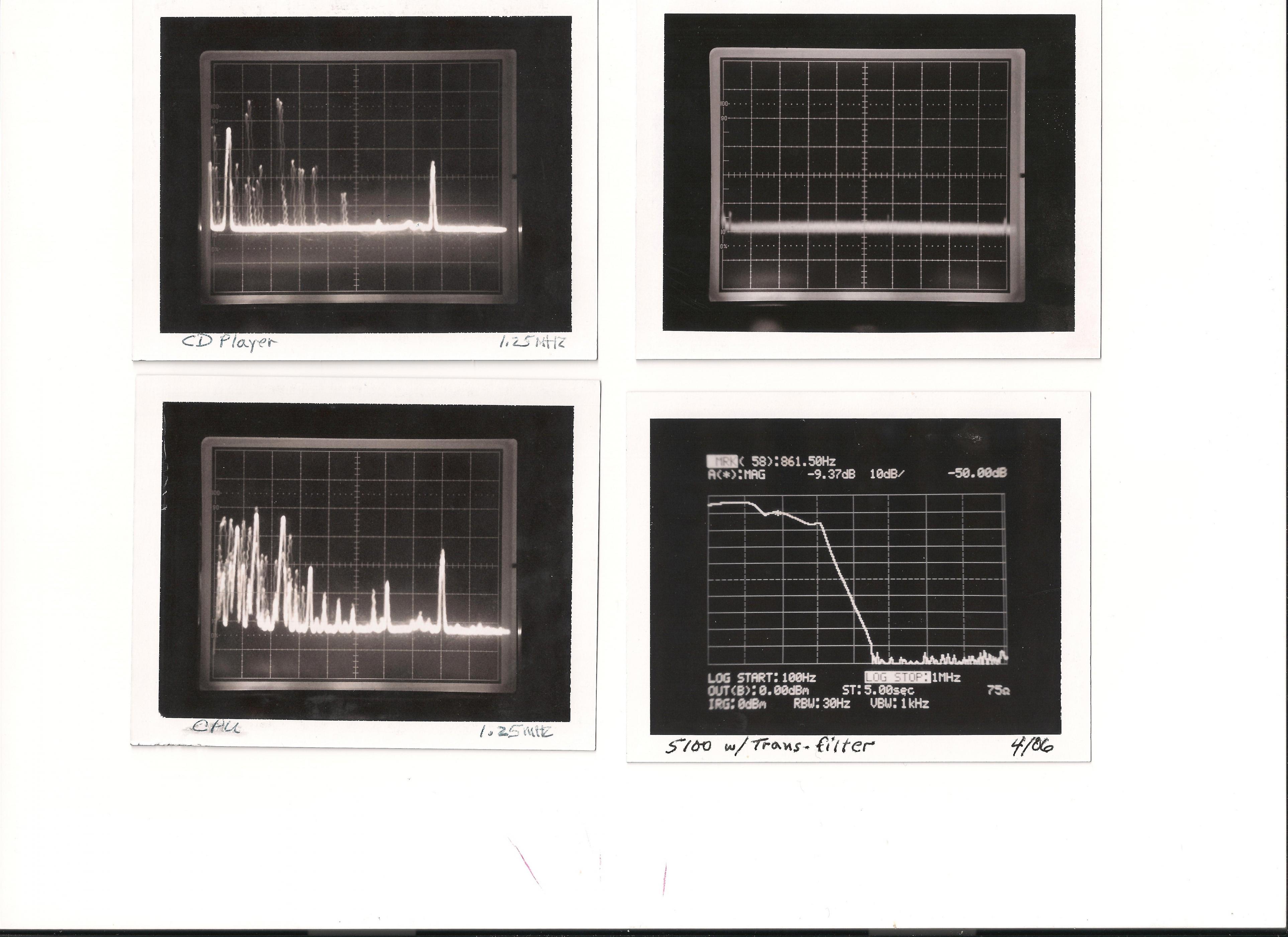

If you put a wide band inductive probe next to an (DUT) equipments' ac cord and turn the equip On, you will see on a spectrum analyzer- from a quiet base line - all sorts of noise put onto the ac line.

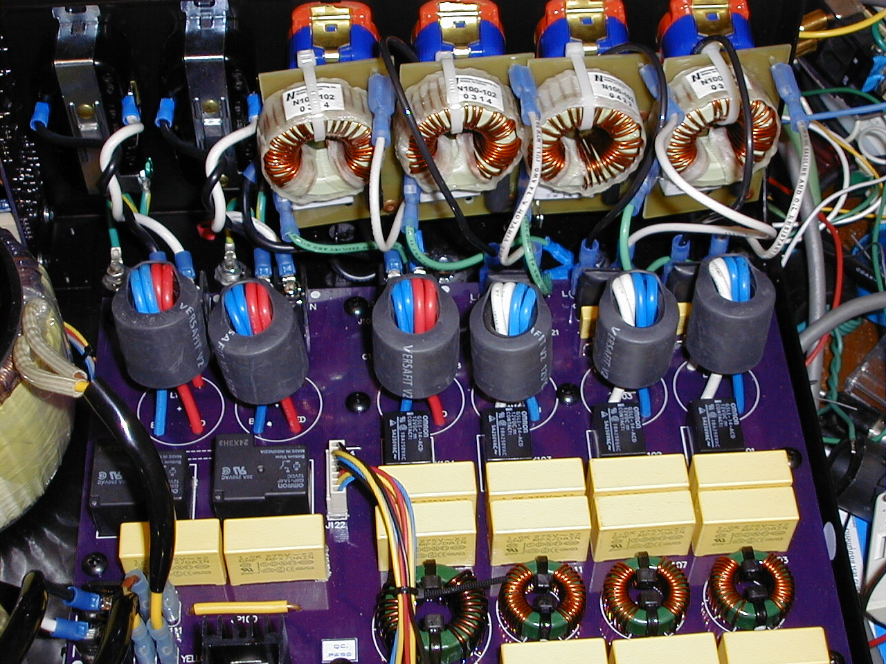

Possibly the most researched and best ac line filtering ever to be offered to the consumer is the model HTPS-7000. It was selling well until the 2008-9 economic collapse. You can still find one now and then on ebay. The small price used doesnt even cover the cost of one ultra-isolation transformers.. Note individual isolation filters. Demian Martin over-saw the protection circuitry and i did the filter concept and designs. It is approved by all agencies (UL, VDE, CSA etc) for sale world-wide. Safe and very effective. It is no longer made.
In this picture.... upper right is the ac line without any connected equipment turned on. Below it is one of the isolation filters.... way below -100dB rejection.
Built like a military piece, get one if you can find one.

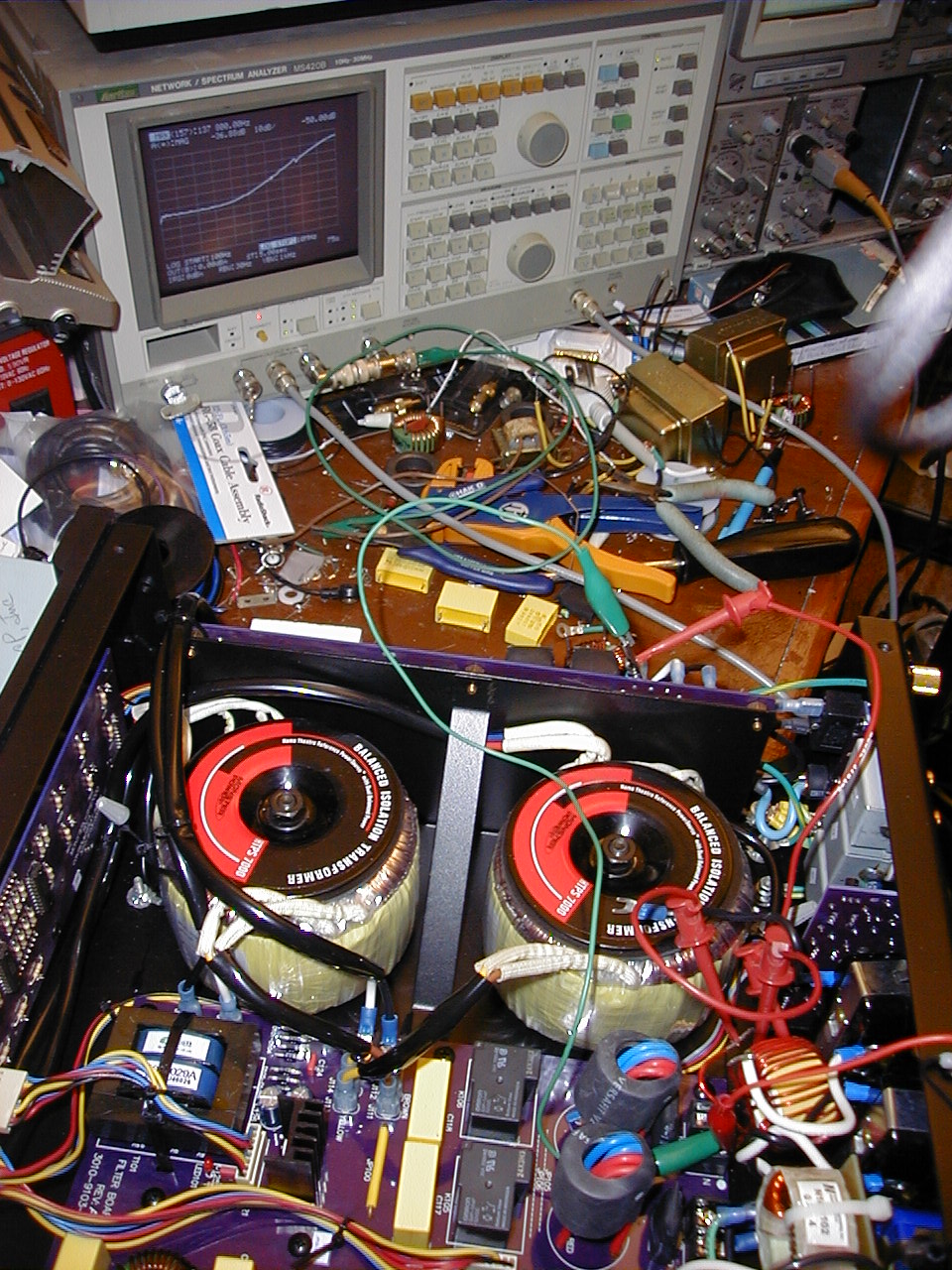

On my dvelopment bench.
Individual filters on each outlet.

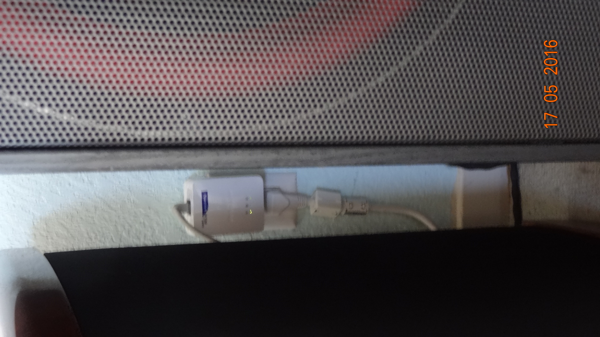

I use the PLC and with test equipment I also learned how to make it extend its range and NOT cause interference to other connected equipment.
I selected a ferrite that has high Z at the freqs used by PLC transmitters. Placing one on each cord of connected equipment keeps the PLC signal going where it is needed and not split-off into various unintended routs and attenuated.
In the pictures I just took for you is my Video room getting a high speed internet movie streamed to it via PLC. Note the ferrite used to keep the PLC signal out of the video equipment et al.
Same for audio control of music files in another room.
Click on them and they go straight up.
