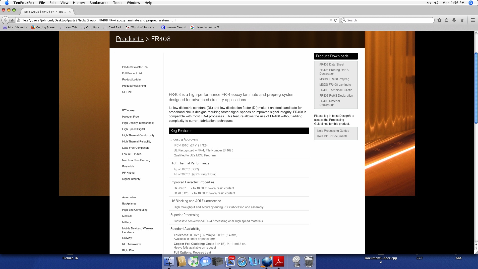

Yes, general purpose FR4 is good enough for most of you. However, the CTC Blowtorch used Teflon and I am not sorry that I chose it.
However, there are different 'types' of FR4, and some are OK for Parasound, etc.
