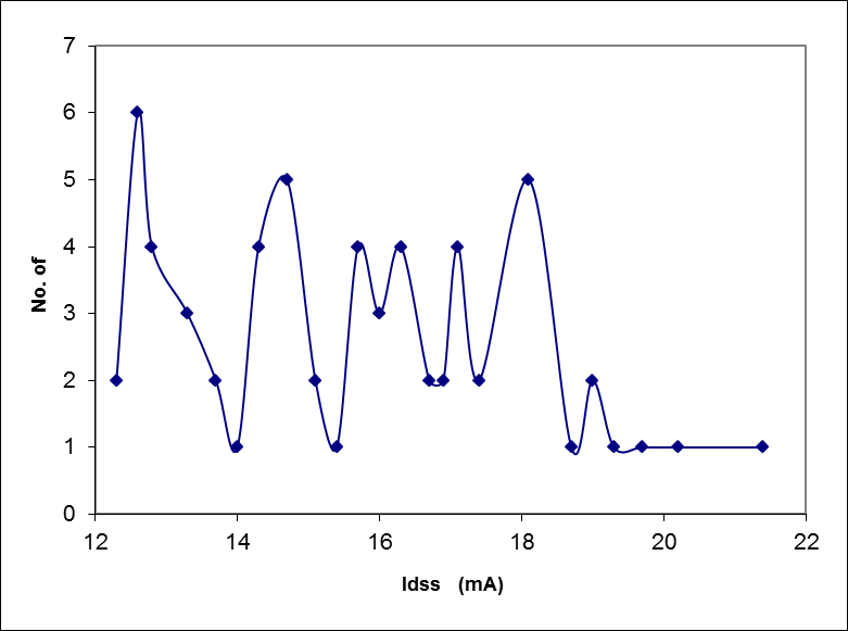

BF862 Idss
I have once tested maybe 80 or 100 devices and they were nearly all 12-13 mA, very few outliers by more than 2 mA when I wanted some high Idss ones.
regards, Gerhard
The last time I measured a batch of ~60 in 2009.
See attached.
All over the place, I would say.
Patrick
