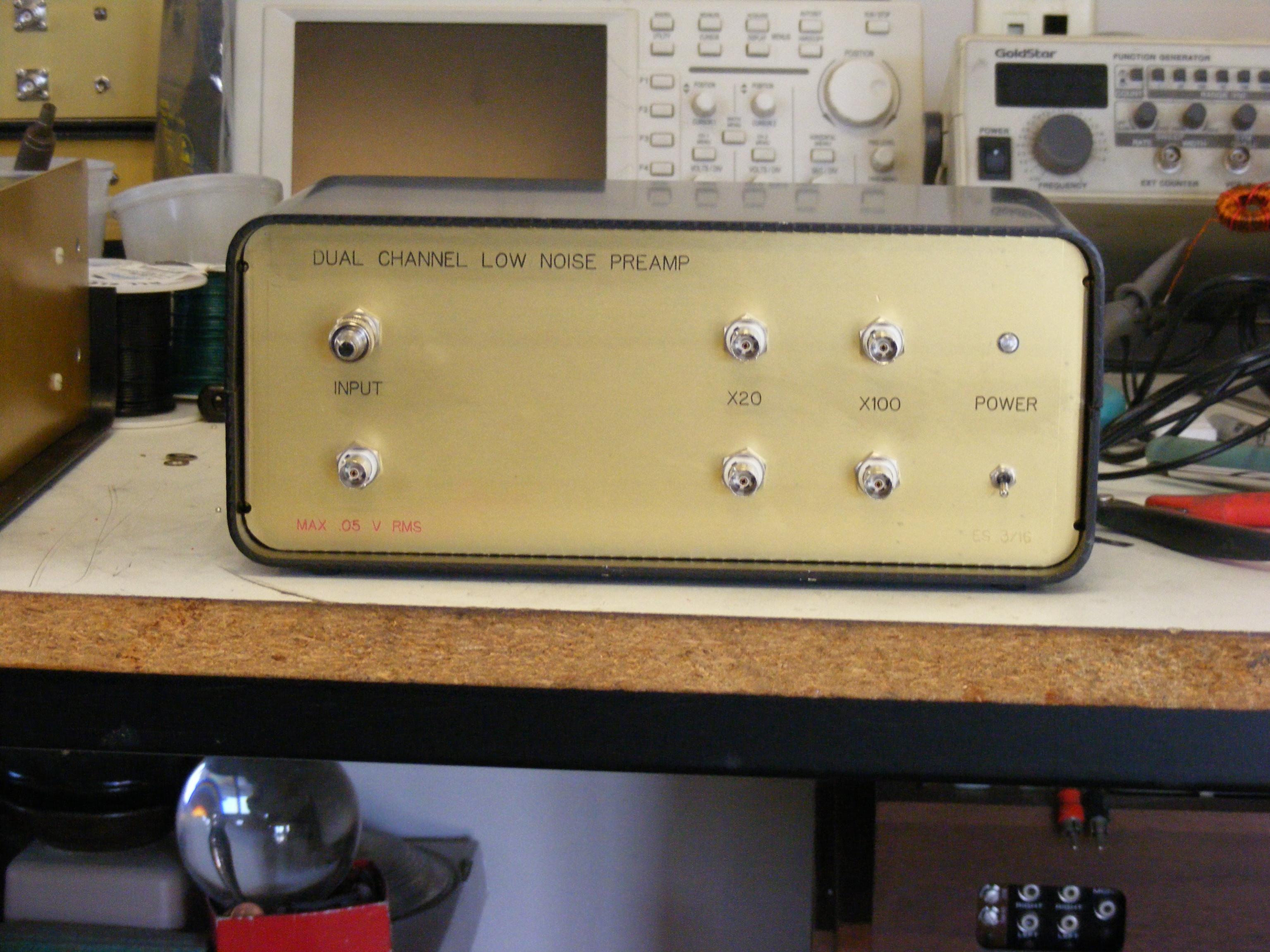

How's the 20pV/rtHz amp going?
Peachy keen and dandio. Works nicely. Picture attached.
Some results to share?

Already shown without the transformer and if you look at the picture you can see just one of the step up transformers.
