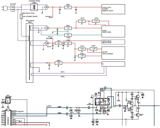

SY’s Marantz CD player does not spare on number and quality of components where needed (plus discrete analog out buffers 🙂).
It also addresses all points that ticknpop highlighted at post #79810, despite the ample use of 3 leg voltage regulator ICs 😀
It’s a very good and honest product (and it’s 24bit DAC full capabilities are only partially used).
