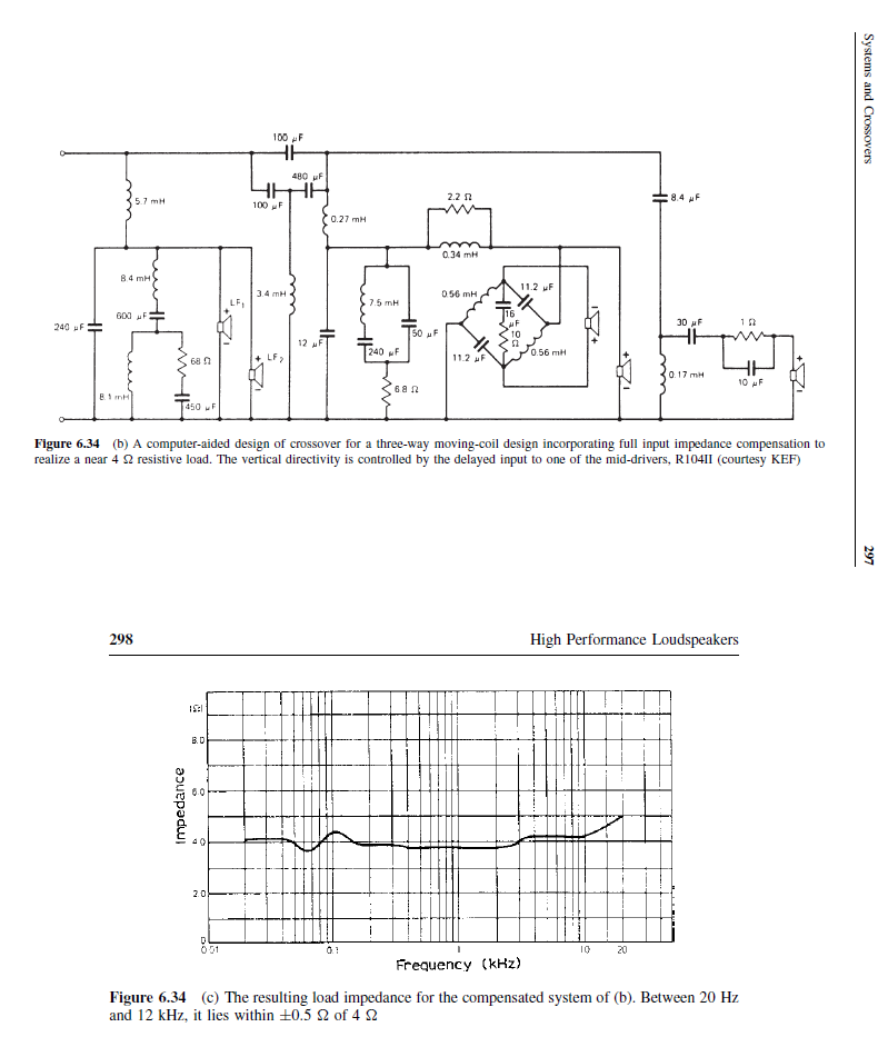

I would understand the release of a loudspeaker with very difficult impedance curve, only when the same drivers on the same enclosure had been tested with cautiously designed x-overs and found lucking in acoustic terms (it’s my experience that loudspeakers with complex passive x-overs don’t win the battle of “first listening impression”. It takes some time to appreciate their qualities).
Mr Baxandal in his article (page 15, right column) praises the almost purely resistive 4 Ohm impedance of KEF 104/2
Attachment is from this excellent book

...competent designer to fix the crossover.
According to the reviews at the time, there was a dustcap resonance around 2kHz, the fix for which caused the impedance problem. Odd given the Wilson mystique of custom modded drive units just for them. Still a cludge, but at least then only high end amplifiers will be demonstrated with your speakers!
