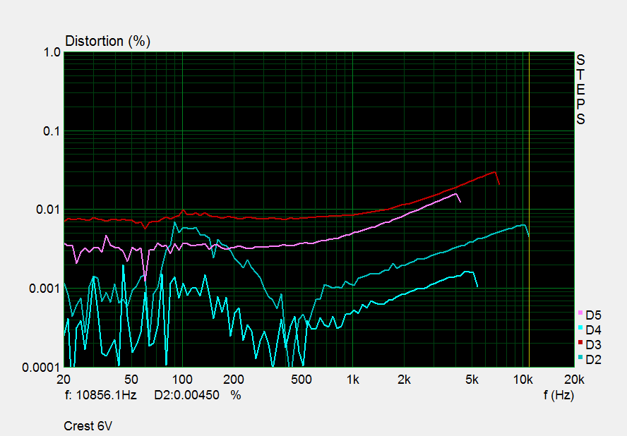

Probably. 🙂 But I do have an opinion, none the less. Was just curious if anyone else has used an amp with similar spectra and formed an opinion. There has been a good bit of discussion of correlating subjective impression with measurements.
The intermod is higher than the amps I have in house, though interestingly, on the 11-12, it manifests as sidebands rather than a first order peak at 1k.
Yes, I noticed that. Wonder if I can hear it? The harmonic distortion is strongly odd order, but does decrease in amplitude as the order increases. Another plot (below) shows that distortion rises with frequency. I don't know what the big H2 bump down low is, unless it's picking up 120 & 180 Hz mains noise.
What does source impedance look like?
Source impedance is 300 ohms, balanced. Amp input impedance is 20K balanced. Input attenuation is about 10dB thru the built in volume knobs.
This is a Class-H amp with a heavy toroid transformer.

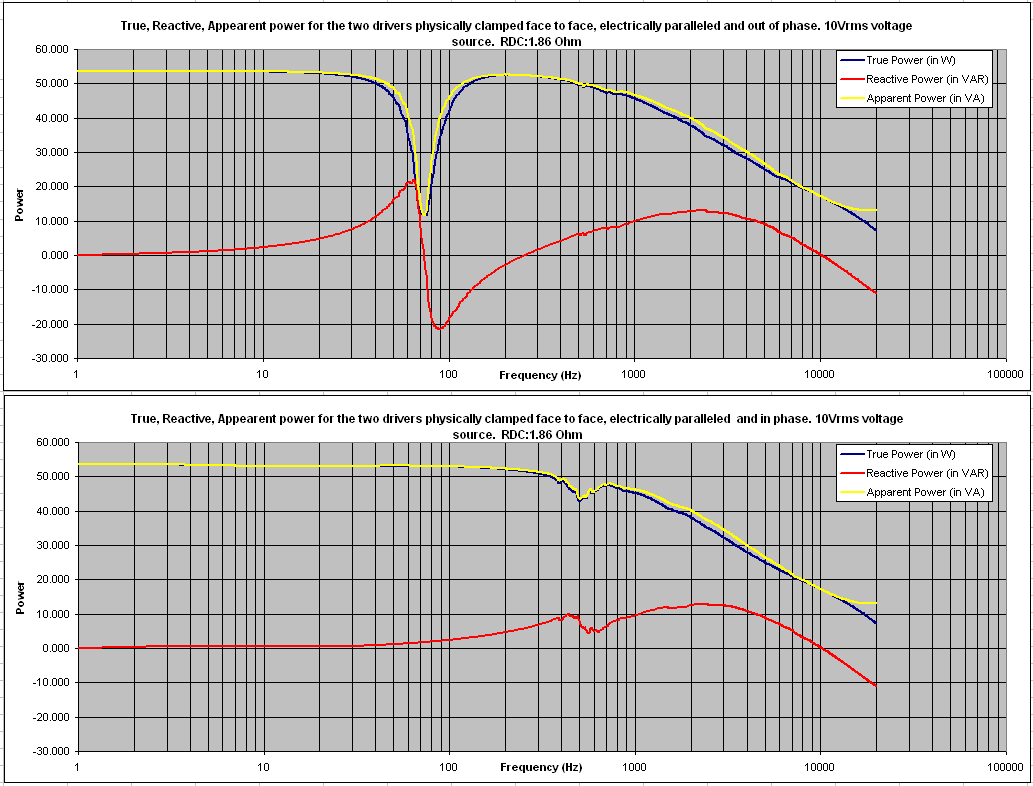

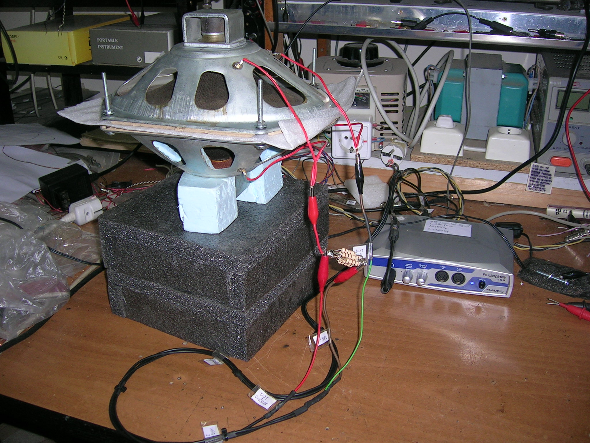

The same signal and amplifier was feeding both drivers in the physical arrangements and electrical connections I described.
I was measuring the impedance of the circuit i.e. of the two drivers.
Configurations IIIa1) and IIIb1) zero out the motional impedance on both drivers due to strong acoustically coupling (see attachment), being out of face acoustically.
Thanks George.
My concern is with the V/I space only. The acoustic mass/resonator system reactance above and below resonance is where the biggest problem lies AFAIK.
As to the bounds of the V/I space, the vc resistance does not necessarily define that. The model needs to include the energy return mechanism, which is through the inductor only..
For example, model a speaker as a 1 ohm resistor and a 1 henry transformer primary (1 to 1). With a signal drive into the system, say 1 hz, it's easy to calculate the current vs time.
Now, attach a source to the secondary, say 1 volt to simulate energy return due to reactive storage. In one phase, it subtracts from the source voltage such that the current draw is less (as in resonating), and opposing phase causes higher current draw. So it is easy to double the current using the return energy. The question is always, what level of effect will the acoustic mechanism provide.
I am not concerned with whether or not the current exceeds that which the DCR would indicate. I am quite concerned with the amp topology and it's ability to control the output when Q2 and 4 are involved.

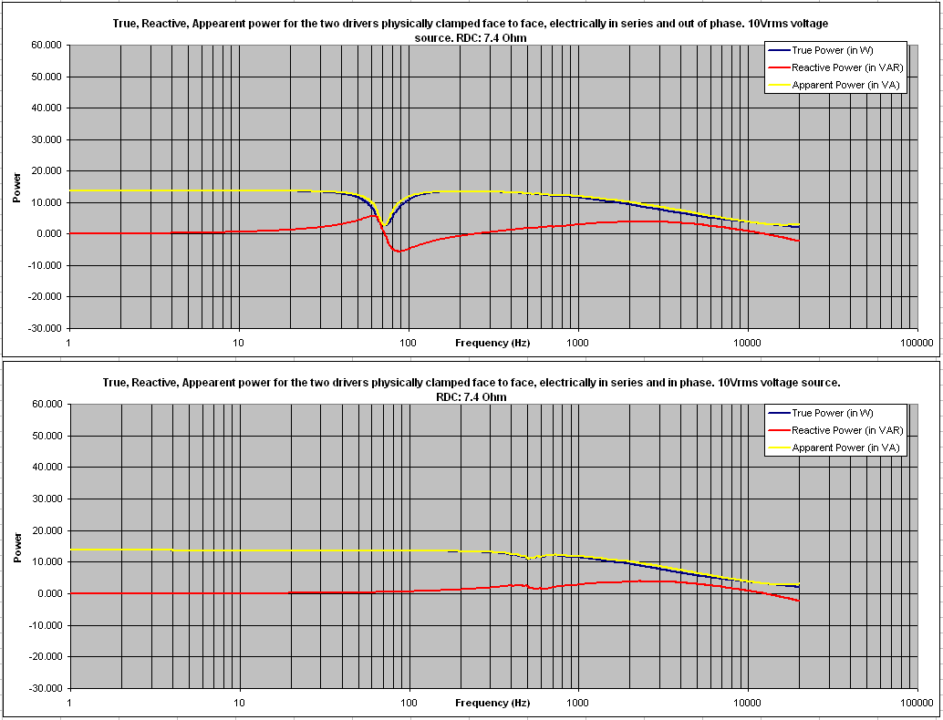

Common problems unite people 🙂
I am fiddling with the same issues. I agree with what you say in the two first paragraphs.
I will try to work the problem on a cycle base as you suggest
I attach results of power calculations, based on the data from impedance scans of the two elliptical drives.
The curve of reactive power shows the frequencies where power is consumed by the load (area where curve takes positive values) and the frequencies where power is returned to the source (area where curve takes negative values).
Does this returned power causes problems to amplifiers and how?
George

Red has the same profile as a phase response. On either side of the resonant point, power is send to and returned from the load, but the red above/below zero indicates when the return power is delivered, either before or after the drive signal.
My HP LCR meter does the same thing btw, when I'm in Ls/Rs mode. It will read positive inductive above resonance, and negative inductance below. It is being forced to look for inductance reactance, and a capacitive reactance makes it think there is negative inductance.
John

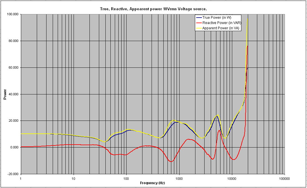

It seems to me that a PA would need to handle the current of just the voice coil R and not the min sine wave average Z value. For a pulse or step response, the current is max at t=0 which will be that which only the R limits to.
Richards
For a single driver with a benign impedance curve and no passive cross over in between, yes, the highest current demand is governed by coil resistance at very low frequencies. The inductive reactance of the coil which increases with frequency, reduces current flow progressively as frequency increases. See diagrams on my previous post # 79195).
However, this may not be the case when passive cross over elements are present.
See attached diagrams referring to a three way loudspeaker (*). Details for this loudspeaker are in posts # 78872 and #78903
http://www.diyaudio.com/forums/loun...ch-preamplifier-part-ii-7888.html#post4639290
http://www.diyaudio.com/forums/loun...ch-preamplifier-part-ii-7891.html#post4639978
George
(*) Ed , there is a real issue with the tweeter branch
