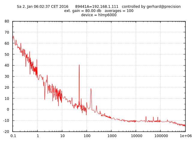

Interestingly, the quietest red LEDs I've found were the HLMP6000, which are pretty tiny. Lowest impedances as well, so there may be a relationship.
I've got some HLMP6000s in the meantime; order at digi-key in Thief River Falls to
delivery on the doorstep in a small town in Germany < 36 hours including customs:
pretty good performance. 🙂, and that on the 24th of december, just on the culmination
of the xmas parcel deluge.
Nevertheless, this is the noise performance (and methinks they are quite dim at 12 mA):
0 dB = 1nV/sqrt Hz. I like them.

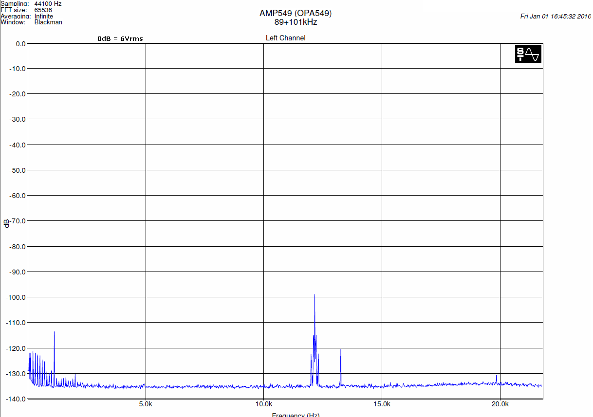

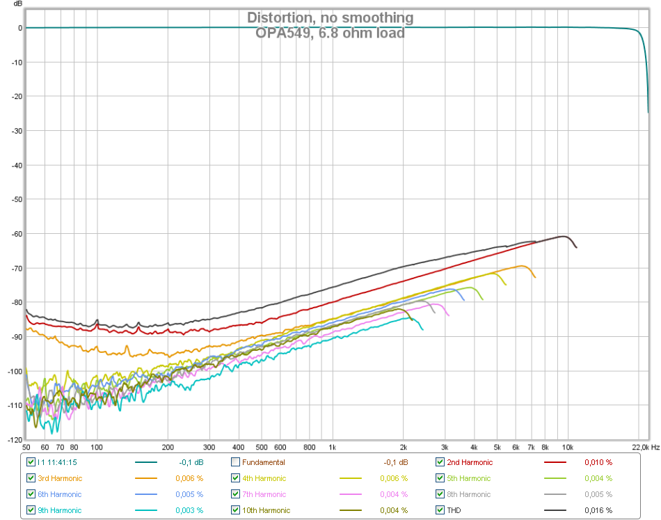

I think it is a forgone conclusion that with worse amp THD above 20KHz will do poorly inband in the presence of HF/RF. And, like the HF from an unfiltered HF DAC the frequencies are many and wide band... there would be many more IM products produced than a two tone test at HF.
I just culled some typical well known amp performance from Stereophile that people buy which fits the bill for higher audio distortion with HF.
I hope this one will meet your criteria for a sufficiently bad amplifier 😉.
Please note THD rising with frequency and also the distortion composed of high order harmonics - one of the best examples of cross-over distortion ever.
This is nicely seen at the 100kHz signal plot.
The intermodulations are worst when signal frequency is about 100kHz, when input RC filter is yet not effective. With my usual HF test 900+910kHz, this amp has no problems. But it has problems with intermodulations in the 19+20kHz test and here 89+101kHz is shown.
But I would say that most of problems of this amp lie in audio band, ultrasonic intermodulation is just a cherry on a cake.
Just maybe, its sound could attract some of the reviewers 😉.

If you get the time why don't you try overdriving an LED a bit until the light output drops and then recheck the noise level? I suspect there is a correlation between brightness and noise as you mention. Certainly between output and photo electric noise pick up.
