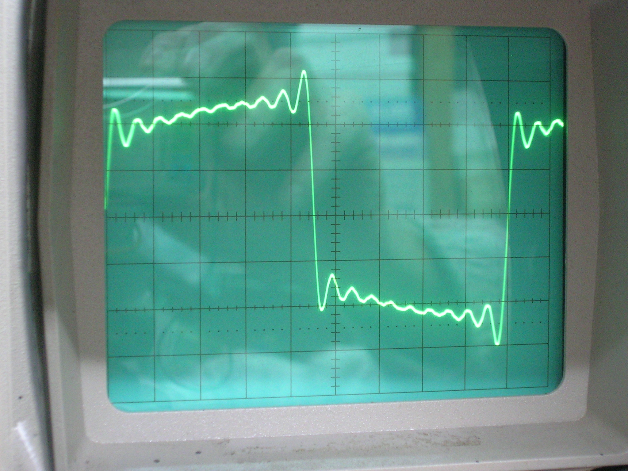

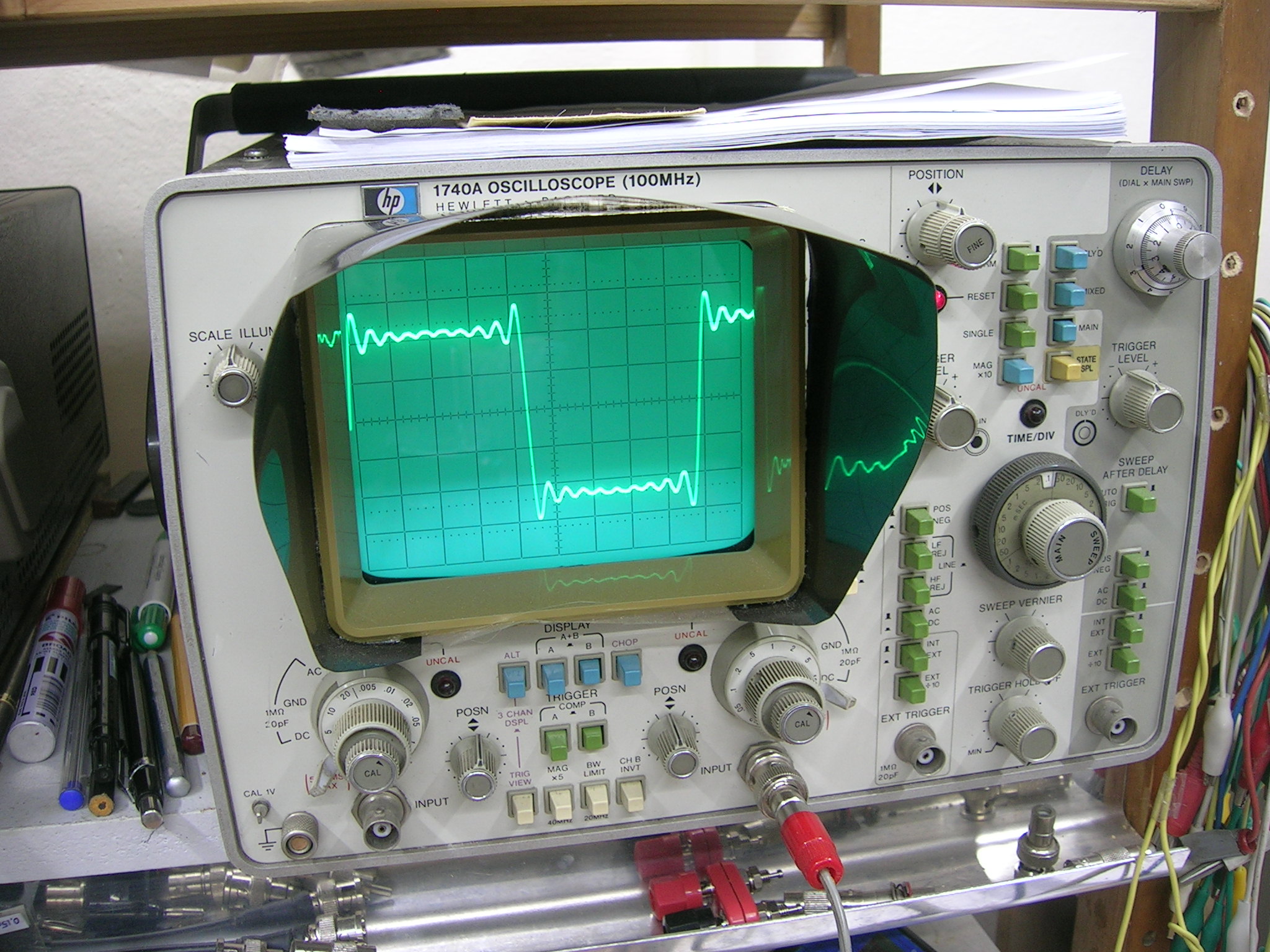

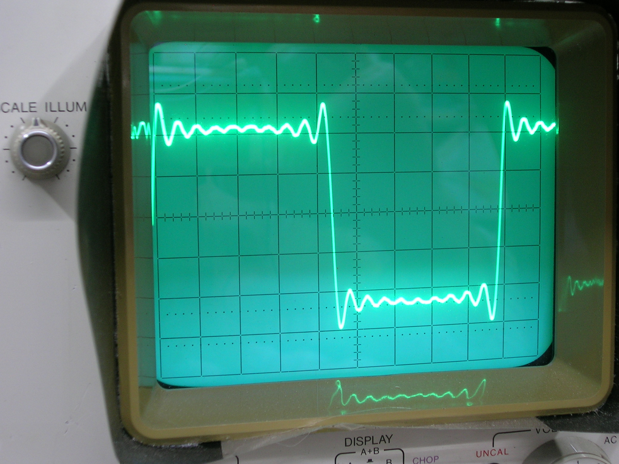

I burned on a CDR disk Pavel’s 1102.5Hz SQRW –2.5dB FS (see post #76930) and I played it on an old Philips CD 151(TDA1540+SAA7030 4x oversampling + post DAC 3rd order analog filter identical to the one posted in post#76934 only with LM833 in place of NE5532).
First two attachments are screenshots from a HP 1740A, (100MHz BW) connected to the analog out of the CD player playing Pavel’s SQRW

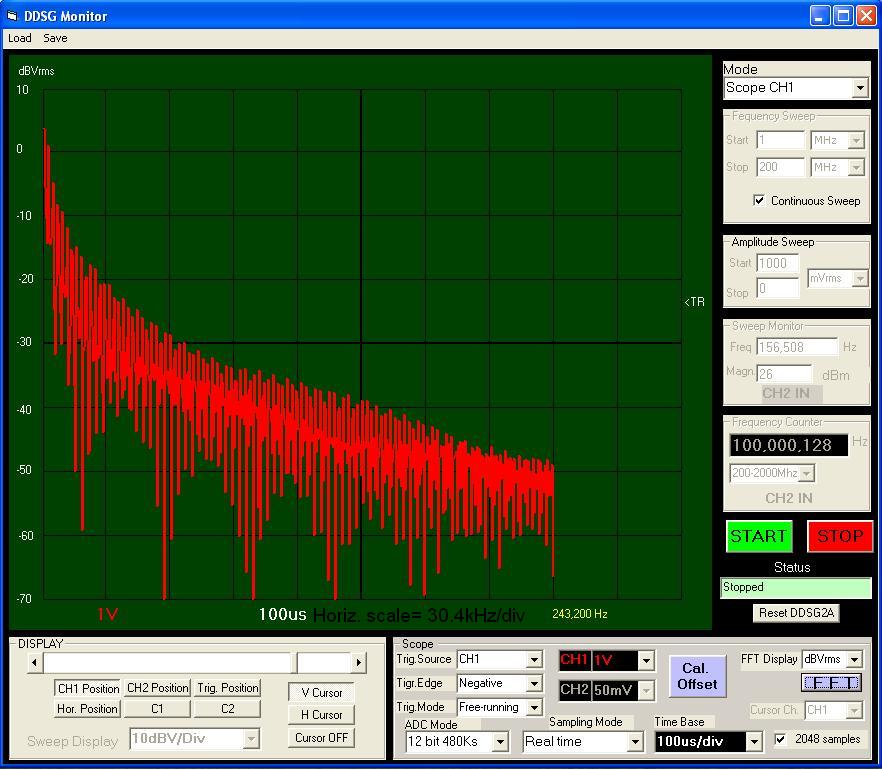

Third attachment is the spectrum of the CD player’s output while playing this track.
Forth attachment is same CD player playing a 1kHz SQRW –6dB FS generated through Wavelab at 44.1k/16bits. This shows a bit more extended BW (21 harmonics) compared to Pavel’s (19 harmonics) .

George ............................ Nice scope !
I've toyed with digital scopes myself .
They're so nice and compact .
And I don't think it takes long to adjust ones perceptions.
But for real intense wave inspection ?
I wouldn't want to try to set AB bias with one .
I now have a $150 SinoMeter that does way better
than most digital ( for my purposes )
Then there's the thought that if digital cannot render
a picture of a signal, how can it render the sound ?
( the ears being way more sensitive than the eyes )

... played it on an old Philips CD 151(TDA1540+SAA7030 4x oversampling + post DAC 3rd order analog filter....
George, while you're at it, can you play some full scale sine signal on that old beast and post a picture of output spectrum (including noise) up to, say, 1MHz?
Thanks,

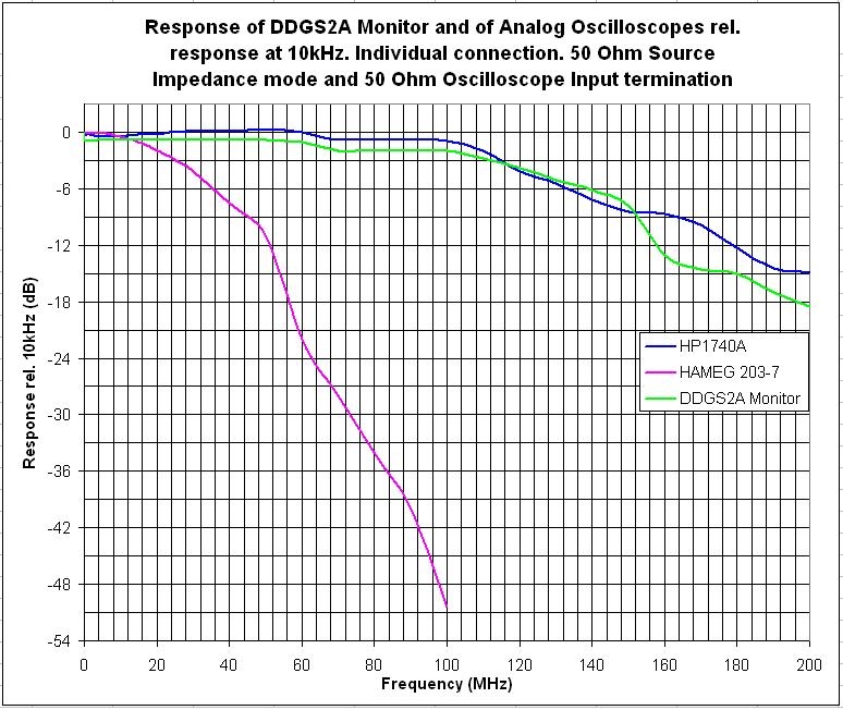

Michael it’s a beauty, I agree.
I am tempted to get a DSO myself for what they offer but I can’t stand the 8 bit vertical resolution and I can’t afford the price of the 12 bit DSOs. So I suppress the idea for the future.
I also don’t know how they behave close to the limit of their bandwidth.

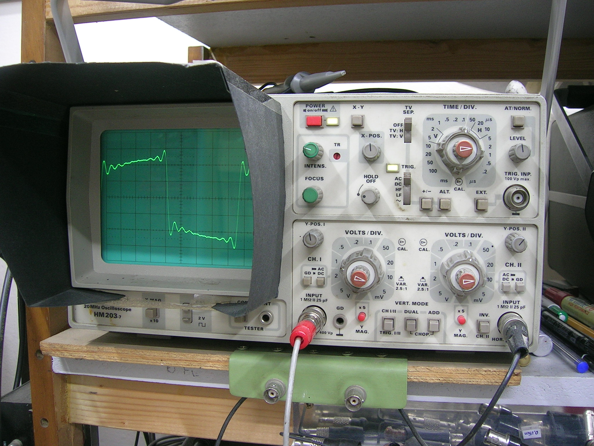

See how the same SQRW of Pavel is shown on the screen of a 20MHz BW Hameg HM203-7 (and it’s not malfunctioning)
