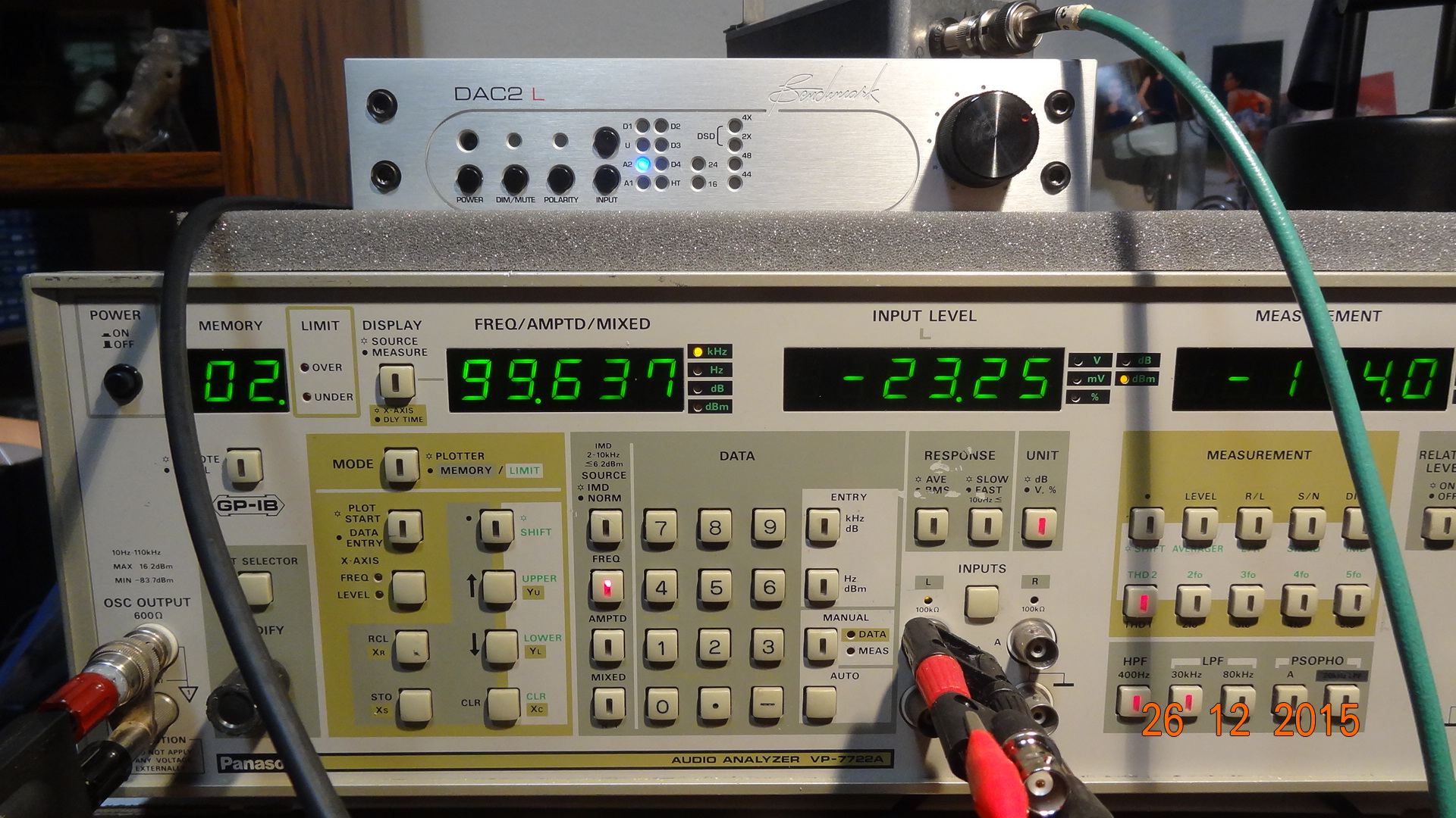

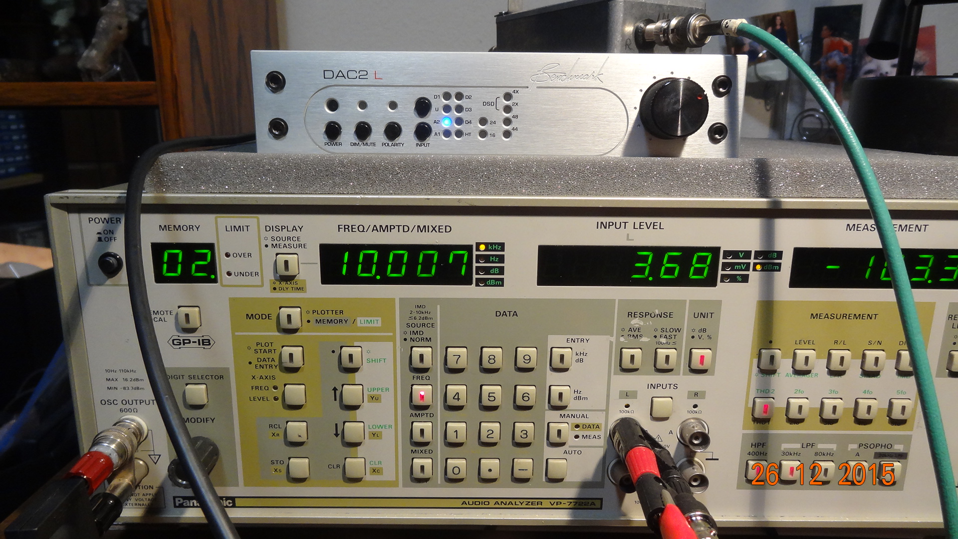

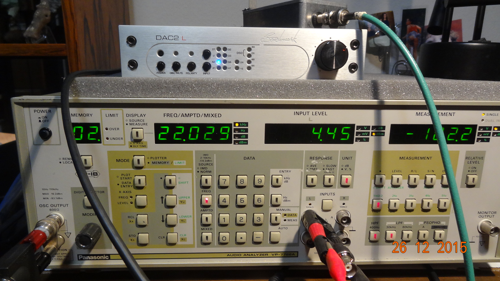

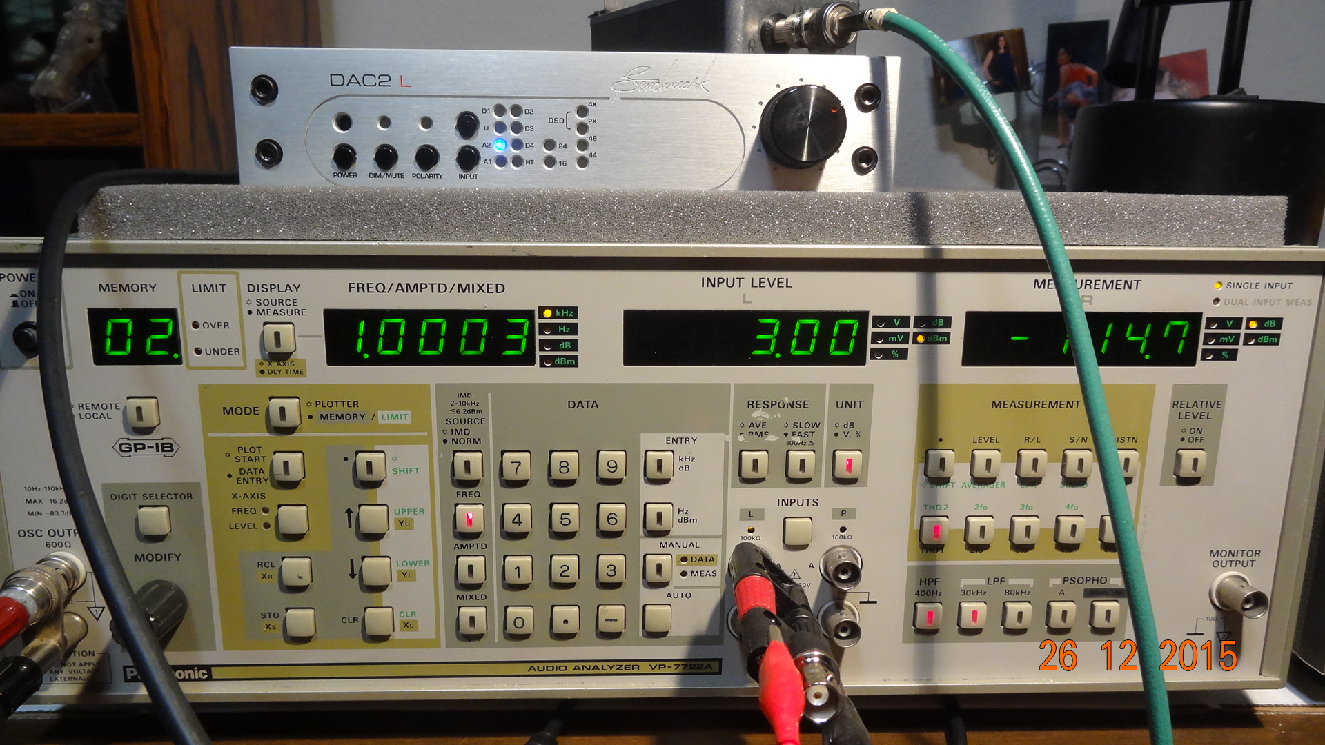

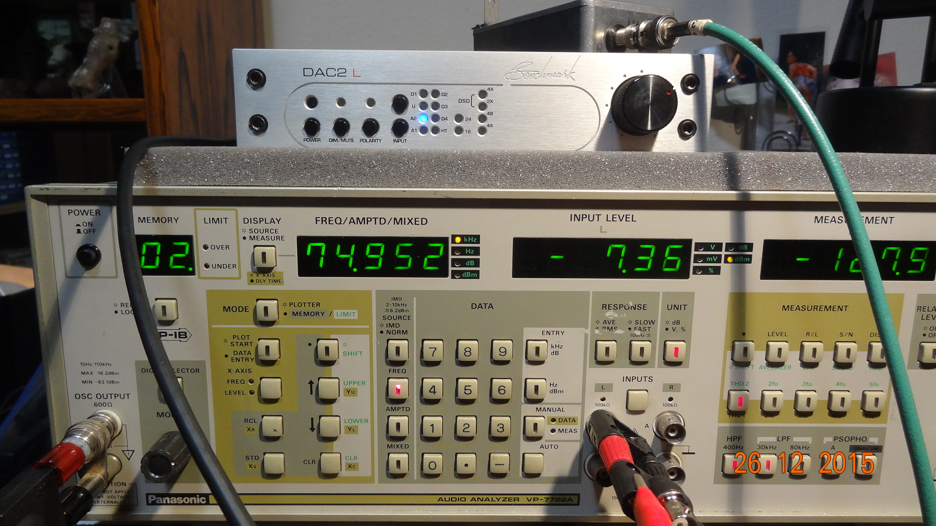

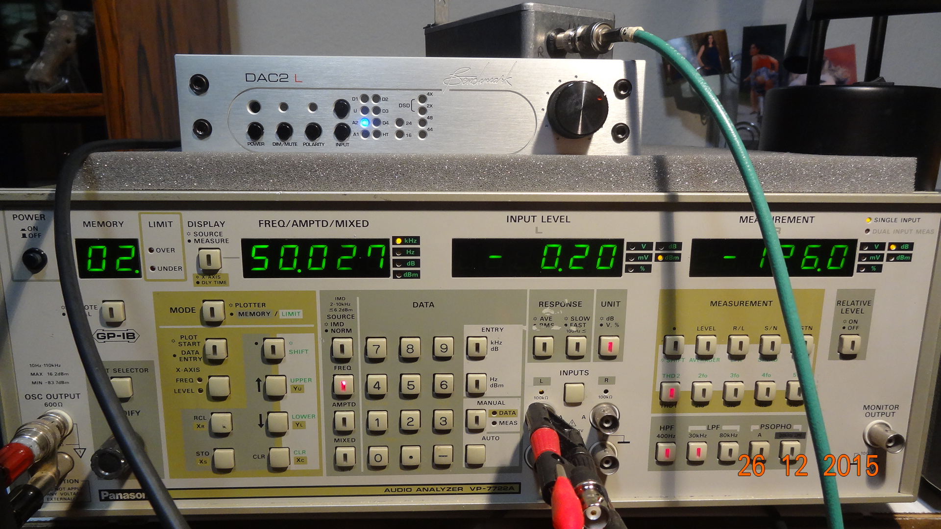

Well, it isnt so hard to test the filter to/thru the BenchMark -- it is the BenchMark analog input which terminates the passive filter we are working with. The CD player output thru the filter to the linear amp to its output --- and basically the HF filter follows the A-P curve, I showed;
I have set the line stage of the Markbench-2 to be +3dB at 1KHz on the analyzer display (just using its volt meter capability for this test.
More tests to do......
[Click your pointer on a picture to expand it.]
TH-RNMarsh
