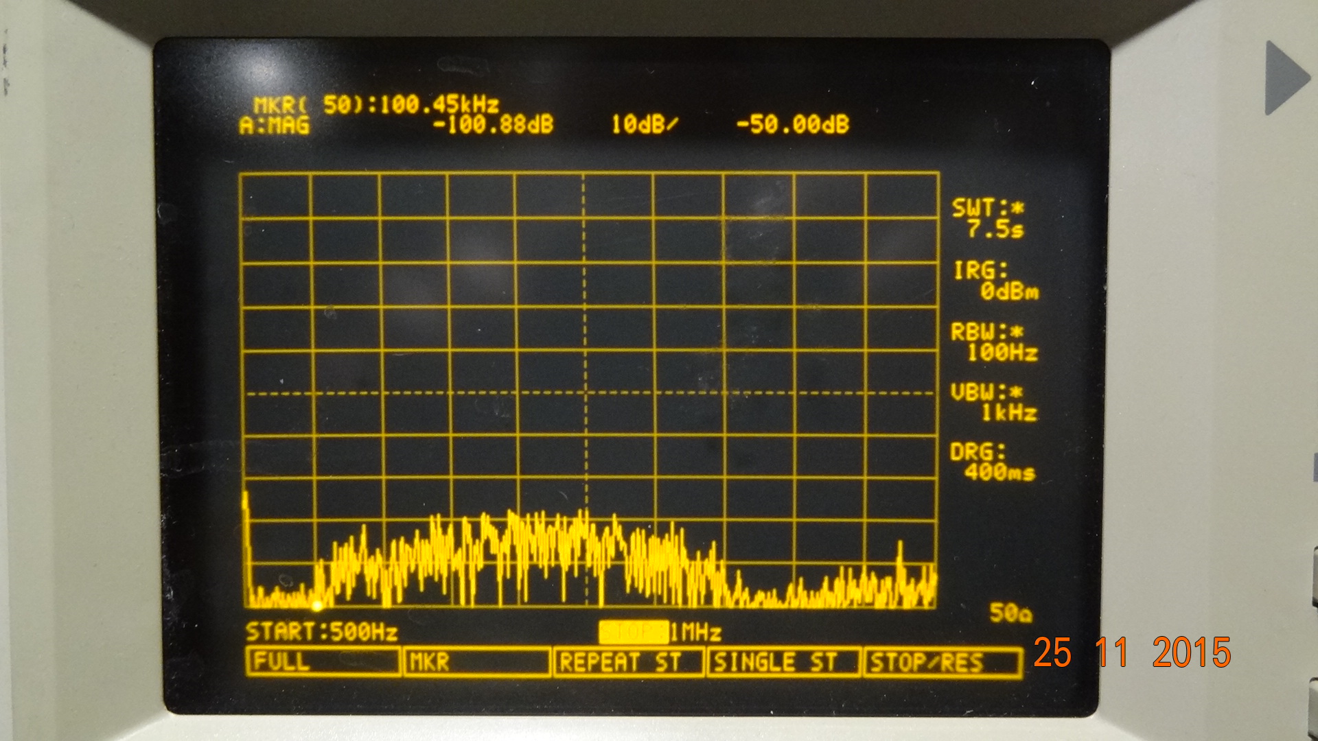

i don't want anyone to take the data shown too literally or to try to guess what the cause is. For one thing the signal has been attenuated 20X to prevent loading of the source. Same for this one here ......
Just after 100KHz, the noise level goes way up out to >500Khz. This is a BlueRay playing video test disk only and the output of one audio channel shown. The player also has an idle freq at 950Khz.
There is no broad band of noise freqs until it is in Play mode.
There are many, many out-of-band signal sources getting into our audio.... from the equipment itself onto the ac lines; thru EMI/RFI and digital and video gear. And, to some extent, every system is in a different environment. But, clearly the out-of-band energy ought to be addressed for analog signals.... if you want the lowest system distortion.

I would try a few ferrites (SMD 0603 for example) in series with the output - right at the connector and then from the connector after the ferrite a small cap to ground - say 100 to 200 pF.
Have you tried a common mode clam ferrite on the power cable? I lot of these BD players use SMPS that may be responsible for noise in the 100kHz to 1MHz region as well.

I think that's for resistors - the ferrite devices DC and LF resistance is extremely low - a few ohms. I am not aware that that is modulated by the signal current which should be quite low (uA range).
If you use an RC filter on the input that drops the 20,000 Hz by 1 dB what do you think it drops 90,000 Hz? 10dB? Not really effective.
More often than not, its HF very much higher up on F that is getting demodulated in the input stages that is the problem.
However, an RC pad on the input is a good thing. If you set it for c. 200kHz, you are only down 0.1dB at 20 kHz and 40 dB down at 20 MHz
Yes you've got it! Unfortunately AM radio starts at 540 kilohertz around here and we have 50 kW two miles away. The issue with RC is the series R adds noise and the C often self resonates. (Some power supply electrolytic's actually resonate in the audio band!)
The issue of attenuating just above the audio band effectively requires L & C if you want to do it passively. L comes with serious penalties, either over size air core and large loop area or distortion from a core material. So wider bandwidth in the amplifier and making it an active filter is one way to go.
Bipolar junction transistors as input devices can be a real problem, particularly when current starved.
So a JFET input with a wideband amplifier that has active filtering is one good approach. Of course JFETS are not where the money is for most manufacturers.
