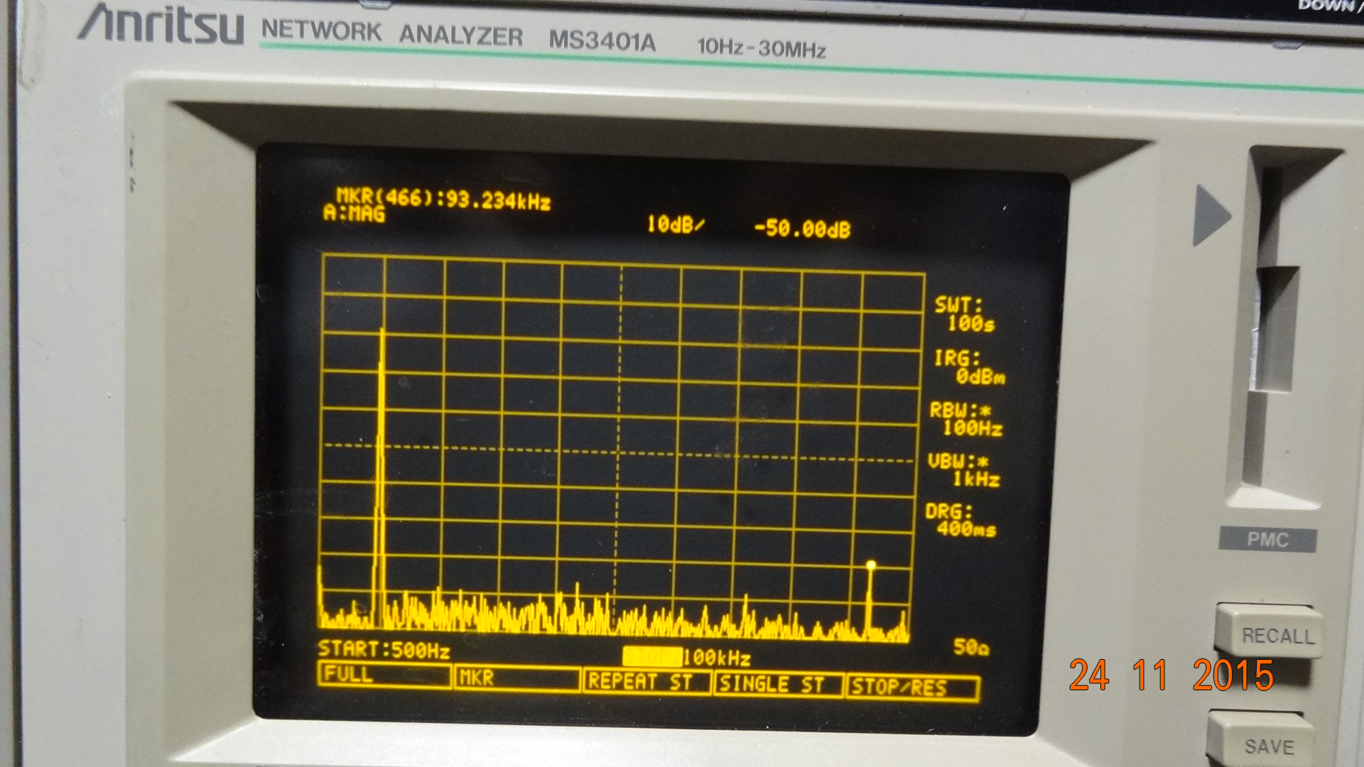

Back to out-of-band signals in audio ---- But not RF this time.
Some years ago, i saw a lot of HF idle tones out of a DVD player's audio output. Today I looked at a audio 'mastering' CD machine. It too has an idle tone which only shows up when a signal is being processed.
Now, in this one's level it is low and at 93KHz. But not all are so nice and to preamps and power amps with wide bandwidth, can there be distortion caused by attempts to amplify such out-of-band stuff?
D.Self showed that such freq coming in on the ac line and thru the ps to the amp did raise the measured audio distortion level.... and this CD player output is a direct path into the audio amplification chain. So? Better watch what is coming and going outside our 20KHz hearing range.
Funny, the peak is almost exactly the 6th (actually 5.97) harmonic of the PAL TV line frequency. Are you sure this is not coming from a multi system DVD player?
You mean i can't tell the difference between what equipment I just ran the test on?
There is no PAL in USA/California.
Thx-RNMarsh
Cool, CA.
If you dont measure this stuff and remove it, you might have audible consequences when amplifying it X times by pre and PA. However, it would be better not to use such equipment in the first place. But, you dont know what you are doing unless you look at/for it.
