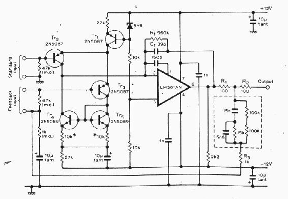

Below is the circuit as published by Taylor.
Hi Jan,
---I believe this scheme is a textbook scheme for an inverting opamp and isn't anything special or inventive.---
I agree, however I was unaware of its use in any commercial product till Audio1's post #733 told us it was used by Barney Oliver.
---I'm not familiar with that. Could you give me some more information on how I can read Mr. Taylor's article?---
Drop me an email.
Hi Jan,

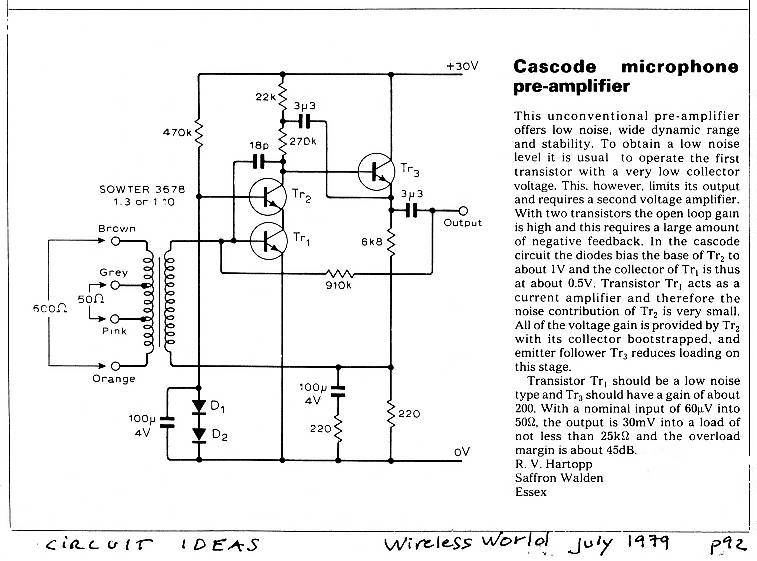

Two more inverting low noise circuits à la Taylor
1.
http://www.aes.org/e-lib/browse.cfm?elib=4959
AES E-Library
A Non Standard Op-Amp Based Mic Preamp Design Meets Studio Quality Noise Requirements
Contemporary transformerless mic preamp design frequently utilizes a state-of-the-art monolithic op-amp supplemented with the descrete input stage. This approach does provide an answer to op-amp's inherent noise problems, but it also violates some of its indispensible properties which opens a number of problems of different nature. The non-standard approach proposed in this paper however, copes with this problem by taking advantage of summation of the uncorrelated noise of n parallel conventional co-amps. This yields a substantial noise reduction, still retaining all of the op-amp's key features intact. Another advantage of this approach is statistical matching of some op-amp's properties thus making selecting obsolete, which can also be suitable for a higher volume production. The paper includes theoretical background with evaluation of some practical implications.
Author: Kovinic, Milan
Affiliation: institute of General and Physical Chemistry, Beograd. Yugoslavia
AES Convention:82 (March 1987) Paper Number:2470
2.
Hartopp

2.
Hartopp
