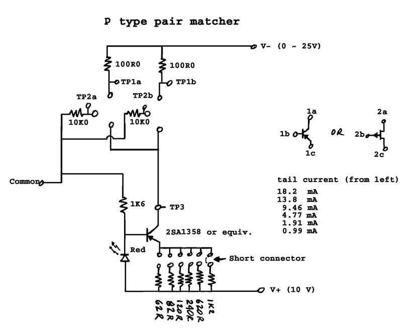

I use pair matching nowadays, REF + DUT, thermally coupled together.
That's the best way "I" can control temperature.
I also use CCS in the common tail.
If I have 7mA through the CCS and the two matched collector resistors drop the same voltage then I know that the transistors, both DUT & REF, are passing 3.5mA. That allows me to log the results for all my DUTs.
But usually the collector currents are not the same. So I batch them into similar groups.
Swap out the ref to a new ref in the group and retest. this finds the matched Vbe sets.
Now, this seems to be the point you have missed, I try to find matched Vbe that are close for hFE. In this respect we do the same. But I do it in the other order.
Why?
Because I found almost no correlation by selecting hFE first.
Yes, I add in a pair of resistors (an hFE jig) to measure base currents when doing the hFE comparisons, but I must still do this with REF & DUT + CCS otherwise temperature changes dominate the source of measurement error.
Finally, many are saying here that Vbe is almost the same when they check their DUTs.
How do they know Tj and Vce and Ic and Ib and Pq are being held constant and can they be sure that each Vbe that they measure has all these parameters held at the same values.
Take a pair of hFE matched DUTs.
Connect the bases and emitters and check how close the collector currents track each other when one KNOWs that Vbe is identical. I was surprised the first time I did this. That same day I was following precisely the jig that Anatech recommended and then deliberately shorted out the base resistors. All the matching went AWOL. One or two mVbe difference makes a big difference to the collector current. Even tenths of a mVbe make an easily measurable difference.

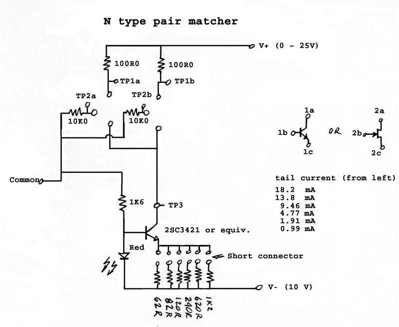

I have mentioned this before, and I have posted the circuit a couple times as well.

Sure, this is the first part, attached.Can you please re-post the circuit?

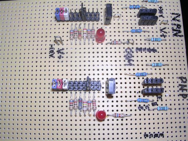

And now, what it actually looks like. It's very crude, but it really works well. I use it far more than I thought I would, so I need to build it properly at some point. I will use the parts I matched again, no use wasting them. They were matched using an HP 34401A and a 4-wire probe setup (nulled) with many averaged readings. Since this is a relative match, the accuracy is very good. I think I'll use the HP 3457A next time, it might do better measuring resistance (again using a 4-terminal, or Kelvin, connection).
Go ahead and build it, it should be easy to do a better job than I did. Note that both the N and P versions are connected together using the same supplies. Makes life a little easier for me.
Now, I should mention that those headers and jumpers set the tail current, and they are additive. The currents are not exact, so I measured them. Maybe I'll become prissy and get the values dead on - maybe. It's not that important really, just measure what the actual currents are so you know.
You will also see that I used 4 terminal in-line sockets (pcb headers) in order to accommodate both US and Japanese transistor pin-outs. Pro-electron pin-outs are a mix of the two and may need to be rotated 180°. Mount the two parts in contact with each other and use a foam cover to shield from air currents and hold the parts together. This thing is extremely basic, so you can add features on the idea (like uP controlled current and voltage + data collection).
A later addition to this perf. board is a jig for matching FM I.F. ceramic resonators, complete with buffers and controlled impedance. That darn perf. board is becoming valuable to me, and crowded too.
Should I build all these jigs into one enclosure, or separate boxes? Darned if I know. The one message is, just build it. It doesn't matter how ugly it becomes, build something and learn!
-Chris

Hi Joshua,
No problem, and my pleasure.
The only thing you have to do is wait for the pair under test to settle down. Time. It would help if you didn't handle the parts directly so they don't heat up, or cool down as the case may be. How hot is it normally there?
I'm open to comments or questions for help. Some people out there may be able to look at it and see if there are any mistakes in method. Whatever helps everyone out is fine.

hi Chris,
you are a breath of fresh air, not afraid to sketch, knock up and show the 'perf board jig. here. you comments are straightfoward no nosense.
you comment here is classic
''Should I build all these jigs into one enclosure, or separate boxes? Darned if I know. The one message is, just build it. It doesn't matter how ugly it becomes, build something and learn!''
my advise is dont get fancy with it, no box, why bother? if the thing works great throw it in the storage box (s) marked 'jigs'. along with the other hundred or so.
my justification for this attitude is, i know i could improve on it and make it look proffesional but hey im not designing for HP. just for me.
one very important thing is to tie a lable on it, cus you are bound to forget what it does in a few years and keep the drawings etc safe. just like i do, not. 😕
