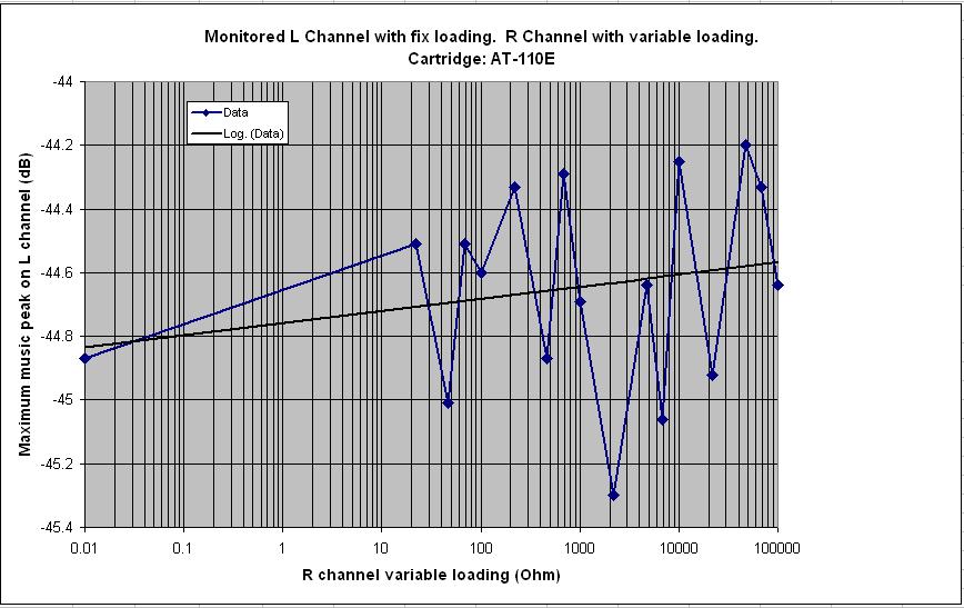

As for the electrical to mechanical efficiency (reciprocity as you say) of the cartridge, I don’t know how to set up a good test for this.
I only did the following with the AT-110E:
Left channel loaded with 100k, Right channel loaded with variable loading to examine damping imposed on monitored L channel (record content: music)
As you see on the first attachment, there is almost no damping with this cartridge. The trend line shows a miniscule effect.
But I would say there is no damping at all. This is why I say this:

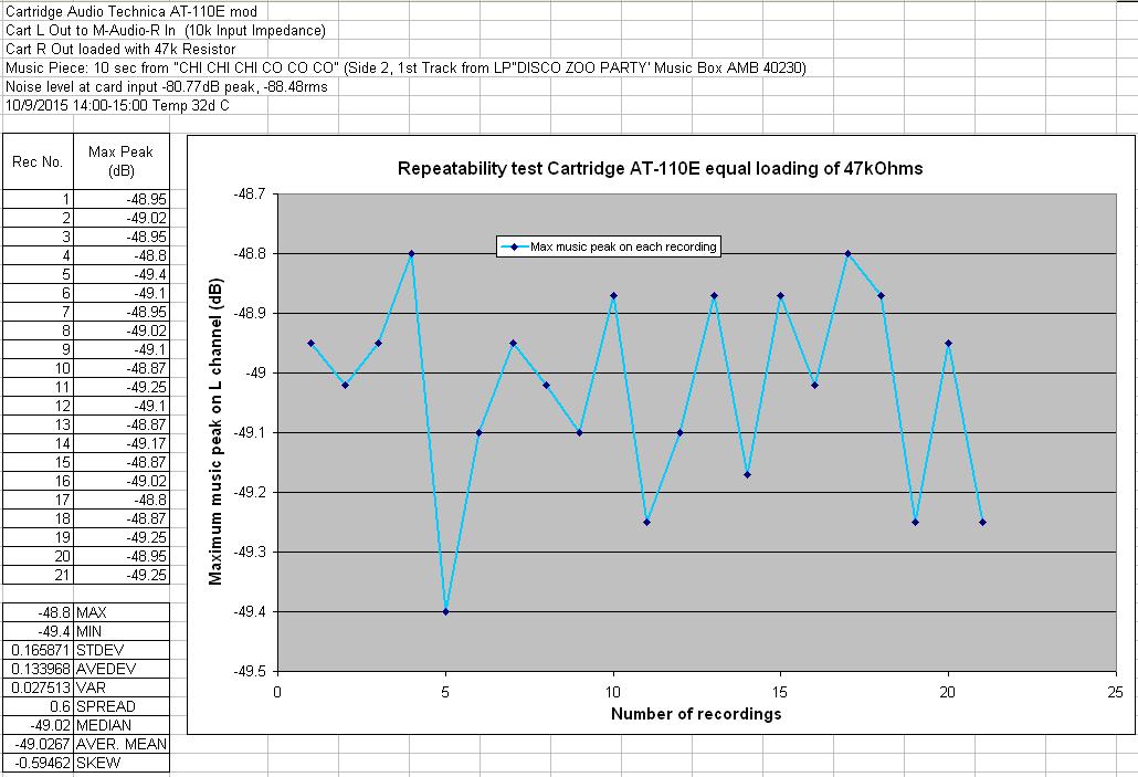

Prior to that test, in the beginning of this whole trial, I had I run the same musical track twenty one times (but with different loading and no buffer) for to check the repeatability performance. I had the software monitor the max peak on each recording. Plot of these figures and the statistics is on the second attachment.
George
