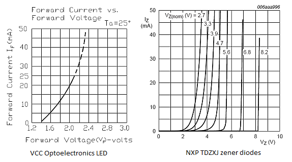

For some red ones the temperature coefficient of forward voltage is a good match to a silicon transistor's Vbe, hence making simple and stable current generators possible.What is the reason to use LEd in place of zener diode? The LED doesnt have a steep V-I curve. As a regulator or constant voltage source, the LED is not very good.

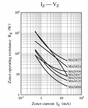

The LED seems like a cheaper alternative only. But with reduced performance as a regulator. Noise of zener can be very low... dynamic Z of 10 ohms and if suitably bypassed isnt noisy.
The TempCo of +2mv/K and low noise can be found in zener around 5.6 - 5.9v.

You want minus rather than plus 2.2mV/K for the particular circuits, so a lower voltage indicated. But although not bad, and helped in the current generator app due to higher voltage across the emitter resistor, the noise is still much higher than a red LED. And that's without any capacitor's bypassing.
Plus and neg TC can be had with zener, of course. The zero TC is around the 5v level. It doesnt matter that an LED may be quieter un-bypassed. Bypass the zener. And, have a higher performing volt regulating function.

Not at forward voltage range where zeners and LEDS might otherwise be considered similar, as used in bias apps for example. Often the exact convenient forward voltage drop is the deciding factor in choice of diode, subject to correct tcoeff IME.Plus and neg TC can be had with zener, of course.
At 10mA current, an HLMP6000 red LED has about a 3R impedance. Cheap surplus red LEDs clocked in at about 4R5-5R. I measured about 10R slope resistance from the 6.2V Zeners I have on hand, so normalizing for voltage, the slope resistance is a wash.
What's the size of a cap that would have a significantly lower impedance, which is the point of bypassing? Quick calculation- to get a decade lower impedance from the Zener, you need 1R in the bypass. Putting aside subsonics and ignoring ESR, at 20Hz that's about 8000uF. Is that a practical solution?
I see your point . However ignoring ESR then how is 8000uf the solution . ESR is a major factor at 1 ohm total system impedance . The point that the cap is going to be large is not lost though . That is not the most cost effective method.At 10mA current, an HLMP6000 red LED has about a 3R impedance. Cheap surplus red LEDs clocked in at about 4R5-5R. I measured about 10R slope resistance from the 6.2V Zeners I have on hand, so normalizing for voltage, the slope resistance is a wash.

The most cost effective is the LED for a regulator. And, they can be quiet. The example (6.2v) zener at 10 Ohms Z is fine IMO. Esp for line level or PA circuits. I would use an LED with a CCS as others do. But then costs are higher. Which brings you back to the single part - zener. Its all a wash Except the zener regulates better than an LED.
If you want both better volt regulation and lowest noise.... use a CCS+zener followed by a Cap-multiplier.
