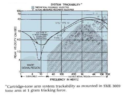

Their measurements of peak recorded velocity are interesting too.
Looks like a MM preamp can expect to see close to 100mV peak input in the treble, even without clicks and pops.The shaded area at right represents recommended theoretical limits of record cutting velocities. The scattered points are the "hottest" recorded velocities actually measured on difficult-to-track records.

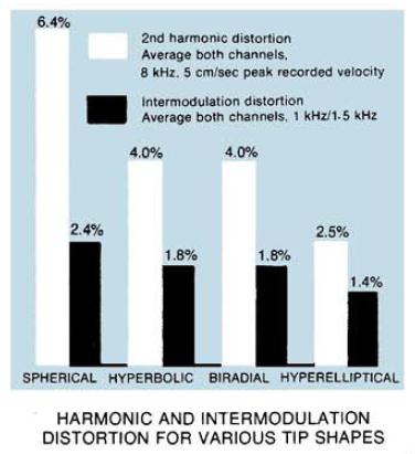

Output voltage is usually specified at 3.54 cm/second but as can be seen from the graph for Shure V15 Type IV, output can be ten to thirty times that high. (Hopefully the power supply to the phono stage can handle that into the next stage input load without being loaded down itself.) Typical outputs for MM carts at 3.54 cm/second range from about 2mv to 10 mv while MC cartridges are about one tenth that except for high output types.
It would not surprise me if the results of most calculations are orders of magnitude in error due to oversimplification and the wrong parameters, even the wrong equations. A figure of 4% to 8% combined THD + IM + noise for the best cartridges is not the least bit surprising to me. And this is just for the phono cartridge, this doesn't include the microphones and loudspeakers. (Dr. Bose said the threshold of hearing non linear distortion is about 6%. ) And while linear distortion can be compensated for in the playback system, once non-linear distortion arises at one stage, there is nothing you can do to remove it in a later stage, you are pretty much stuck with it. The attempt to build a one size fits all phono stage given the number of variables seems like an effort in futility. But then some people enjoy banging their head against a brick wall I suppose.
By comparison, the equivalent for even cheap Redbook CDs is a small fraction of one percent. This is one reason why I consider vinyl phonograph records to be donkey cart technology. However, people do pay money to ride in a horse drawn carriage through Central Park on a nice sunny day.
