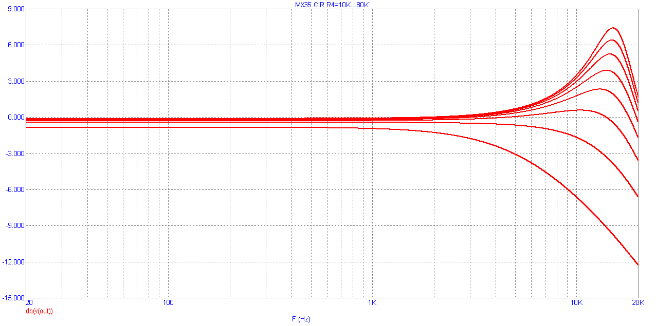

Just to finish my 'lecture' on how to make a simple, effective preamp for a Shure moving magnet cartridge of today. Well, the Shure best audiophile cartridge for sale today from Shure has an inductance of 650mH and a series resistance of 1.5K ohms. NOW, does quibbling about 200 ohms and 600 ohms seem rather trivial? I would hope so.
Now, what about voltage noise in the IC itself? Is 8nV/rt Hz too much? Would 5nV/rt Hz be really that much better? Let us add the noise contributions up and see.
We now have: 600 ohms (feedback resistor, worst case), + 1500 ohms from the cartridge making a total of 2100 ohms, or 1700 ohms in Joachim's original case to 4000 ohms that would be the equivalent noise of the 4134 that I first selected. So the total noise would be the equivalent of about 6000 ohms (+100, -300 ohms) depending on the RIAA network scaling. In other words, Joachim and I were debating whether a 0.3dB difference in noise was enough of an inprovement, when the IC got loaded with 3 times the output load to get it. Well, is it worth it? Maybe the IC deserved a lighter load, just to keep it happy. The second problem, that we can only hope to minimize is the need for roughly equal impedance loading on both the + and - inputs of the fet IC op amp. Everybody interested, please read both the detailed spec sheet of the OPA 4134 and the OPA 1644 to understand why this is important. Well, 600 does NOT match 1600, but it is a better fit than 200. See my point? Or am I going too fast for you?
Now, what about the OPA 1644? Well, it looks interesting. Is it commonly available, what packages? Darn, would I have to go to surface mount exclusively. What is its advantage? Somewhat lower noise, the equivalent of a 1.6K resistor. Now what is the difference in noise with RIAA scaling? Well, it is 1.6 + 1.7, or 1.6 + 2.1
These total 3.4 and 3.7 respectively. Take the ratio, square root, and convert to dB.
We lose 0.75dB in S/N with 1/3 loading of the output stage. Do you see the tradeoff? The caps get smaller and cheaper too!
Now I did this 'on the fly' at my keyboard. I could have made a mistake somewhere. I will gratefully accept any correction from you eagle-eyed critics out there, but the point that I want to make, has been presented. Enough said.

"Just to finish my 'lecture' on how to make a simple, effective preamp for a Shure moving magnet cartridge of today. Well, the Shure best audiophile cartridge for sale today from Shure has an inductance of 650mH and a series resistance of 1.5K ohms."
Excellent point. That the optimal design of the phono preamp stage must take into account the variables of the electrical characteristics of the source impedence and be able to be a correct match to it. Since when taking the cartridge, tone arm wiring, and interconnect wiring into account the number of permutations of these parameters can get large, it will take a lot of research or some other clever method to cope with it. But I'm certain that your $40,000 version will solve this problem handily. :worship:

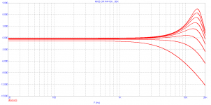

First, take into account cartridge load resistor (and parasitic capacitances). The 47k is not any cure.

The LCR circuit model gives the predicted result. Ironically it is exactly the same ordinary second order differential equation that is Newton's second law of motion which predicts the mechanical resonance model. When solved for forced oscillation that result will tell you exactly where the mechanical resonances will occur and how large they will be. Correlation between the model and actual experience is excellent and has been demonstrated for nearly a hundred years for the electrical example, far longer for the mechanical example.

To continue, the Shure cartridge and many like it, use both a mechanical resonance along with the electrical resonance (47K, 650mH, and 200pf) for example to make the flattest response when added to the relatively undamped mechanical stylus mass, contact surface area and vinyl springiness. A VERY FLAT frequency response to 20KHz and sometimes beyond, is possible with this approach.
