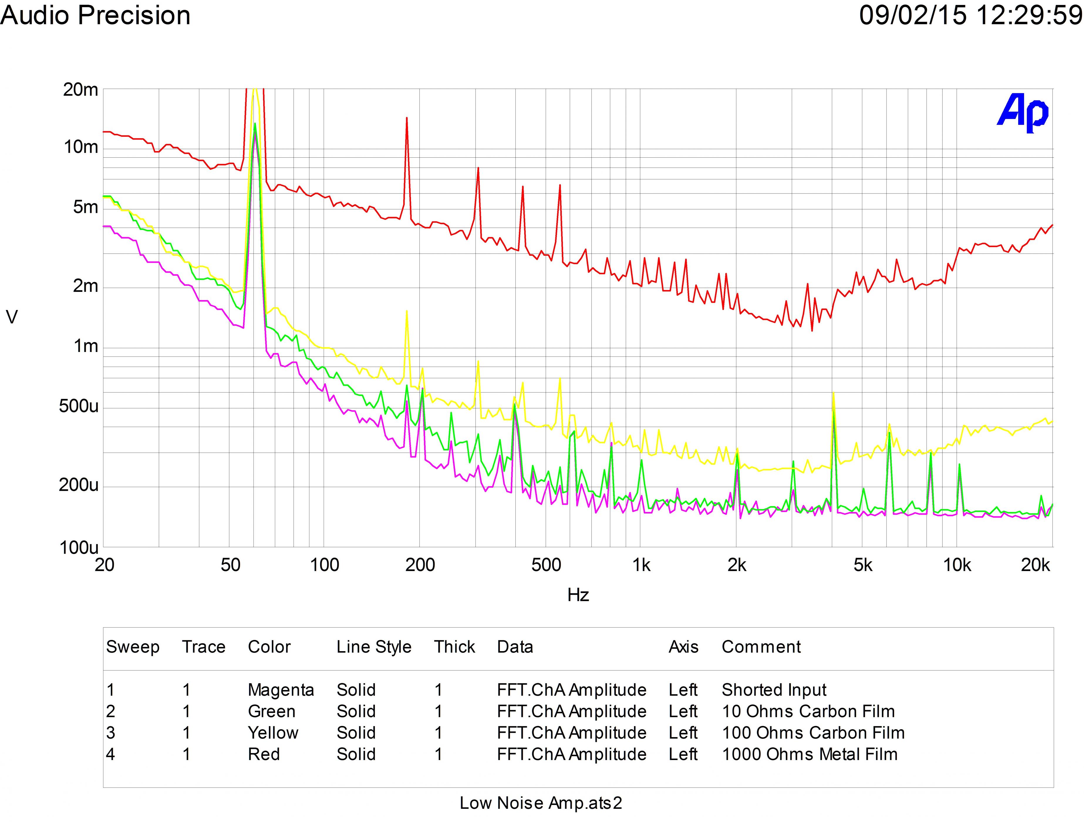

I just tried out my low noise amplifier. A few tweaks to the original design. Input amps are now LME79740 and second stage NE5532.
Shown are the input shorted, with 10, 100 & 1000 ohm terminations. Powered by 9 volt batteries and no case. Should be able to improve this by at least 3 and maybe 6 db!
