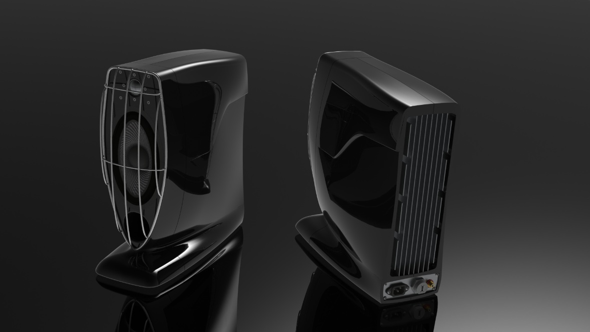

SE,
I thought you saw my speaker design idea already? I'm going to do another grill as an option for those who don't like the wire form, the same shape with a normal grill cloth. About 10% of the people who have seen this don't like seeing the speakers themselves. I also removed four of the screws around the tweeter, I can't get rid of the four in the center but did the outer four.

Nice, my son wants a set.

No, I don't recall seeing that particular design. Very nice! Is that amplifier heatsink I'm seeing on the back?
se
Yes,
That is the heatsink, as large as i could fit. I could make the fins deeper if necessary but think it should handle the power requirements.

The best one can hope for is what Kindhornman is designing, as an active loudspeaker where the distance needed to connect the power amp output to the loudspeaker driver is like 5 cm, or 2 inches. That's as pure as it gets.
Unfortunately, the only way to really know is to try it in situ.
dvv,
Yes that will be the final arbitrator is when it is finally powered up. Moat of the time it should just be loafing along, but those times when someone really cranks them up will be the test or I guess the 1/3 power testing.
1/3 power is absurdly brutal, but it's what Atkinson likes to do, so one must be prepared.dvv,
There have been a number of products reviewed and tested in SP that failed during the 1/3 power preconditioning---even some touting fancy-tech heatsinks. Some old Harman automotive products had thermal throttleback, but if one wasn't careful sometimes it just made things worse.
