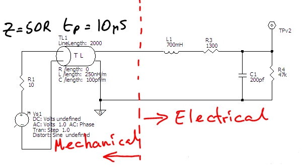

Yes, propagation of flex waves along a cantilever can be modelled as a TL. The idea that the cantilever moves as a single body isn't very true, depending on driven frequency - same as lumped electrical model of a long cable isn't always very true.
Below is a sketch schematic for spice model of a complete MM cartridge, from which one can get the gist. Kick it about, develop it, the reciprocity isn't very accurate, but otherwise it's surprising and enlightening about how mechanical and electrical systems mesh I think. Somewhere there's a reasonable model of a complete At440mLa......or was it a dream ?
This has been the most productive side discussion in a long time. So in the T line model you scale the length by some thing related to c/v where v is the speed of sound in the cantilever?
