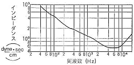

Applaud the effort, George - however the mechanical impedance does not arise from inertia or mass equivalent of the stylus. I hope I can explain..........
Let's put aside effective tip mass for a moment.

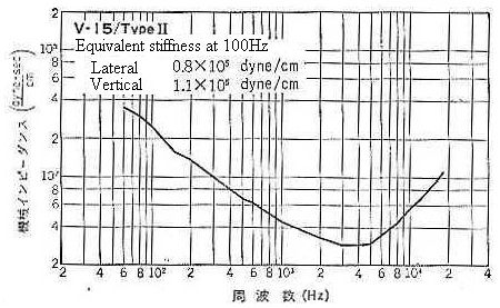

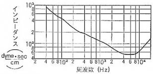

In the bigger picture, if it were not for mechanical impedance to motion of the stylus, there would be no need for downforce to keep it tracking groove motion. Then, it is possible to determine mechanical impedance versus frequency from measuring the limit of trackability velocity versus frequency, and this is what was done by manufacturers back in the day. There were published mechanical impedance curves for some cartridges, I've attached an example for a Denon DL103.
By reading the mechanical impedance curve, one can readily obtain mechanical power required to move the stylus at any given velocity and frequency. This is the best way to evaluate mechanical power involved in stylus movement. When we do this, we find it works out perhaps a few mW typ at 5 cm/s 1kHz.
Returning to effective tip mass, in principle it is what determines mechanical impedance at high acceleration, ie high frequency, the right hand part of the impedance curve. HOWEVER, the method typically used by manufacturers to determine effective tip mass is seriously flawed and does not correlate well - it assumes vinyl is springy and then determine e-mass from the mechanical resonant frequency always observed in the cartridge frequency response. Whereas this resonance can be that of cantilever self flex, not related to vinyl spring-tip e-mass system at all. Poor correlation obtains from using published tip mass as a figure of merit then, other than to locate the frequency of the mechanical resonance - it is useless for evaluating mechanical impedance and power for example.
Best to use the published mechanical impedance curves then, eg in the example below. So, for MM, typical power conversion ratio when loaded at 47k works out about -45dB or about 0.002% (NB that is a power ratio).
Edit: also added a published Shure V15 cartridge mech impedance chart
Where have reviewers like this gone?
This seems to agree with the above ~40 mechanical Ohms in the critical band. Is that right?
