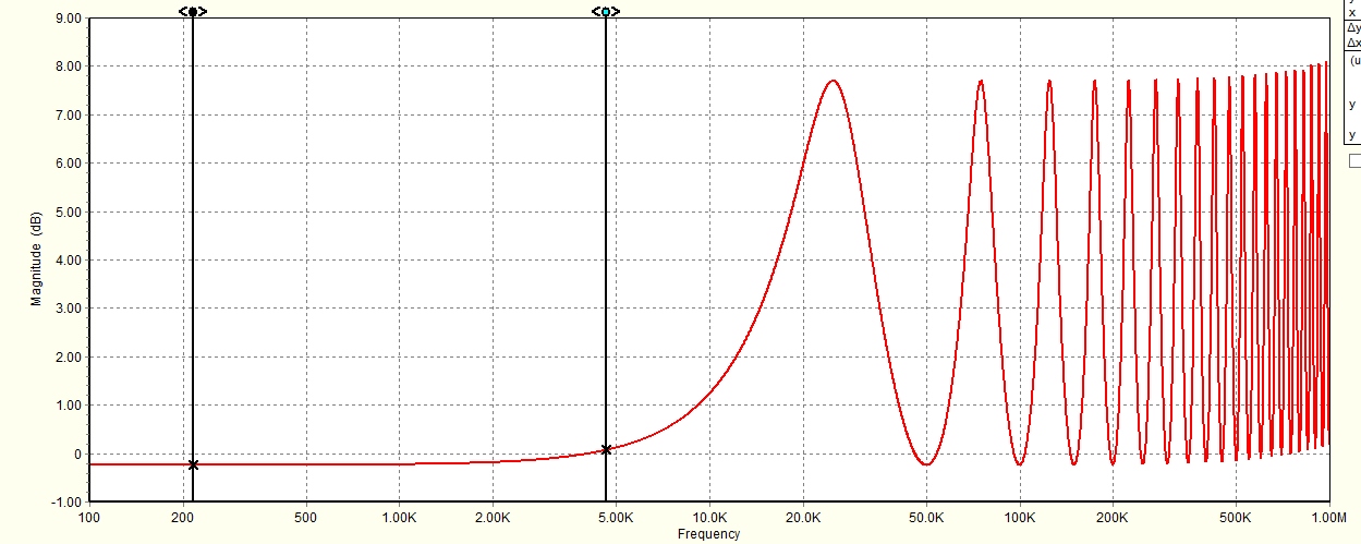

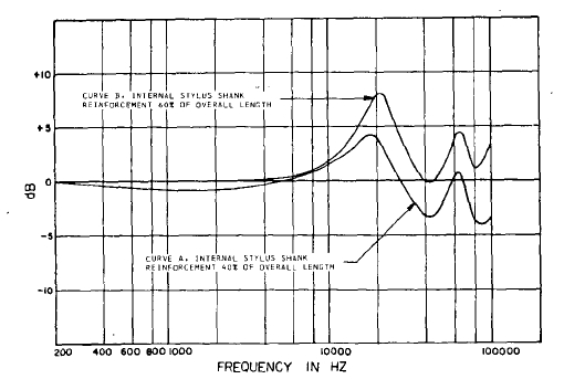

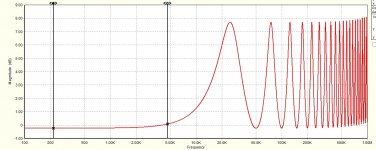

No, to make it conform to the RIAA, you must let the mechanical resonance fill in for the roll-off caused by the electrical resonance. The right combination makes for a flat response.
Here's a couple of illustrations of just the mechanical response. First is from a Happ/Shibata (IIRC) paper, second is my own simulation which shows a full series of Eigen resonant peak/troughs. The Happ/Shibata image just shows the first two. Only the first one typically affects the audioband, though the 2nd could be a nuisance for quad carriers.But I have no idea what the mechanical resonance does to the response and if that is significant enough to be of concern. Does anyone bother with a parametric to deal with this?
Common wisdom and lore has it that the resonant system comprises vinyl spring/tip effective mass. However, that is contradicted by the presence of a series Eigen resonant peaks. Whereas self-resonance of the cantilever by way of flex has the correct form and simulations fit - this is far more likely in my view.
Yes, the 1st peak of the system is generally arranged to augment the natural post resonance roll-off from the LCR so as to extend hf response for MMs. In MCs the resonance is arranged to be damped, but often shows up as a peak in the upper hf part of the audioband, and a second peak in the ultrasonic range.
