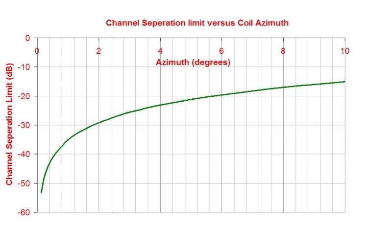

The xtalk graph is interesting - equal xtalk L>R and R>L is at 1 degree angle of the cart, but lowest is at about 1/3 degree angle. Question is: how is this related to the actual angle of the stylus? 1 degree difference between vertical stylus and horizontal top of cart body seems not unreasonable but it does mean that leveling the cart body in the hope to set the stylus exactly vertical is not always good.

Crosstalk depends solely on coil azimuth, not on stylus azimuth.jan.didden said:The xtalk graph is interesting - equal xtalk L>R and R>L is at 1 degree angle of the cart, but lowest is at about 1/3 degree angle. Question is: how is this related to the actual angle of the stylus? 1 degree difference between vertical stylus and horizontal top of cart body seems not unreasonable but it does mean that leveling the cart body in the hope to set the stylus exactly vertical is not always good.
Optimal crosstalk is a very sensitive setting, have you already seen this (calculated) plot for crosstalk versus coil azimuth which illustrates this sensitive relationship: ?
http://www.diyaudio.com/forums/atta...608193-vinyl-coefficient-friction-azimuth.jpg
Stylus azimuth, on the other hand, affects performance in many and various ways by influencing stylus-groove friction. Coil or stylus, it's often a trade-off of different factors, especially for a fine line stylus which can be very sensitive to friction variation via azimuth.
