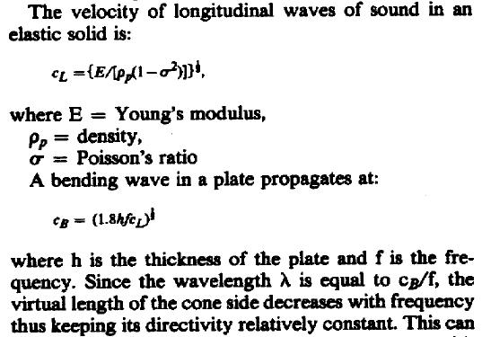

Luckythedog is correct
The complicated truth is that within a solid elastic body there are as many pressure wave velocities as there are deformation modes.
To add to the complexity, when one or more dimension of the body become smaller than the disturbance's wavelength, many things change from the bulk material case (mode interaction and mode conversion), resulting in lowering of on-axis propagation velocity and other phenomena, the severity of which depends on the elastic properties of the body.
For a speaker’s cone case, see the attachment from the great Daniel Queen (US patent No:4134471)

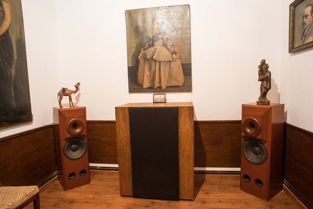

Christophe, two reasons. One to slightly correct for the time alignment between the two devices and the second one was purely cosmetic. The off axis response, and that is not really that much angle is not changing at that angle, you wouldn't notice they are tilted back. I could say something unreal like it was to change the floor bounce but then I would be lying!
Funny, I use to close my two enclosures more than necessary to be in the axis of the listener. it helps to enlartge the optimum position. So, I'm too a little off axis too, and I find-it better for the Horns 🙂.
