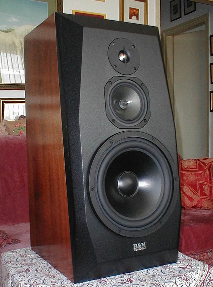

In my case, the bass drivers's net diameter is actually about 220 mm, and the midrange's about 85-90 mm. Of course, this also depends and where you measure it from, because if I measured the bass driver's metal edges, it wouldn't be 256 mm (10"), but more like 280 mm. 220 mm from suspenstion inner edge to the other inner edge. Don't be surprised by that, Celestion also had a model they actually sold as with an 11" bass dirver (outer edge to outer edge).
My XO uses 18 dB/oct cut off points, only the midrange driver starts with a 12 dB/oct slope, but finishes wih 18 dB/oct. This was the last addition to the speakers befoew we called it a day because this definitely sounded better than 3rd order.
At the time (2002), all three were what were thoought of as Son Audax' bes quality drivers. The mid especially was highly thought of and appeared in several very high end speakers at the time. Just by listening to it, and that's the crticial midrange, it's as clean and clear as any I have ever heard.

TWO25A16 - that's my tweeter. Not exactly cheap, deaker price was around US$160 at the time, but clean and clear is its middle name, and was really worth the asking price. Super light titanium. You have to work really hard to make it sound bad. Exceptionally well defined. which is why I wanted it.
Son Audax was the full name of the company, but it was often abbreviated to just Audax. Its' the same outfit. Harman shut them down in 2006. This made quite a few people very unhappy.
