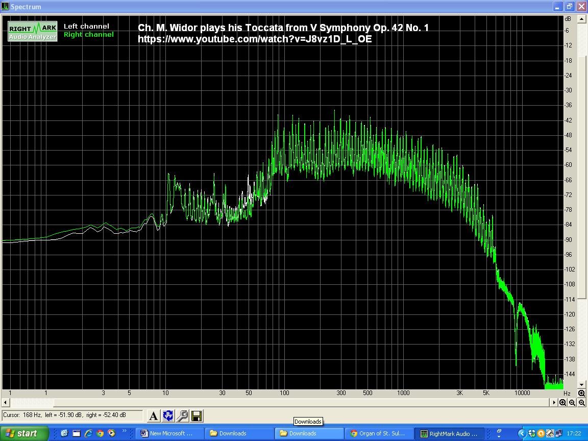

coming full circle on the infrasonics. A good Cathedral will have between 5 and 8 seconds echo. lots of infrasonics there. Unless you can go deep you will never reproduce the effect of being in a space that large. I have only heard it done well once and that was a carefully 'steered' demo by Dave Wilson using Watt/Puppy and WHOW with recordings from his mates at lucasfilm. The organ appeared some 40 ft behind the front wall of the room. Getting that effect of 5 sides of the listening room vanishing is very challenging in the average domestic setting, but is a fine goal for real hifi.

everyone else plays much faster than Vidor. Vidor understood how the accoustics worked. I have a direct to disk of Virgil Fox showing off and playing it at hyper speed. Amazing finger work, but not as the author intended.
And yes I walked down the isle to this piece. Its good enough for royalty, its good enough for me.

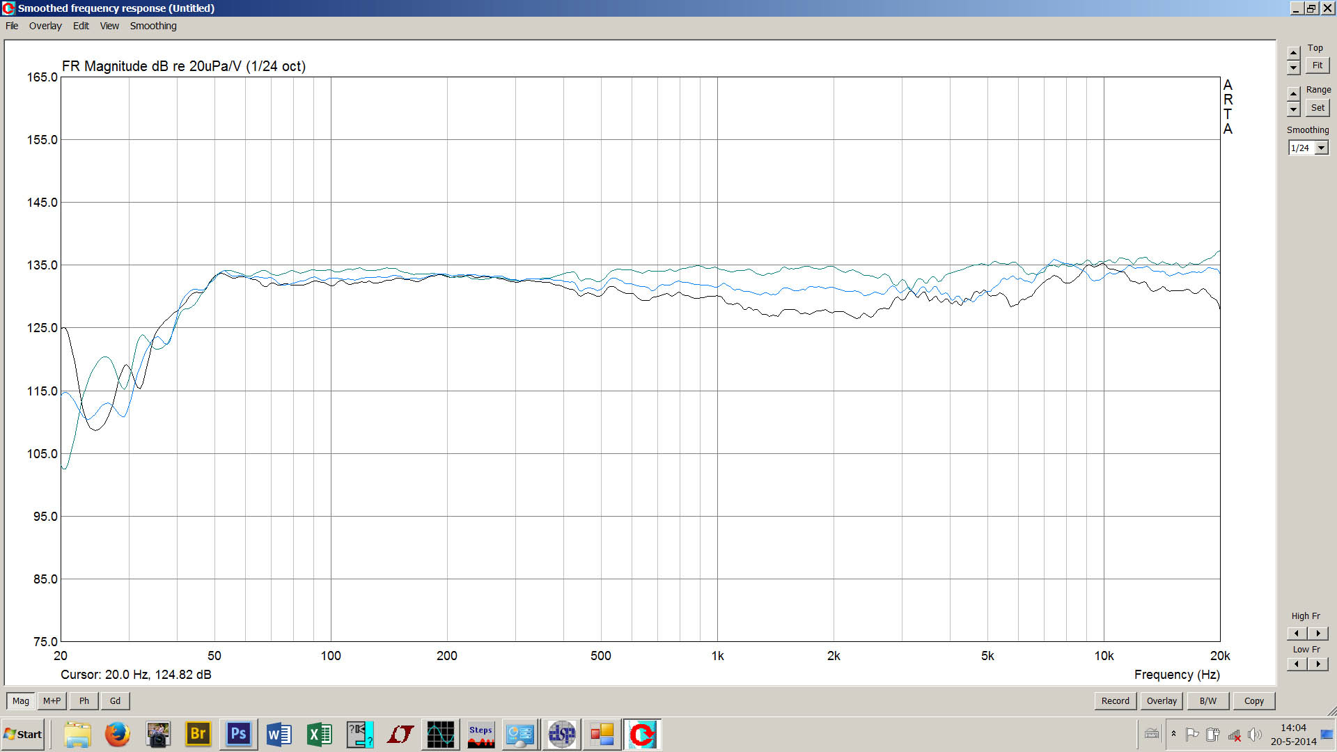

I must have failed to communicate that group delay is a nonsensical measure in the context of loudspeaker development.
Please think in terms of phase shift per octave (or, more precise, the slope angle of the phase plot, with frequency set out on a logarithmic scale).
This, of course, is separate from the question if it is worthwhile to limit this phase shift by fir filtering, which I don't think is supported by auditory research.
But, it is not all that bleak as you sketch when it comes to combfiltering etc. Below are anaechoic measurements of a loudspeaker with an MTM section, measured at 0, 15 and 30 degrees vertically. Having the right exterior shape and choosing xover frequencies and filter slopes carefully help a great deal to prevent problems of that nature.
That is one of the reasons why i prefer horns for the upper range. The only way i know to have the same radiating surface, so the directivity, equal between the two transducers at the crossing frequency.
The reason why i prefer (acoustic) high slope for filters, to minimize the frequency range where they play together.

With careful selection of device diameter and placement yes you can make an MTM design work, but I think many don't do that well.

Thanks for posting the link to Bach's Toccota and Fugue in Dm.
Funny, at my sisters wedding rehearsal, I asked the organist after
everyone was finished if she would play this for me on the Church
organ. The old church has a wonderful old pipe organ. I didn't recall
the name but just told her the thing from the movie of the guy
with the mask...Phantom of the Opera. She replied the Bach piece,
told me what is was and pulled out the sheet music.
We both had fun for about 10 mins playing the intro and other
select parts...until everyone else started complaining that we
were supposed to leave.
