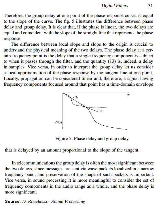

Here's a decent article about group delay, and its proper meaning, also setting out how it can be normal and natural to have negative values and what that physically means in context.
Time Machine, Anyone? - Andor Bariska

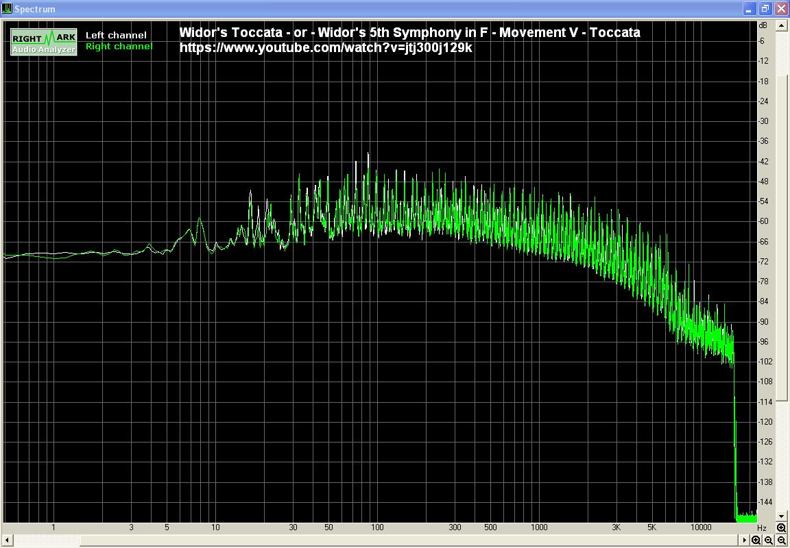

A nice showpiece for me on organ is the Toccata from Widor's 5th Symphony, https://www.youtube.com/watch?v=jtj300j129k, at full bore. Every molecule of air in the house should be throbbing and pulsating from the energy in this piece, and the frame of the house should feel like it's trembling from the bass note runs - an exultant experience when it all works.

On group delay: it's a red herring, but a complicated one, so if you have made the effort to understand what group delay is, it might be hard to disregard it as a useless measure.
Here is why. The auditory system is logarithmic, both in level and pitch. It is about the latter, pitch. Group delay goes wrong because it is a linear measure; it treats 1 delta Hz at 40 Hz the same as 1 delta 1 Hz at 4000 Hz. The consequence is that the GD figure gets very large at the low end, and very small at the high end, even if we talk about the same level of phase shift per octave.
And this is what the relevant measure should be, psyco-acoustically: the amount of phase shift per octave. Replace the delta Hz in the GD formula with delta log(Hz) and you might wind up with something more useful.

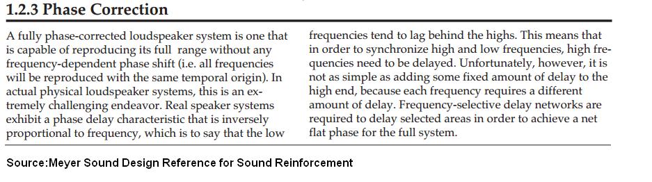

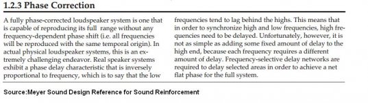

Dick, this might be on the right track MAYBE you can construct an FIR allpass with adjustable group delay.
It seems all-pass filters have their own problems
http://www.conforg.fr/acoustics2008/cdrom/data/fa2002-sevilla/forumacusticum/archivos/psy03001.pdf
https://www.pa.msu.edu/acoustics/allpass.pdf
http://www.cs.ust.hk/mjg_lib/bibs/DPSu/DPSu.Files/Ga95.PDFGardner, W. G. (1994
Bill Gardner's projects page
Scott, see the freq spectrum.Never feel the need to go there, to each his own.
My AKG K240 can’t do it.😀
