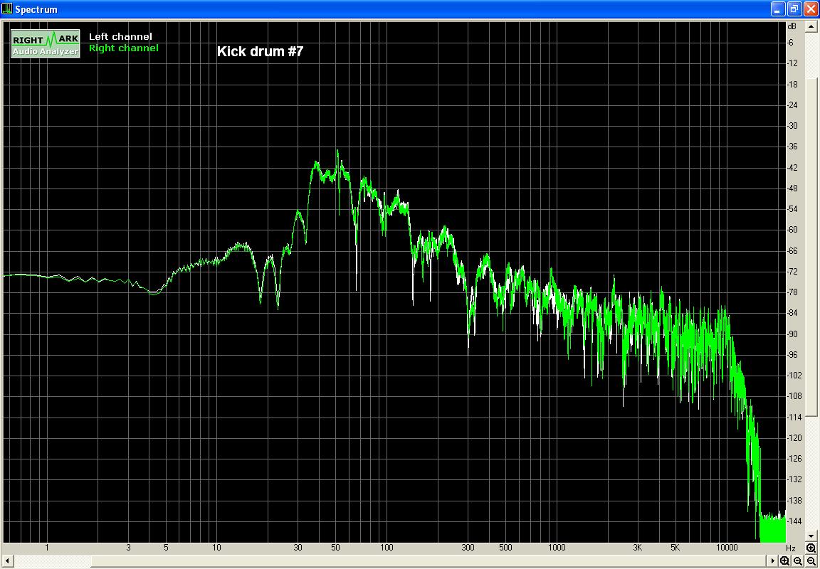

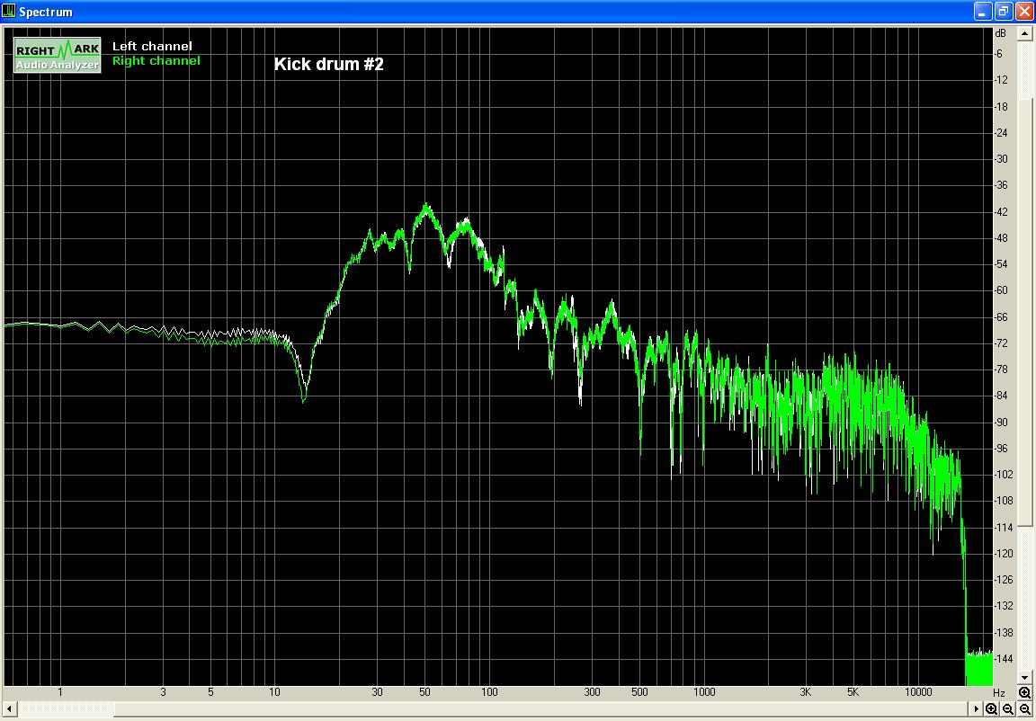

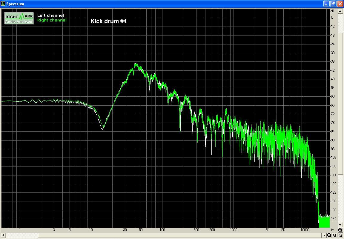

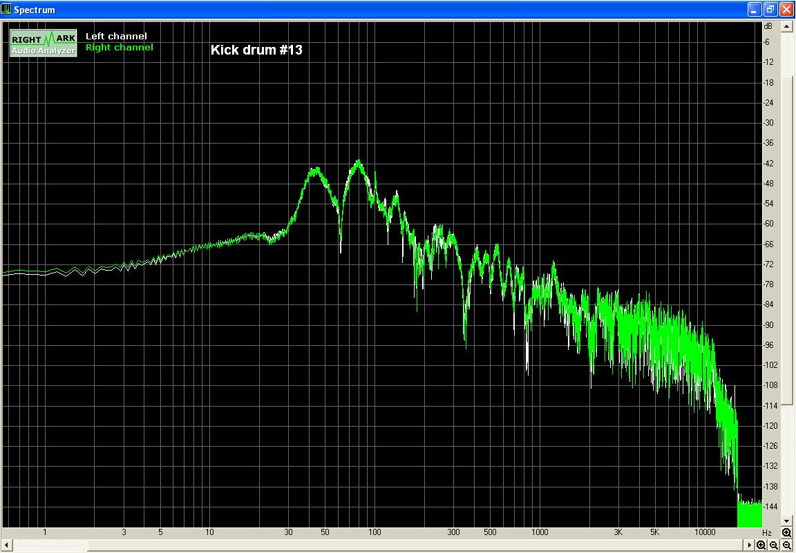

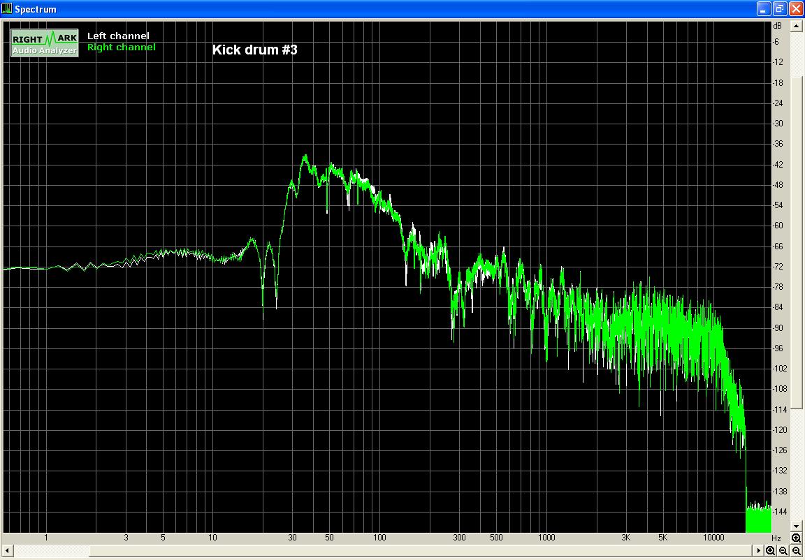

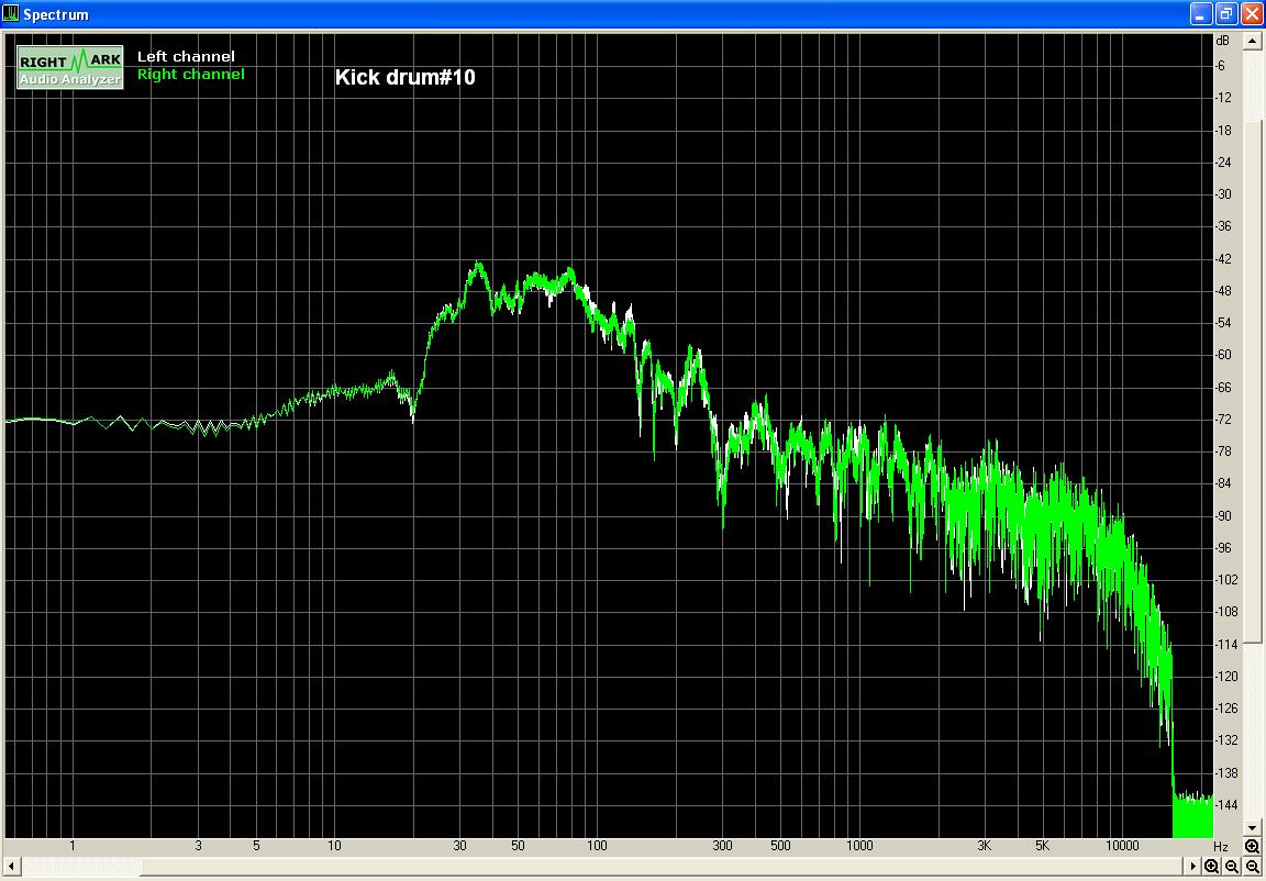

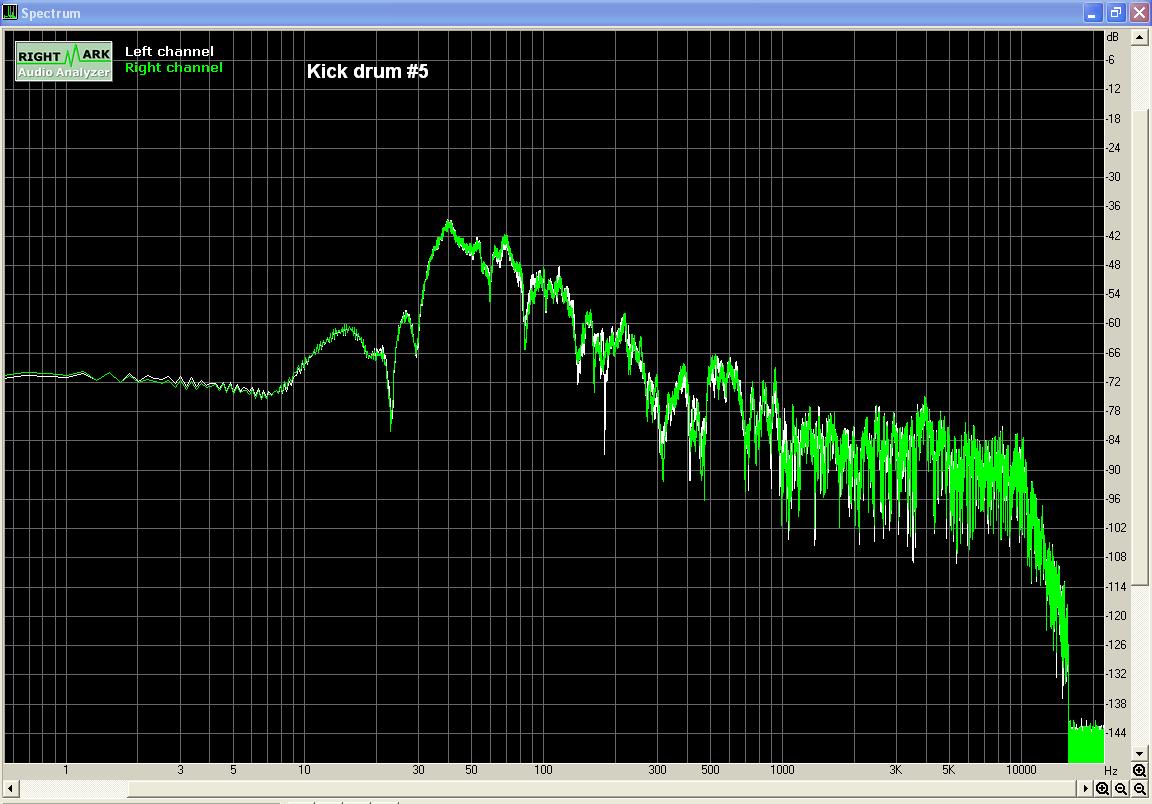

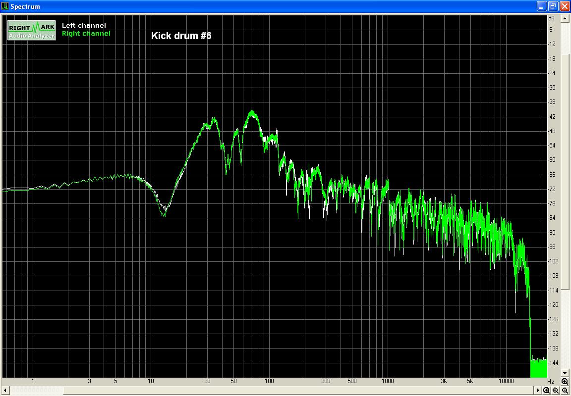

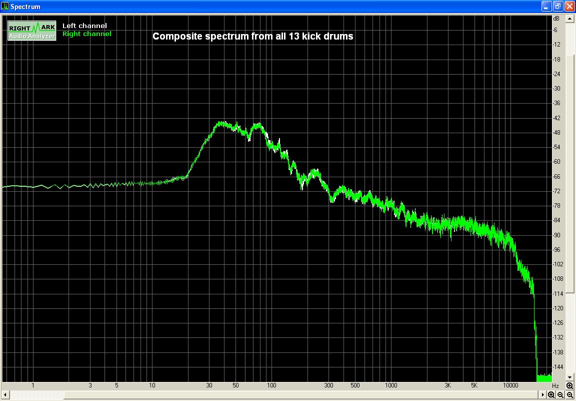

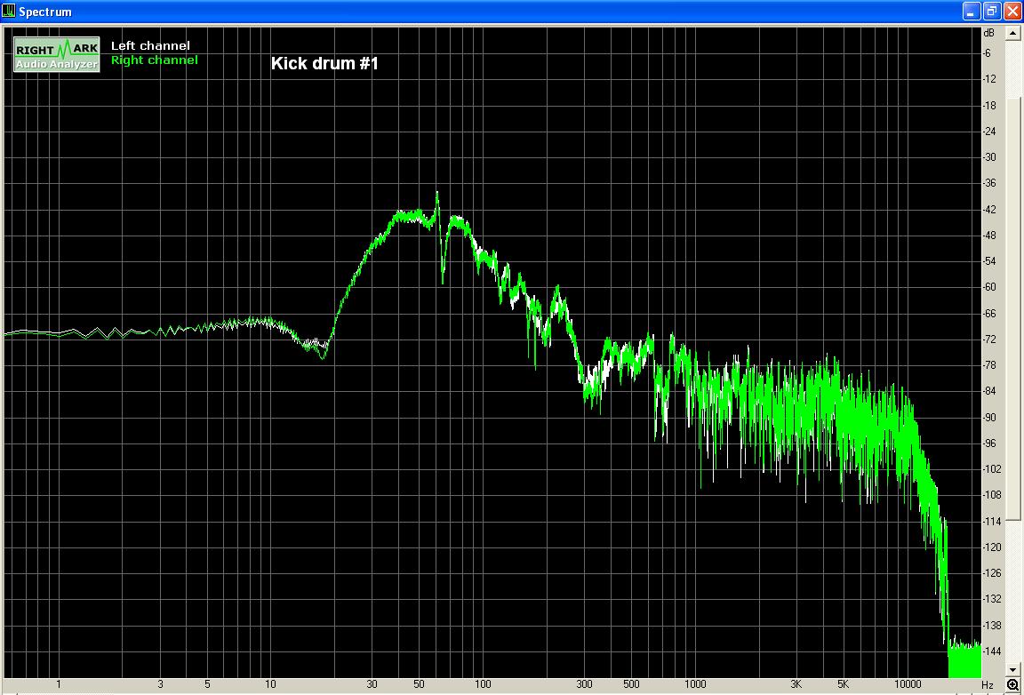

Here is an unprocessed sound comparison of thirteen kick drum installations.
https://www.youtube.com/watch?v=8ShNeBeDmLc
I attach the freq spectrum of each kick drum from the single note comparison section.
I see presence of fundamental at 30Hz and above.
My ears tell me that more punch and ‘kick’ is not associated with more weight at the low end.
You may rip the sound of the videoclip and apply progressively LP filtering to study the effect.

George,
Just taking a cursory look at those drum postings looks like the peak output is in the 50-60hz range, the point where as I said earlier most early JBL and others would accentuate the bass in most of the earlier systems I am aware of. As long as you have that area covered most people are more than happy with the bass without complaining that there is no 20-30hz output, most people really don't listen to organ pipes on a regular basis and even then how often do you use the lowest key on the organ keyboard? Most sub-woofers to me add muddy peaked limited bandwidth noise as far as I am concerned very rarely adding anything to music that we listen to. Most of the time I think of the guys with those horrid bass speakers in their cars making nothing but noise, same with the majority of so called sub-woofers.

George,
Yes. Most of the power is btn 50Hz and 100Hz. I suggest listening to each kick drum (each has four beats on the row) and look at the respective spectrum.
I agree. It is very difficult to seamlessly integrate a sub with main speakers which have descent bass extension.
Only with bass string instruments and with opera, I find that a sub adds something important in music reproduction ( may be with movies too but I don’t watch movies at home).

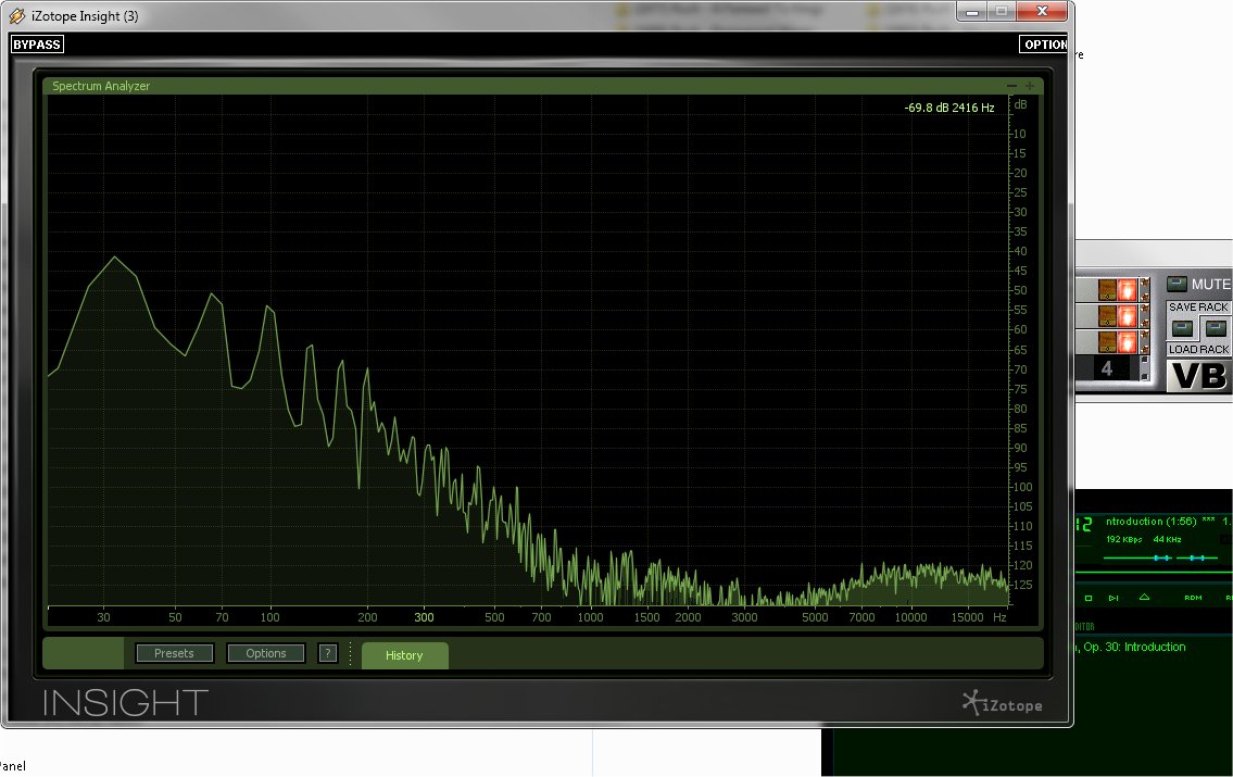

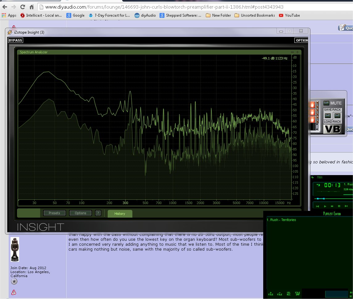

Bigger kicks and other LF.
Those must be little drums at 60hz.
Neil peart has manly kicks - all 42-45hz (below 1 - power windows/ territories ).
Fundamental comes from the sub , reverberations go the the stereo pair to fool
my brain on which kick is struck. Phase sets the relative distance.
Also sprach Zarathustra is 33hz (below 2).
There seems to be a lot of <40hz content in my collection. Shut down the
sub (<70hz) , definitely a lot missing. 45hz tuned stereo pair won't seem to
do justice to (some sources).
Old classic (who) .... not much <60hz.
OS

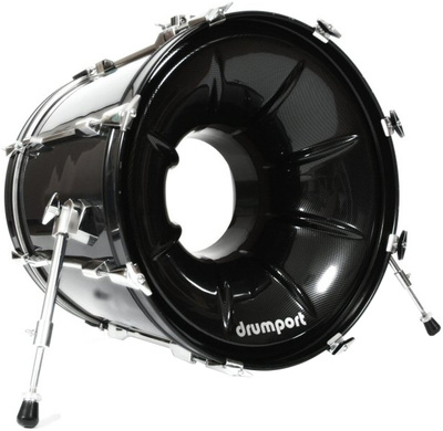

Now how much difference if any is there between a kick drum with both drum skins completely closed and those who either leave off the front skin or cut a large hole in that skin, is it just level or does the tuned low frequency change? Guess I could call one of my drummer friends and ask that question.
Most of the time, it is to get this effect you hear on tom-toms. You know, this note that seems to decrease both in frequency and volume with time. But there is so many ways to tune a battery for various effects.
