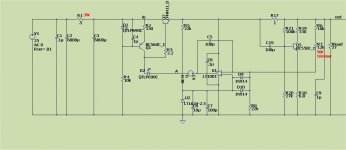

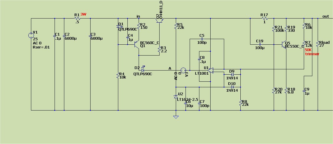

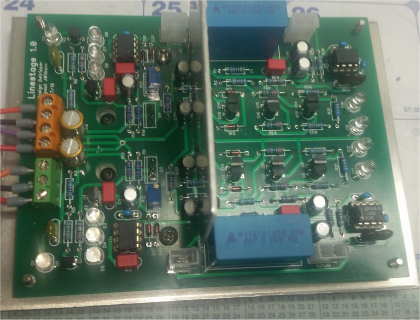

I can't believe we are denigrating simulators here ! I suppose the computer is
also as useless. :confused:
You can go from idea to simulation (below 1) , to CAD and product (below 2)
in weeks !
Nothing oscillated , all was spec to what the simulator predicted. Could not
measure any noise , perfect transient performance. Even the "hacked" Jung
regulators worked ( a bit more noise).
Audio was silent (noise). Nothing unexpected - followed the simulated
predictions exactly. DID NOT have to make more than one prototype ,
first try - close to perfect.
Same with the big power amps , never an oscillator. "Tweaks" can be
simulated and implemented.
DIY "heaven" - NO screwups !
OS

Just a fine point - BD139/140 do NOT have classes of gain in sequence as A, B or C, as the BC types do, so your marking should be BD 139, 139-15 and 139-25. Your point was to probably underline the highest gain class, which in your case would be BD 139/140 -25.
To the best of my knowledge , BDxxx/BCxxx/KSA-C Cordell models all
represent "middle gain classes" 200-300Hfe.
With a known pair , like the well known 3503/1381 , D and E are the
most common sourcing. Knowing what the real world parts will be , one
can "cripple" the simulation to reflect.
PS - even with the above mismatch , my simulated 30ppm power amp
just tested at 50ppm. Some will have more THD (real world) , some less.
The "C" designation means a Cordell model , BTW.
OS

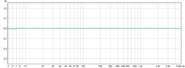

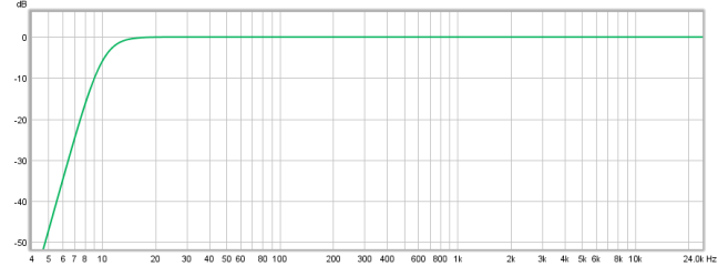

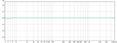

And how can we make this low group delay filter, Richard? I don't know how, but maybe somebody here has an answer.
Simple answer: A perfect high pass filter.
A 1st week DSP101 class pop quiz question:
What filter has a frequency response looking like this?
With a group delay response like this?
I'm happy with my DSP results. Applied to my loudspeakers GD make me even happier. Ability to match stereo speakers phase responses to within 2 degrees across entire bandwidth leads to much better imaging.
